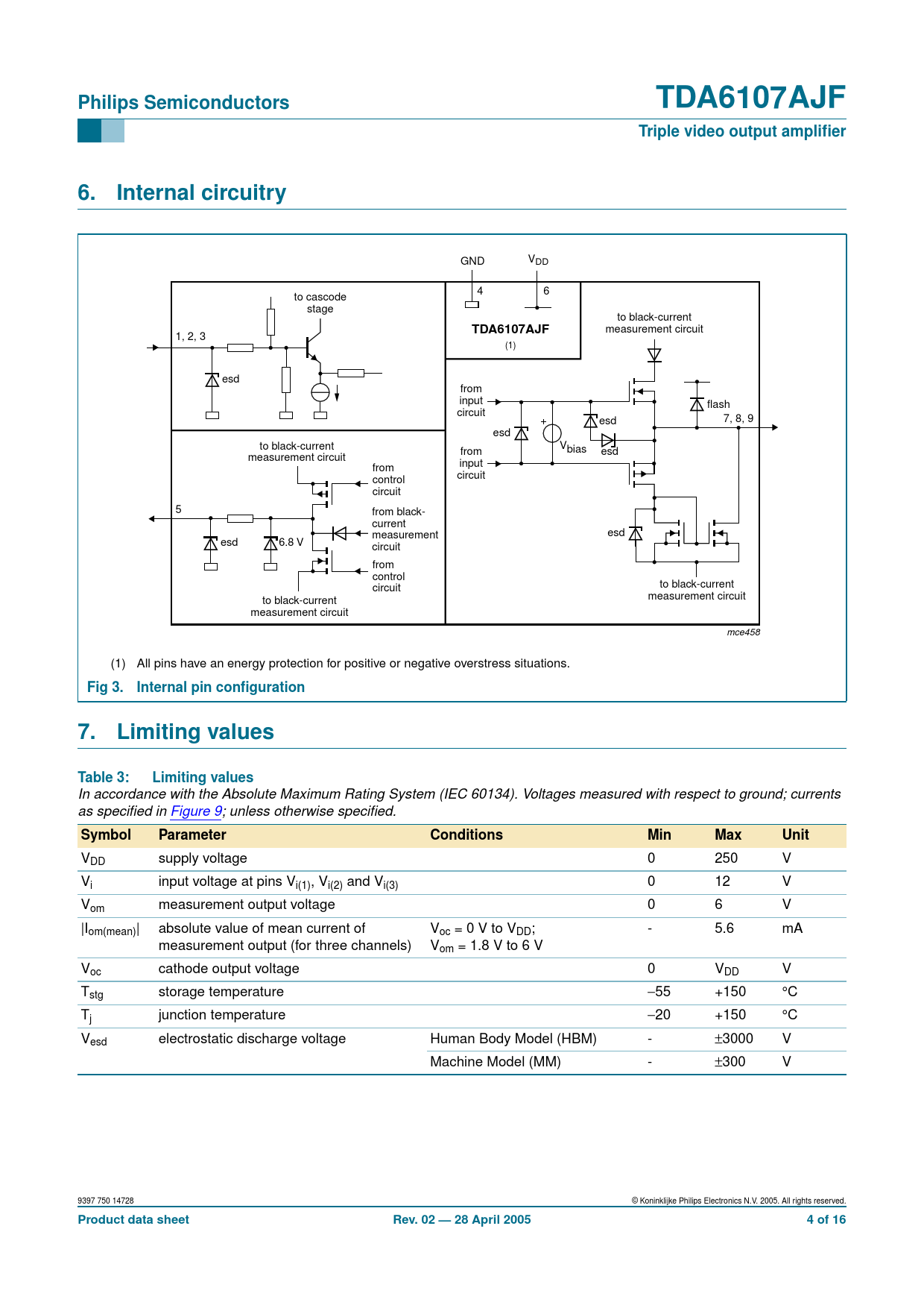

Philips Semiconductors. TDA6107AJF. Triple video output amplifier. Internal circuitry. Fig 3. Internal pin configuration
link to page 11
Philips Semiconductors TDA6107AJF Triple video output amplifier 6. Internal circuitry
GND VDD 4 6 to cascode stage to black-current
TDA6107AJF
measurement circuit 1, 2, 3 (1) esd from input flash circuit esd 7, 8, 9 esd to black-current V from bias esd measurement circuit input from circuit control circuit 5 from black- current esd measurement esd 6.8 V circuit from control circuit to black-current measurement circuit to black-current measurement circuit mce458 (1) All pins have an energy protection for positive or negative overstress situations.
Fig 3. Internal pin configuration 7. Limiting values Table 3: Limiting values
In accordance with the Absolute Maximum Rating System (IEC 60134). Voltages measured with respect to ground; currents as specified in Figure 9; unless otherwise specified.
Symbol Parameter Conditions Min Max Unit
VDD supply voltage 0 250 V Vi input voltage at pins Vi(1), Vi(2) and Vi(3) 0 12 V Vom measurement output voltage 0 6 V |Iom(mean)| absolute value of mean current of Voc = 0 V to VDD; - 5.6 mA measurement output (for three channels) Vom = 1.8 V to 6 V Voc cathode output voltage 0 VDD V Tstg storage temperature −55 +150 °C Tj junction temperature −20 +150 °C Vesd electrostatic discharge voltage Human Body Model (HBM) - ±3000 V Machine Model (MM) - ±300 V 9397 750 14728 © Koninklijke Philips Electronics N.V. 2005. All rights reserved.
Product data sheet Rev. 02 — 28 April 2005 4 of 16
