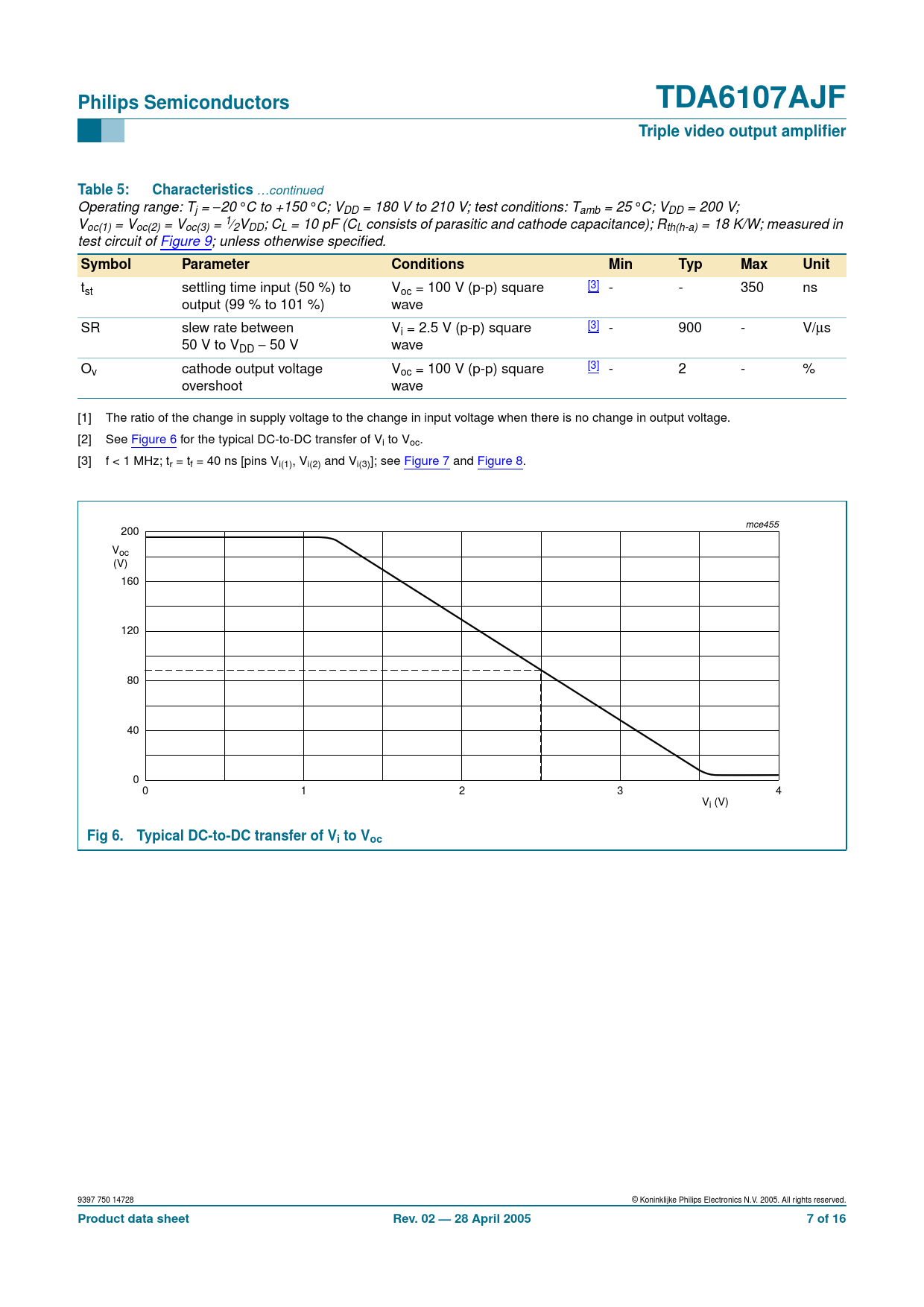

Philips Semiconductors. TDA6107AJF. Triple video output amplifier. Table 5:. Characteristics. Symbol. Parameter. Conditions. Min. Typ. Max
link to page 7 link to page 8 link to page 9 link to page 7 link to page 7 link to page 7
Philips Semiconductors TDA6107AJF Triple video output amplifier Table 5: Characteristics
…continued Operating range: Tj = −20 °C to +150 °C; VDD = 180 V to 210 V; test conditions: Tamb = 25 °C; VDD = 200 V; Voc(1) = Voc(2) = Voc(3) = 1⁄2VDD; CL = 10 pF (CL consists of parasitic and cathode capacitance); Rth(h-a) = 18 K/W; measured in test circuit of Figure 9; unless otherwise specified.
Symbol Parameter Conditions Min Typ Max Unit
t [3] st settling time input (50 %) to Voc = 100 V (p-p) square - - 350 ns output (99 % to 101 %) wave SR slew rate between V [3] i = 2.5 V (p-p) square - 900 - V/µs 50 V to V − DD 50 V wave O [3] v cathode output voltage Voc = 100 V (p-p) square - 2 - % overshoot wave [1] The ratio of the change in supply voltage to the change in input voltage when there is no change in output voltage. [2] See Figure 6 for the typical DC-to-DC transfer of Vi to Voc. [3] f < 1 MHz; tr = tf = 40 ns [pins Vi(1), Vi(2) and Vi(3)]; see Figure 7 and Figure 8. mce455 200 Voc (V) 160 120 80 40 0 0 1 2 3 4 Vi (V)
Fig 6. Typical DC-to-DC transfer of Vi to Voc
