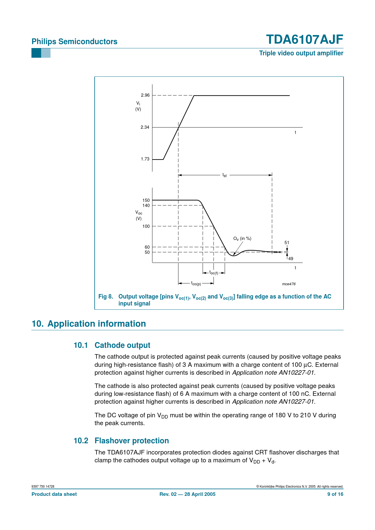

2.96 Vi (V) 2.34 t 1.73 tst 150 140 Voc (V) 100 Ov (in %) 51 60 50 49 t toc(f) tco(p) mce476
Fig 8. Output voltage [pins Voc(1), Voc(2) and Voc(3)] falling edge as a function of the AC input signal 10. Application information 10.1 Cathode output
The cathode output is protected against peak currents (caused by positive voltage peaks during high-resistance flash) of 3 A maximum with a charge content of 100 µC. External protection against higher currents is described in Application note AN10227-01. The cathode is also protected against peak currents (caused by positive voltage peaks during low-resistance flash) of 6 A maximum with a charge content of 100 nC. External protection against higher currents is described in Application note AN10227-01. The DC voltage of pin VDD must be within the operating range of 180 V to 210 V during the peak currents.
10.2 Flashover protection
The TDA6107AJF incorporates protection diodes against CRT flashover discharges that clamp the cathodes output voltage up to a maximum of VDD + Vd. 9397 750 14728 © Koninklijke Philips Electronics N.V. 2005. All rights reserved.
