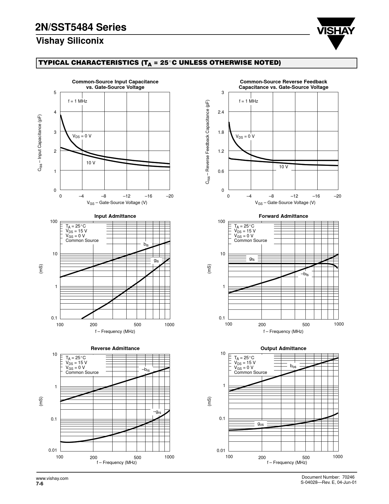

2N/SST5484 Series. Vishay Siliconix. Common-Source Input Capacitance. Common-Source Reverse Feedback. vs. Gate-Source Voltage
2N/SST5484 Series Vishay Siliconix
TYPICAL CHARACTERISTICS (TA = 25_C UNLESS OTHERWISE NOTED)
Common-Source Input Capacitance Common-Source Reverse Feedback vs. Gate-Source Voltage Capacitance vs. Gate-Source Voltage
5 3 f = 1 MHz f = 1 MHz 4 2.4 3 1.8 VDS = 0 V VDS = 0 V 2 1.2 Input Capacitance (pF) – 10 V s is 10 V C 1 Reverse Feedback Capacitance (pF) 0.6 – rssC 0 0 0 –4 –8 –12 –16 –20 0 –4 –8 –12 –16 –20 VGS – Gate-Source Voltage (V) VGS – Gate-Source Voltage (V)
Input Admittance Forward Admittance
100 100 TA = 25_C TA = 25_C VDS = 15 V VDS = 15 V VGS = 0 V VGS = 0 V Common Source Common Source bis 10 10 g gfs is (mS) (mS) –bfs 1 1 0.1 0.1 100 200 500 1000 100 200 500 1000 f – Frequency (MHz) f – Frequency (MHz)
Reverse Admittance Output Admittance
10 10 TA = 25_C TA = 25_C VDS = 15 V VDS = 15 V V bos GS = 0 V –b VGS = 0 V Common Source rs Common Source 1 1 (mS) (mS) –grs 0.1 0.1 gos 0.01 0.01 100 200 500 1000 100 1000 200 500 f – Frequency (MHz) f – Frequency (MHz) www.vishay.com Document Number: 70246
