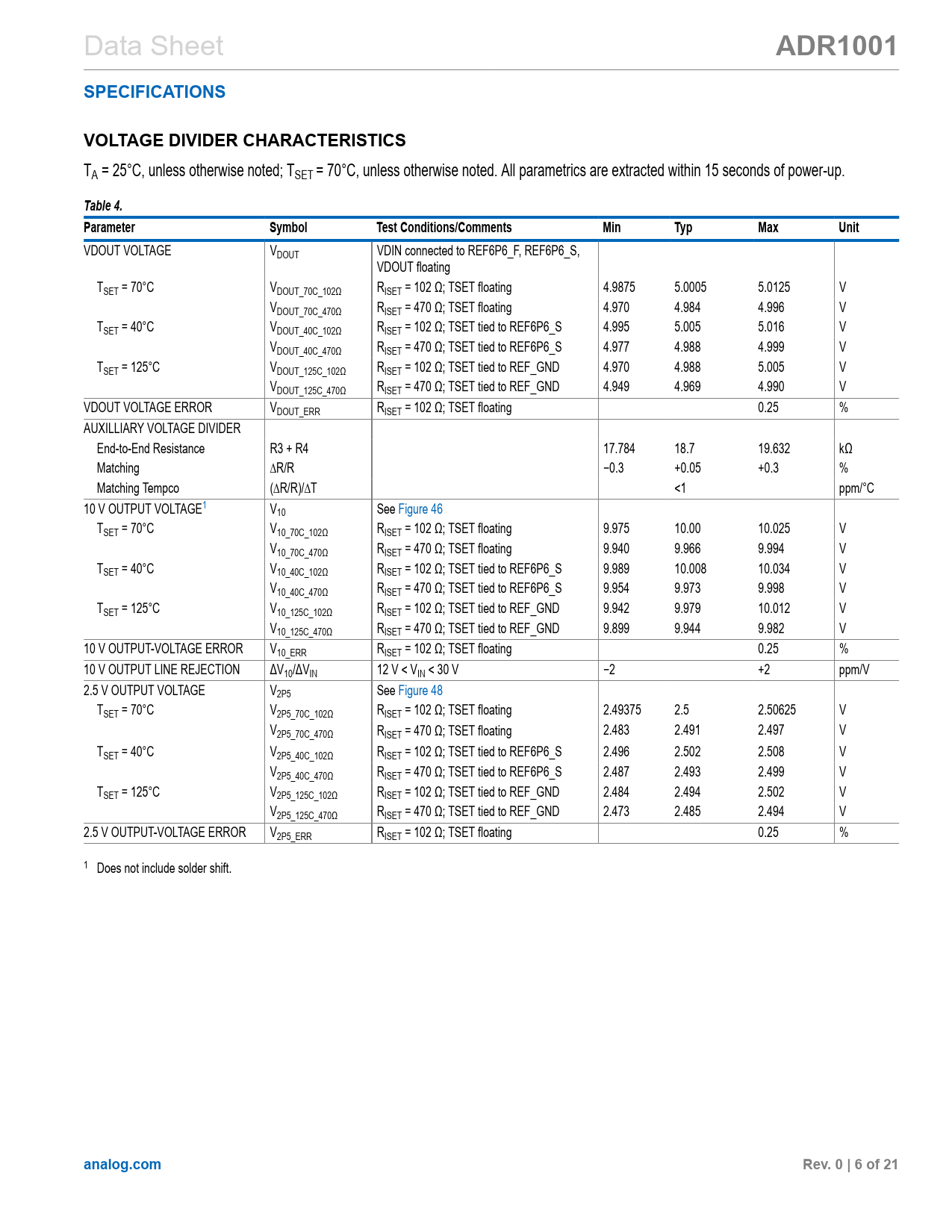

ADR1001. SPECIFICATIONS. VOLTAGE DIVIDER CHARACTERISTICS. Table 4. Parameter. Symbol. Test Conditions/Comments. Min. Typ. Max. Unit
link to page 6 link to page 20 link to page 20 Data Sheet
ADR1001 SPECIFICATIONS VOLTAGE DIVIDER CHARACTERISTICS
TA = 25°C, unless otherwise noted; TSET = 70°C, unless otherwise noted. All parametrics are extracted within 15 seconds of power-up.
Table 4. Parameter Symbol Test Conditions/Comments Min Typ Max Unit
VDOUT VOLTAGE VDOUT VDIN connected to REF6P6_F, REF6P6_S, VDOUT floating TSET = 70°C VDOUT_70C_102Ω RISET = 102 Ω; TSET floating 4.9875 5.0005 5.0125 V VDOUT_70C_470Ω RISET = 470 Ω; TSET floating 4.970 4.984 4.996 V TSET = 40°C VDOUT_40C_102Ω RISET = 102 Ω; TSET tied to REF6P6_S 4.995 5.005 5.016 V VDOUT_40C_470Ω RISET = 470 Ω; TSET tied to REF6P6_S 4.977 4.988 4.999 V TSET = 125°C VDOUT_125C_102Ω RISET = 102 Ω; TSET tied to REF_GND 4.970 4.988 5.005 V VDOUT_125C_470Ω RISET = 470 Ω; TSET tied to REF_GND 4.949 4.969 4.990 V VDOUT VOLTAGE ERROR VDOUT_ERR RISET = 102 Ω; TSET floating 0.25 % AUXILLIARY VOLTAGE DIVIDER End-to-End Resistance R3 + R4 17.784 18.7 19.632 kΩ Matching ∆R/R −0.3 +0.05 +0.3 % Matching Tempco (∆R/R)/∆T <1 ppm/°C 10 V OUTPUT VOLTAGE1 V10 See Figure 46 TSET = 70°C V10_70C_102Ω RISET = 102 Ω; TSET floating 9.975 10.00 10.025 V V10_70C_470Ω RISET = 470 Ω; TSET floating 9.940 9.966 9.994 V TSET = 40°C V10_40C_102Ω RISET = 102 Ω; TSET tied to REF6P6_S 9.989 10.008 10.034 V V10_40C_470Ω RISET = 470 Ω; TSET tied to REF6P6_S 9.954 9.973 9.998 V TSET = 125°C V10_125C_102Ω RISET = 102 Ω; TSET tied to REF_GND 9.942 9.979 10.012 V V10_125C_470Ω RISET = 470 Ω; TSET tied to REF_GND 9.899 9.944 9.982 V 10 V OUTPUT-VOLTAGE ERROR V10_ERR RISET = 102 Ω; TSET floating 0.25 % 10 V OUTPUT LINE REJECTION ΔV10/ΔVIN 12 V < VIN < 30 V −2 +2 ppm/V 2.5 V OUTPUT VOLTAGE V2P5 See Figure 48 TSET = 70°C V2P5_70C_102Ω RISET = 102 Ω; TSET floating 2.49375 2.5 2.50625 V V2P5_70C_470Ω RISET = 470 Ω; TSET floating 2.483 2.491 2.497 V TSET = 40°C V2P5_40C_102Ω RISET = 102 Ω; TSET tied to REF6P6_S 2.496 2.502 2.508 V V2P5_40C_470Ω RISET = 470 Ω; TSET tied to REF6P6_S 2.487 2.493 2.499 V TSET = 125°C V2P5_125C_102Ω RISET = 102 Ω; TSET tied to REF_GND 2.484 2.494 2.502 V V2P5_125C_470Ω RISET = 470 Ω; TSET tied to REF_GND 2.473 2.485 2.494 V 2.5 V OUTPUT-VOLTAGE ERROR V2P5_ERR RISET = 102 Ω; TSET floating 0.25 % 1 Does not include solder shift.
