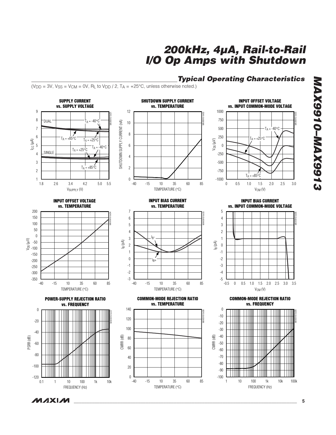

| Description | 200kHz, 4µA, Rail-to-Rail I/O Op Amps with Shutdown |
| Pages / Page | 17 / 5 — 200kHz, 4µA, Rail-to-Rail. I/O Op Amps with Shutdown. MAX9910–MAX9913. … |
| File Format / Size | PDF / 515 Kb |
200kHz, 4µA, Rail-to-Rail. I/O Op Amps with Shutdown. MAX9910–MAX9913. Typical Operating Characteristics. SUPPLY CURRENT
200kHz, 4µA, Rail-to-Rail I/O Op Amps with Shutdown MAX9910–MAX9913 Typical Operating Characteristics
(VDD = 3V, VSS = VCM = 0V, RL to VDD / 2, TA = +25°C, unless otherwise noted.)
SUPPLY CURRENT SHUTDOWN SUPPLY CURRENT INPUT OFFSET VOLTAGE vs. SUPPLY VOLTAGE vs. TEMPERATURE vs. INPUT COMMON-MODE VOLTAGE
9 12 1000 8 DUAL T 750 A = -40°C 10 MAX9910 toc01 MAX9910 toc02 MAX9910 toc03 7 500 TA = -40°C 8 6 T 250 A = +85°C T TA = +25°C µA) A = +25°C µV) ( 5 6 ( 0 I CC TA = -40°C TA = +25°C V OS 4 SINGLE -250 4 3 -500 TA = +85°C SHUTDOWN SUPPLY CURRENT (nA) 2 2 -750 TA = +85°C 1 0 -1000 1.8 2.6 3.4 4.2 5.0 5.5 -40 -15 10 35 60 85 0 0.5 1.0 1.5 2.0 2.5 3.0 VSUPPLY (V) TEMPERATURE (°C) VCM (V)
INPUT OFFSET VOLTAGE INPUT BIAS CURRENT INPUT BIAS CURRENT vs. TEMPERATURE vs. TEMPERATURE vs. INPUT COMMON-MODE VOLTAGE
200 7 5 150 6 4 100 MAX9910 toc04 MAX9910 toc05 5 MAX9910 toc06 3 50 4 2 0 3 IB- 1 µV) ( -50 (pA) 2 (pA) 0 V OS -100 I B I B 1 -1 -150 0 -2 -200 IB+ -250 -1 -3 -300 -2 -4 -350 -3 -5 -40 -15 10 35 60 85 -40 -15 10 35 60 85 -0.5 0 0.5 1.0 1.5 2.0 2.5 3.0 3.5 TEMPERATURE (°C) TEMPERATURE (°C) VCM (V)
POWER-SUPPLY REJECTION RATIO COMMON-MODE REJECTION RATIO COMMON-MODE REJECTION RATIO vs. FREQUENCY vs. TEMPERATURE vs. FREQUENCY
0 140 0 -10 120 -20 MAX9910 toc07 MAX9910 toc08 MAX9910 toc09 -20 100 -30 -40 -40 80 -60 -50 PSRR (dB) CMRR (dB) 60 CMRR (dB) -60 -80 40 -70 -80 -100 20 -90 -120 0 -100 0.1 1 10 100 1k 10k -40 -15 10 35 60 85 1 10 100 1k 10k 100k FREQUENCY (Hz) TEMPERATURE (°C) FREQUENCY (Hz)
