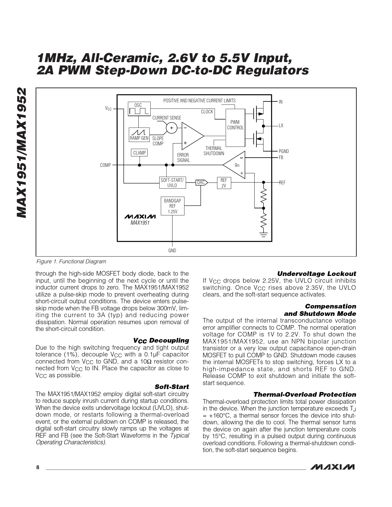

POSITIVE AND NEGATIVE CURRENT LIMITS IN OSC VCC CLOCK CURRENT SENSE PWM LX CONTROL RAMP GEN SLOPE COMP THERMAL PGND CLAMP ERROR SHUTDOWN FB SIGNAL COMP gm SOFT-START/ REF DAC REF UVLO 2V BANDGAP REF
MAX1951/MAX1952
1.25V MAX1951 GND Figure 1. Functional Diagram through the high-side MOSFET body diode, back to the
