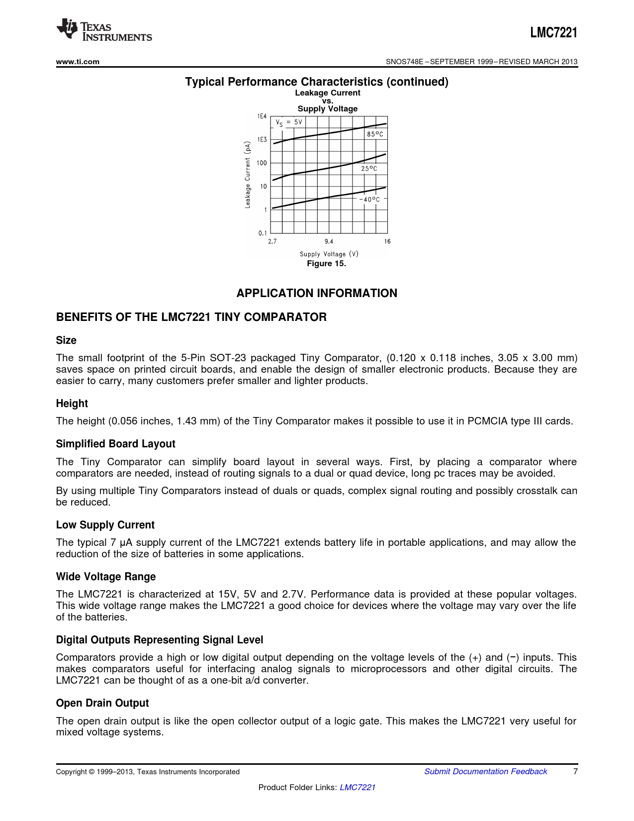

LMC7221. www.ti.com. Typical Performance Characteristics (continued). Leakage Current. vs. Supply Voltage. Figure 15
LMC7221 www.ti.com
SNOS748E – SEPTEMBER 1999 – REVISED MARCH 2013
Typical Performance Characteristics (continued) Leakage Current vs. Supply Voltage Figure 15. APPLICATION INFORMATION BENEFITS OF THE LMC7221 TINY COMPARATOR Size
The small footprint of the 5-Pin SOT-23 packaged Tiny Comparator, (0.120 x 0.118 inches, 3.05 x 3.00 mm) saves space on printed circuit boards, and enable the design of smaller electronic products. Because they are easier to carry, many customers prefer smaller and lighter products.
Height
The height (0.056 inches, 1.43 mm) of the Tiny Comparator makes it possible to use it in PCMCIA type III cards.
Simplified Board Layout
The Tiny Comparator can simplify board layout in several ways. First, by placing a comparator where comparators are needed, instead of routing signals to a dual or quad device, long pc traces may be avoided. By using multiple Tiny Comparators instead of duals or quads, complex signal routing and possibly crosstalk can be reduced.
Low Supply Current
The typical 7 μA supply current of the LMC7221 extends battery life in portable applications, and may allow the reduction of the size of batteries in some applications.
Wide Voltage Range
The LMC7221 is characterized at 15V, 5V and 2.7V. Performance data is provided at these popular voltages. This wide voltage range makes the LMC7221 a good choice for devices where the voltage may vary over the life of the batteries.
Digital Outputs Representing Signal Level
Comparators provide a high or low digital output depending on the voltage levels of the (+) and (−) inputs. This makes comparators useful for interfacing analog signals to microprocessors and other digital circuits. The LMC7221 can be thought of as a one-bit a/d converter.
Open Drain Output
The open drain output is like the open collector output of a logic gate. This makes the LMC7221 very useful for mixed voltage systems. Copyright © 1999–2013, Texas Instruments Incorporated Submit Documentation Feedback 7 Product Folder Links: LMC7221 Document Outline FEATURES Applications DESCRIPTION Connection Diagram Absolute Maximum Ratings Operating Ratings 2.7V Electrical Characteristics 5.0V and 15.0V Electrical Characteristics Leakage Characteristics AC Electrical Characteristics Typical Performance Characteristics Application Information BENEFITS OF THE LMC7221 TINY COMPARATOR Size Height Simplified Board Layout Low Supply Current Wide Voltage Range Digital Outputs Representing Signal Level Open Drain Output Driving LEDs (Light Emitting Diodes) Input range to Beyond Rail to Rail Zero Crossing Detector Low Input Currents and High Input Impedance Direct Sensor Interfacing LOW VOLTAGE OPERATION OPEN DRAIN OUTPUT Output Stage OUTPUT SHORT CIRCUIT CURRENT INPUT PROTECTION LAYOUT CONSIDERATIONS PUSH-PULL OUTPUTS, DUAL VERSIONS ADDITIONAL 5-Pin SOT-23 TINY DEVICES SPICE MACROMODEL Revision History
