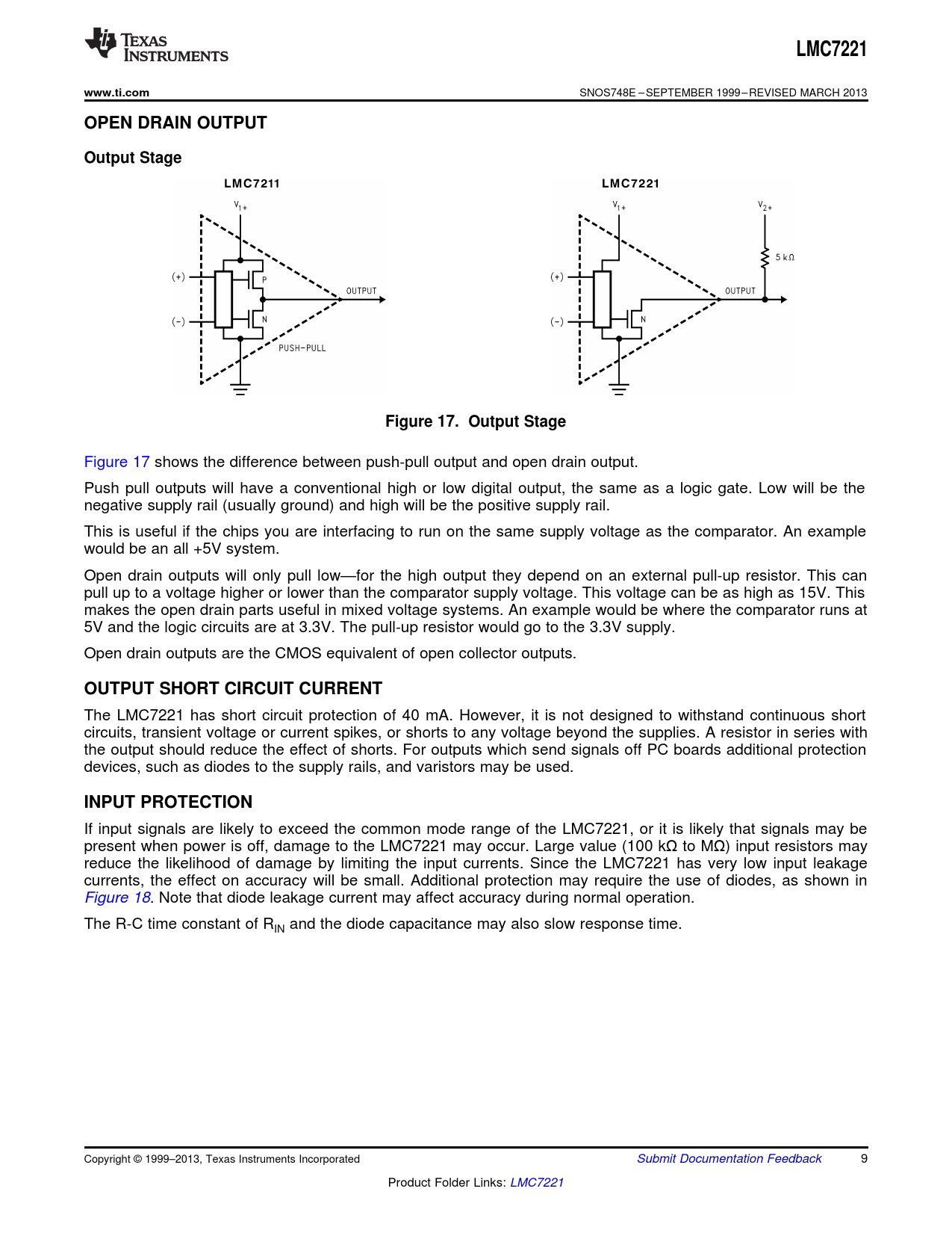

OPEN DRAIN OUTPUT Output Stage Figure 17. Output Stage
Figure 17 shows the difference between push-pull output and open drain output. Push pull outputs will have a conventional high or low digital output, the same as a logic gate. Low will be the negative supply rail (usually ground) and high will be the positive supply rail. This is useful if the chips you are interfacing to run on the same supply voltage as the comparator. An example would be an all +5V system. Open drain outputs will only pull low—for the high output they depend on an external pull-up resistor. This can pull up to a voltage higher or lower than the comparator supply voltage. This voltage can be as high as 15V. This makes the open drain parts useful in mixed voltage systems. An example would be where the comparator runs at 5V and the logic circuits are at 3.3V. The pull-up resistor would go to the 3.3V supply. Open drain outputs are the CMOS equivalent of open collector outputs.
