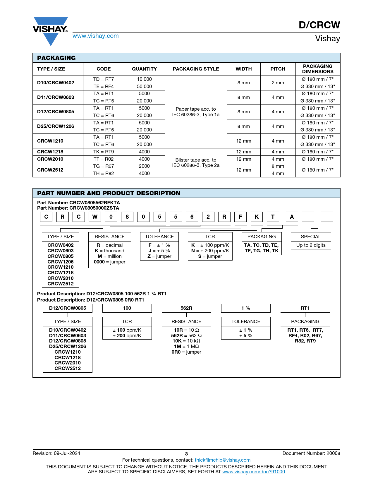

D/CRCW. PACKAGING. TYPE / SIZE. CODE. QUANTITY. PACKAGING STYLE. WIDTH. PITCH. DIMENSIONS. D10/CRCW0402. D11/CRCW0603. D12/CRCW0805
D/CRCW PACKAGING TYPE / SIZE CODE QUANTITY PACKAGING STYLE WIDTH PITCH DIMENSIONS D10/CRCW0402 D11/CRCW0603 D12/CRCW0805
D/CRCW
www.vishay.com Vishay
PACKAGING PACKAGING TYPE / SIZE CODE QUANTITY PACKAGING STYLE WIDTH PITCH DIMENSIONS
TD = RT7 10 000 Ø 180 mm / 7"
D10/CRCW0402
8 mm 2 mm TE = RF4 50 000 Ø 330 mm / 13" TA = RT1 5000 Ø 180 mm / 7"
D11/CRCW0603
8 mm 4 mm TC = RT6 20 000 Ø 330 mm / 13" TA = RT1 5000 Paper tape acc. to Ø 180 mm / 7"
D12/CRCW0805
8 mm 4 mm IEC 60286-3, Type 1a TC = RT6 20 000 Ø 330 mm / 13" TA = RT1 5000 Ø 180 mm / 7"
D25/CRCW1206
8 mm 4 mm TC = RT6 20 000 Ø 330 mm / 13" TA = RT1 5000 Ø 180 mm / 7"
CRCW1210
12 mm 4 mm TC = RT6 20 000 Ø 330 mm / 13"
CRCW1218
TK = RT9 4000 12 mm 4 mm Ø 180 mm / 7"
CRCW2010
TF = R02 4000 Blister tape acc. to 12 mm 4 mm Ø 180 mm / 7" TG = R67 2000 IEC 60286-3, Type 2a 8 mm
CRCW2512
12 mm Ø 180 mm / 7" TH = R82 4000 4 mm
PART NUMBER AND PRODUCT DESCRIPTION Part Number: CRCW0805562RFKTA Part Number: CRCW08050000ZSTA C R C W 0 8 0 5 5 6 2 R F K T A
TYPE / SIZE RESISTANCE TOLERANCE TCR PACKAGING SPECIAL
CRCW0402 R
= decimal
F
= ± 1 %
K
= ± 100 ppm/K
TA, TC, TD, TE,
Up to 2 digits
CRCW0603 K
= thousand
J
= ± 5 %
N
= ± 200 ppm/K
TF, TG, TH, TK CRCW0805 M
= million
Z
= jumper
S
= jumper
CRCW1206 0000
= jumper
CRCW1210 CRCW1218 CRCW2010 CRCW2512 Product Description: D12/CRCW0805 100 562R 1 % RT1 Product Description: D12/CRCW0805 0R0 RT1 D12/CRCW0805 100 562R 1 % RT1
TYPE / SIZE TCR RESISTANCE TOLERANCE PACKAGING
D10/CRCW0402
100
ppm/K
10R
= 10 Ω ±
1 % RT1, RT6, RT7, D11/CRCW0603
200
ppm/K
562R
= 562 Ω ±
5 % RF4, R02, R67, D12/CRCW0805 10K
= 10 kΩ
R82, RT9 D25/CRCW1206 1M
= 1 MΩ
CRCW1210 0R0
= jumper
