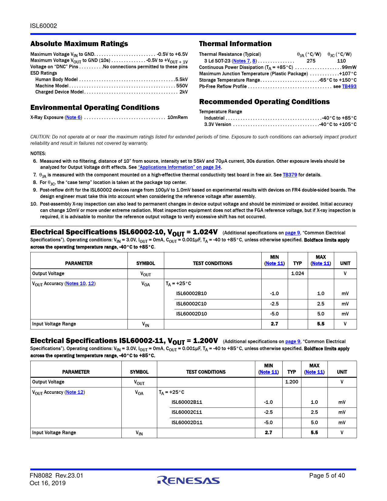

DescriptionPrecision Low Power FGA Voltage References
Pages / Page40 / 5 — link. to. page. 5. link. to. page. 5. link. to. page. 5. link. to. page. …
File Format / SizePDF / 2.5 Mb
link. to. page. 5. link. to. page. 5. link. to. page. 5. link. to. page. 34. link. to. page. 9. link. to. page. 5. link. to. page. 9. link. to. page. 9. link. to. page. 9. link. to. page. 9. link. to
link to page 5 link to page 5 link to page 5 link to page 34 link to page 9 link to page 5 link to page 9 link to page 9 link to page 9 link to page 9 link to
link to page 5 link to page 5 link to page 5 link to page 34 link to page 9 link to page 5 link to page 9 link to page 9 link to page 9 link to page 9 link to page 9 link to page 9 link to page 9 ISL60002 Absolute Maximum Ratings Thermal Information Maximum Voltage VIN to GND. -0.5V to +6.5V Thermal Resistance (Typical) θJA (°C/W) θJC (°C/W) Maximum Voltage VOUT to GND (10s) . -0.5V to +VOUT + 1V 3 Ld SOT-23 (Notes 7, 8) . 275 110 Voltage on “DNC” Pins . .No connections permitted to these pins Continuous Power Dissipation (TA = +85°C) . .99mW ESD Ratings Maximum Junction Temperature (Plastic Package) . .+107°C Human Body Model . .5.5kV Storage Temperature Range. .-65°C to +150°C Machine Model . 550V Pb-Free Reflow Profile . see TB493 Charged Device Model . 2kV Recommended Operating Conditions Environmental Operating Conditions Temperature Range X-Ray Exposure (Note 6) . 10mRem Industrial . -40°C to +85°C 3.3V Version . .-40°C to +105°C CAUTION: Do not operate at or near the maximum ratings listed for extended periods of time. Exposure to such conditions can adversely impact product reliability and result in failures not covered by warranty. NOTES: 6. Measured with no filtering, distance of 10” from source, intensity set to 55kV and 70µA current, 30s duration. Other exposure levels should be analyzed for Output Voltage drift effects. See “Applications Information” on page 34. 7. θJA is measured with the component mounted on a high-effective thermal conductivity test board in free air. See TB379 for details. 8. For θJC, the “case temp” location is taken at the package top center. 9. Post-reflow drift for the ISL60002 devices range from 100µV to 1.0mV based on experimental results with devices on FR4 double-sided boards. The design engineer must take this into account when considering the reference voltage after assembly. 10. Post-assembly X-ray inspection can also lead to permanent changes in device output voltage and should be minimized or avoided. Initial accuracy can change 10mV or more under extreme radiation. Most inspection equipment does not affect the FGA reference voltage, but if X-ray inspection is required, it is advisable to monitor the reference output voltage to verify excessive shift has not occurred. Electrical Specifications ISL60002-10, VOUT = 1.024V (Additional specifications on page 9, “Common Electrical Specifications”). Operating conditions: VIN = 3.0V, IOUT = 0mA, COUT = 0.001µF, TA = -40 to +85°C, unless otherwise specified. Boldface limits apply across the operating temperature range, -40°C to +85°C. MIN MAX PARAMETER SYMBOL TEST CONDITIONS (Note 11) TYP (Note 11) UNIT Output Voltage VOUT 1.024 V VOUT Accuracy (Notes 10, 12) VOA TA = +25°C ISL60002B10 -1.0 1.0 mV ISL60002C10 -2.5 2.5 mV ISL60002D10 -5.0 5.0 mV Input Voltage Range VIN 2.7 5.5 V Electrical Specifications ISL60002-11, VOUT = 1.200V (Additional specifications on page 9, “Common Electrical Specifications”). Operating conditions: VIN = 3.0V, IOUT = 0mA, COUT = 0.001µF, TA = -40 to +85°C, unless otherwise specified. Boldface limits apply across the operating temperature range, -40°C to +85°C. MIN MAX PARAMETER SYMBOL TEST CONDITIONS (Note 11) TYP (Note 11) UNIT Output Voltage VOUT 1.200 V VOUT Accuracy (Note 12) VOA TA = +25°C ISL60002B11 -1.0 1.0 mV ISL60002C11 -2.5 2.5 mV ISL60002D11 -5.0 5.0 mV Input Voltage Range VIN 2.7 5.5 V FN8082 Rev.23.01 Page 5 of 40 Oct 16, 2019 Document Outline Applications Features Related Literature Table of Contents Pin Configuration Pin Descriptions Ordering Information Absolute Maximum Ratings Thermal Information Environmental Operating Conditions Recommended Operating Conditions Electrical Specifications ISL60002-10, VOUT = 1.024V Electrical Specifications ISL60002-11, VOUT = 1.200V Electrical Specifications ISL60002-12, VOUT = 1.250V Electrical Specifications ISL60002-18, VOUT = 1.800V Electrical Specifications ISL60002-20, VOUT = 2.048V Electrical Specifications ISL60002-25, VOUT = 2.500V Electrical Specifications ISL60002-26, VOUT = 2.600V Electrical Specifications ISL60002-30, VOUT = 3.000V Electrical Specifications ISL60002-33, VOUT = 3.300V Common Electrical Specifications ISL60002 -10, -11, -12, -18, -20, and -25 Typical Performance Characteristic Curves, VOUT = 1.024V Typical Performance Characteristic Curves, VOUT = 1.20V Typical Performance Characteristic Curves, VOUT = 1.25V Typical Performance Curves, VOUT = 1.8V Typical Performance Curves, VOUT = 2.048V Typical Performance Characteristic Curves, VOUT = 2.50V Typical Performance Characteristic Curves, VOUT = 3.0V Typical Performance Characteristic Curves, VOUT = 3.3V High Current Application Applications Information FGA Technology Nanopower Operation Board Mounting Considerations Board Assembly Considerations Special Applications Considerations Noise Performance and Reduction Turn-On Time Temperature Coefficient Typical Application Circuits Revision History Package Outline Drawing
