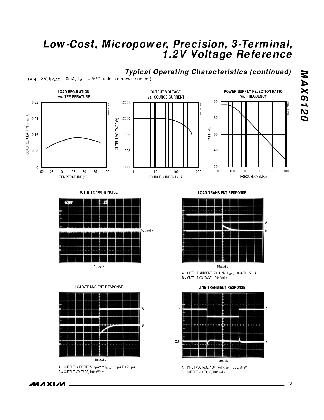

Low-Cost, Micropower, Precision, 3-Terminal,. 1.2V Voltage Reference. MAX6120
Low-Cost, Micropower, Precision, 3-Terminal, 1.2V Voltage Reference MAX6120 ____________________________Typical Operating Characteristics (continued)
(VIN = 3V, ILOAD = 0mA, TA = +25°C, unless otherwise noted.)
LOAD REGULATION OUTPUT VOLTAGE POWER-SUPPLY REJECTION RATIO vs. TEMPERATURE vs. SOURCE CURRENT vs. FREQUENCY
0.32 1.2001 100 MAX6120 TOC-03 MAX1620 TOC-06 MAX1620 TOC-05 µA) 0.24 1.2000 80 µV/ 0.16 1.1999 60 PSRR (dB) OUTPUT VOLTAGE (V) 0.08 1.1998 40 LOAD REGULATION ( 0 1.1997 20 -50 -25 0 25 50 75 100 1 10 100 1000 0.001 0.01 0.1 1 10 100 TEMPERATURE (°C) SOURCE CURRENT ( FREQUENCY (kHz) µA)
0.1Hz TO 100Hz NOISE LOAD-TRANSIENT RESPONSE
A 50µV/div B 1µs/div 10µs/div A = OUTPUT CURRENT, 50µA/div, ILOAD = 0µA TO -50µA B = OUTPUT VOLTAGE, 100mV/div
LOAD-TRANSIENT RESPONSE LINE-TRANSIENT RESPONSE
A IN A B OUT B 10µs/div 5µs/div A = OUTPUT CURRENT, 500µA/div, ILOAD = 0µA TO 500µA A = INPUT VOLTAGE, 100mV/div, VIN = 3V ± 50mV B = OUTPUT VOLTAGE, 100mV/div B = OUTPUT VOLTAGE, 10mV/div
