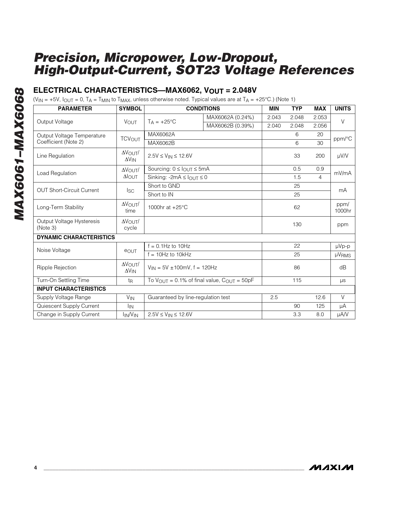

Precision, Micropower, Low-Dropout, High-Output-Current, SOT23 Voltage References ELECTRICAL CHARACTERISTICS—MAX6062, VOUT = 2.048V
(VIN = +5V, IOUT = 0, TA = TMIN to TMAX, unless otherwise noted. Typical values are at TA = +25°C.) (Note 1)
PARAMETER SYMBOL CONDITIONS MIN TYP MAX UNITS
MAX6062A (0.24%) 2.043 2.048 2.053 Output Voltage VOUT TA = +25°C V MAX6062B (0.39%) 2.040 2.048 2.056 Output Voltage Temperature MAX6062A 6 20 TCV ppm/°C Coefficient (Note 2) OUT MAX6062B 6 30 ∆V Line Regulation OUT/ ∆ 2.5V ≤ VIN ≤ 12.6V 33 200 µV/V VIN ∆V Sourcing: 0 ≤ IOUT ≤ 5mA 0.5 0.9 Load Regulation OUT/ ∆ mV/mA IOUT Sinking: -2mA ≤ IOUT ≤ 0 1.5 4 Short to GND 25 OUT Short-Circuit Current ISC mA Short to IN 25 ∆V ppm/ Long-Term Stability OUT/ 1000hr at +25°C 62 time 1000hr
MAX6061–MAX6068
Output Voltage Hysteresis ∆VOUT/ 130 ppm (Note 3) cycle
DYNAMIC CHARACTERISTICS
f = 0.1Hz to 10Hz 22 µVp-p Noise Voltage eOUT f = 10Hz to 10kHz 25 µVRMS ∆V Ripple Rejection OUT/ ∆ VIN = 5V ±100mV, f = 120Hz 86 dB VIN Turn-On Settling Time tR To VOUT = 0.1% of final value, COUT = 50pF 115 µs
INPUT CHARACTERISTICS
Supply Voltage Range VIN Guaranteed by line-regulation test 2.5 12.6 V Quiescent Supply Current IIN 90 125 µA Change in Supply Current IIN/VIN 2.5V ≤ VIN ≤ 12.6V 3.3 8.0 µA/V
