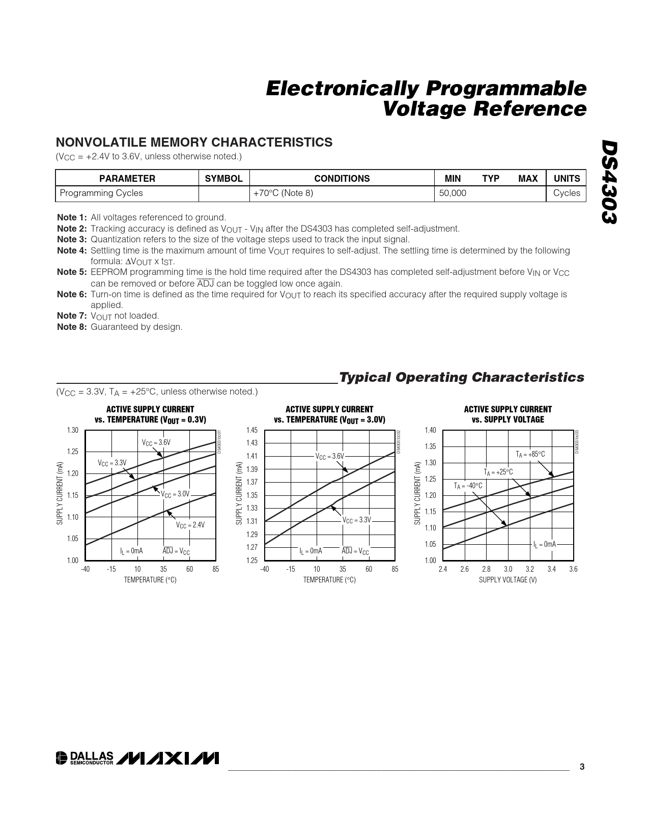

Electronically Programmable. Voltage Reference. DS4303. NONVOLATILE MEMORY CHARACTERISTICS. PARAMETER. SYMBOL. CONDITIONS. MIN. TYP. MAX
Electronically Programmable Voltage Reference DS4303 NONVOLATILE MEMORY CHARACTERISTICS PARAMETER SYMBOL CONDITIONS MIN TYP MAX
(VCC = +2.4V to 3.6V, unless otherwise noted.)
PARAMETER SYMBOL CONDITIONS MIN TYP MAX UNITS
Programming Cycles +70°C (Note 8) 50,000 Cycles
Note 1:
All voltages referenced to ground.
Note 2:
Tracking accuracy is defined as VOUT - VIN after the DS4303 has completed self-adjustment.
Note 3:
Quantization refers to the size of the voltage steps used to track the input signal.
Note 4:
Settling time is the maximum amount of time VOUT requires to self-adjust. The settling time is determined by the following formula: ∆VOUT x tST.
Note 5:
EEPROM programming time is the hold time required after the DS4303 has completed self-adjustment before VIN or VCC can be removed or before ADJ can be toggled low once again.
Note 6:
Turn-on time is defined as the time required for VOUT to reach its specified accuracy after the required supply voltage is applied.
Note 7:
VOUT not loaded.
Note 8:
Guaranteed by design.
Typical Operating Characteristics
(VCC = 3.3V, TA = +25°C, unless otherwise noted.)
ACTIVE SUPPLY CURRENT ACTIVE SUPPLY CURRENT ACTIVE SUPPLY CURRENT vs. TEMPERATURE (VOUT = 0.3V) vs. TEMPERATURE (VOUT = 3.0V) vs. SUPPLY VOLTAGE
1.30 1.45 1.40 VCC = 3.6V 1.43 1.35 DS4303 toc01 1.25 DS4303 toc02 DS4303 toc03 1.41 V T CC = 3.6V A = +85°C VCC = 3.3V 1.30 1.39 1.20 TA = +25°C 1.37 1.25 TA = -40°C 1.15 VCC = 3.0V 1.35 1.20 1.33 1.15 1.10 SUPPLY CURRENT (mA) V V SUPPLY CURRENT (mA) 1.31 CC = 3.3V SUPPLY CURRENT (mA) CC = 2.4V 1.10 1.29 1.05 1.27 1.05 IL = 0mA IL = 0mA ADJ = VCC IL = 0mA ADJ = VCC 1.00 1.25 1.00 -40 -15 10 35 60 85 -40 -15 10 35 60 85 2.4 2.6 2.8 3.0 3.2 3.4 3.6 TEMPERATURE (°C) TEMPERATURE (°C) SUPPLY VOLTAGE (V)
