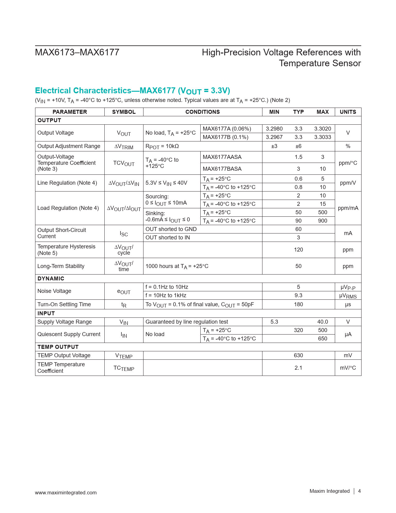

Electrical Characteristics—MAX6177 (VOUT = 3.3V). PARAMETER. SYMBOL. CONDITIONS. MIN. TYP. MAX. UNITS. OUTPUT. DYNAMIC. INPUT. TEMP OUTPUT
Electrical Characteristics—MAX6177 (VOUT = 3.3V) PARAMETER SYMBOL CONDITIONS MIN TYP MAX UNITS OUTPUT DYNAMIC INPUT TEMP OUTPUT
MAX6173–MAX6177 High-Precision Voltage References with Temperature Sensor
(VIN = +10V, TA = -40°C to +125°C, unless otherwise noted. Typical values are at TA = +25°C.) (Note 2)
MAX6177A (0.06%) 3.2980 3.3 3.3020 Output Voltage VOUT No load, TA = +25°C V MAX6177B (0.1%) 3.2967 3.3 3.3033 Output Adjustment Range ∆VTRIM RPOT = 10kΩ ±3 ±6 % Output-Voltage MAX6177AASA 1.5 3 Temperature Coefficient TCV T OUT A = -40°C to ppm/°C (Note 3) +125°C MAX6177BASA 3 10 T Line Regulation (Note 4) DV A = +25°C 0.6 5 OUT/DVIN 5.3V ≤ VIN ≤ 40V ppm/V TA = -40°C to +125°C 0.8 10 Sourcing: TA = +25°C 2 10 0 ≤ IOUT ≤ 10mA T Load Regulation (Note 4) DV A = -40°C to +125°C 2 15 OUT/DIOUT ppm/mA Sinking: TA = +25°C 50 500 -0.6mA ≤ IOUT ≤ 0 TA = -40°C to +125°C 90 900 Output Short-Circuit OUT shorted to GND 60 Current ISC mA OUT shorted to IN 3 Temperature Hysteresis DVOUT/ (Note 5) cycle 120 ppm Long-Term Stability DVOUT/ time 1000 hours at TA = +25°C 50 ppm
DYNAMIC
f = 0.1Hz to 10Hz 5 µV Noise Voltage e P-P OUT f = 10Hz to 1kHz 9.3 µVRMS Turn-On Settling Time tR To VOUT = 0.1% of final value, COUT = 50pF 180 µs
INPUT
Supply Voltage Range VIN Guaranteed by line regulation test 5.3 40.0 V T Quiescent Supply Current I A = +25°C 320 500 IN No load µA TA = -40°C to +125°C 650
TEMP OUTPUT
TEMP Output Voltage VTEMP 630 mV TEMP Temperature Coefficient TCTEMP 2.1 mV/°C www.maximintegrated.com Maxim Integrated │ 4 Document Outline _GoBack
