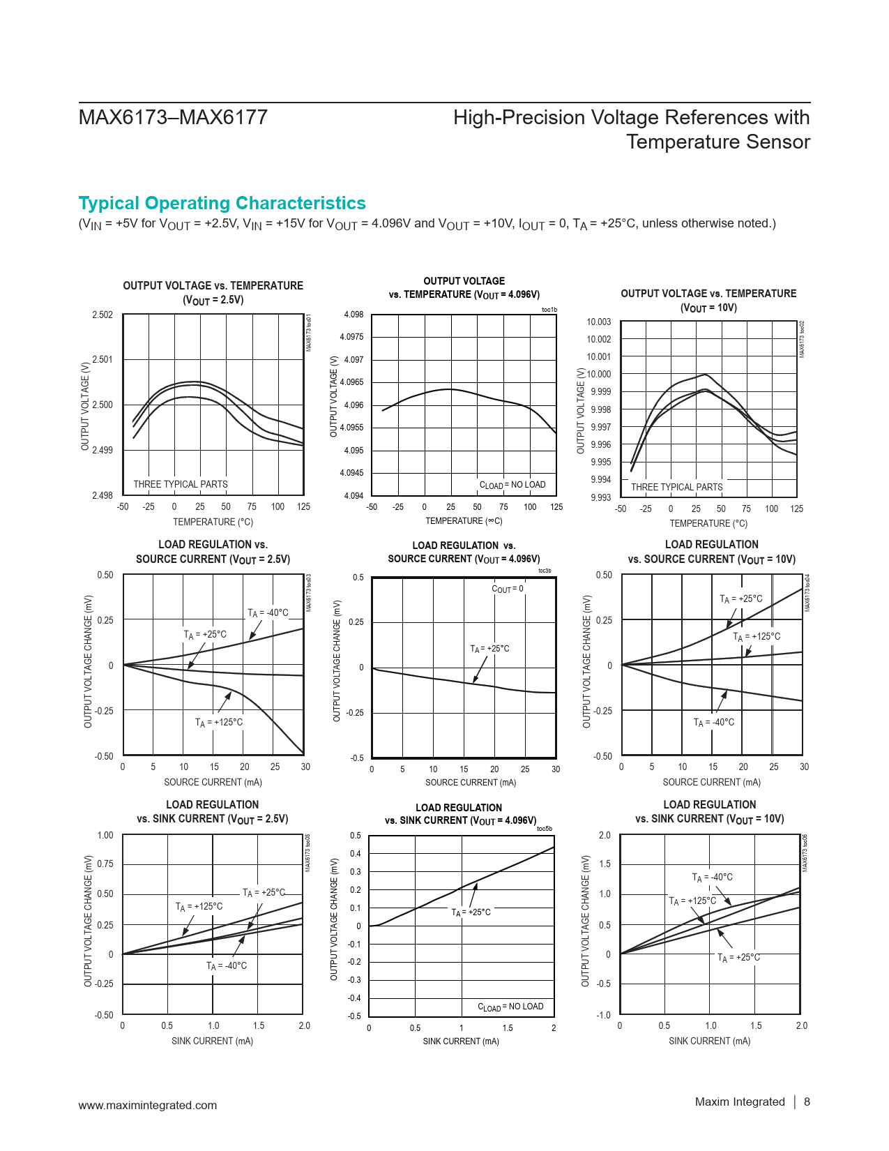

Typical Operating Characteristics. OUTPUT VOLTAGE. OUTPUT VOLTAGE vs. TEMPERATURE. vs. TEMPERATURE (VOUT = 4.096V)
Typical Operating Characteristics OUTPUT VOLTAGE OUTPUT VOLTAGE vs TEMPERATURE vs TEMPERATURE (VOUT = 4.096V)
MAX6173–MAX6177 High-Precision Voltage References with Temperature Sensor
(VIN = +5V for VOUT = +2.5V, VIN = +15V for VOUT = 4.096V and VOUT = +10V, IOUT = 0, TA = +25°C, unless otherwise noted.)
OUTPUT VOLTAGE OUTPUT VOLTAGE vs. TEMPERATURE vs. TEMPERATURE (VOUT = 4.096V) OUTPUT VOLTAGE vs. TEMPERATURE (VOUT = 2.5V) (V
2.502 4.098 toc1b
OUT = 10V)
10.003 4.0975 10.002 MAX6173 toc01 ) 2.501 4.097 10.001 MAX6173 toc02 10.000 4.0965 TAGE (V 9.999 2.500 VOL 4.096 9.998 4.0955 9.997 OUTPUT OUTPUT VOLTAGE (V) 2.499 4.095 9.996 OUTPUT VOLTAGE (V) 9.995 4.0945 THREE TYPICAL PARTS C 9.994 LOAD = NO LOAD THREE TYPICAL PARTS 2.498 4.094 9.993 -50 -25 0 25 50 75 100 125 -50 -25 0 25 50 75 100 125 -50 -25 0 25 50 75 100 125 TEMPERATURE (°C) TEMPERATURE (∞C) TEMPERATURE (°C)
LOAD REGULATION vs. LOAD REGULATION vs. LOAD REGULATION SOURCE CURRENT (VOUT = 2.5V) SOURCE CURRENT (VOUT = 4.096V) vs. SOURCE CURRENT (VOUT = 10V)
0.50 0.5 toc3b 0.50 COUT = 0 V) TA = +25°C MAX6173 toc03 T MAX6173 toc04 0.25 A = -40°C 0.25 0.25 TA = +25°C TA = +125°C TA = +25°C 0 0 0 -0.25 -0.25 -0.25 OUTPUT VOLTAGE CHANGE (mV) TA = +125°C OUTPUT VOLTAGE CHANGE (m OUTPUT VOLTAGE CHANGE (mV) TA = -40°C -0.50 -0.5 -0.50 0 5 10 15 20 25 30 0 5 10 15 20 25 30 0 5 10 15 20 25 30 SOURCE CURRENT (mA) SOURCE CURRENT (mA) SOURCE CURRENT (mA)
LOAD REGULATION LOAD REGULATION LOAD REGULATION vs. SINK CURRENT (VOUT = 2.5V) vs. SINK CURRENT (VOUT = 4.096V) vs. SINK CURRENT (VOUT = 10V)
1.00 0.5 toc5b 2.0 0.4 0.75 ) 1.5 MAX6173 toc05 0.3 MAX6173 toc06 TA = -40°C 0.50 TA = +25°C 0.2 1.0 T TA = +125°C A = +125°C 0.1 TA = +25°C 0.25 0 TAGE CHANGE (mV 0.5 VOL -0.1 0 0 T T -0.2 A = +25°C A = -40°C OUTPUT VOLTAGE CHANGE (mV) -0.25 OUTPUT -0.3 OUTPUT VOLTAGE CHANGE (mV) -0.5 -0.4 C -0.50 LOAD = NO LOAD -0.5 -1.0 0 0.5 1.0 1.5 2.0 0 0.5 1 1.5 2 0 0.5 1.0 1.5 2.0 SINK CURRENT (mA) SINK CURRENT (mA) SINK CURRENT (mA) www.maximintegrated.com Maxim Integrated │ 8 Document Outline _GoBack
