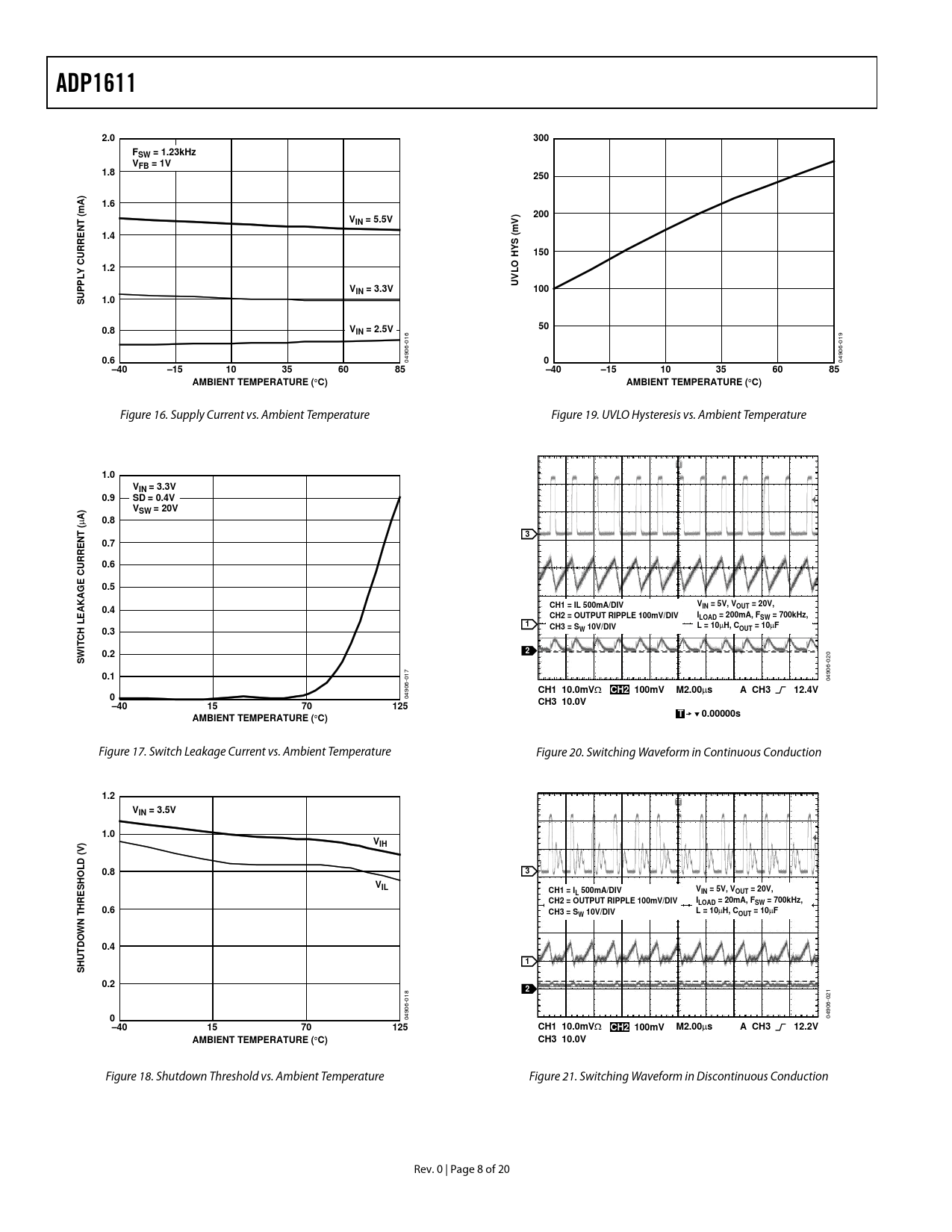

Description20 V,1.2 MHz Step-Up DC-to-DC Switching Converter
Pages / Page20 / 8 — ADP1611. 2.0. 300. FSW = 1.23kHz VFB = 1V. 1.8. 250. 1.6. 200. VIN = …
File Format / SizePDF / 763 Kb
ADP1611. 2.0. 300. FSW = 1.23kHz VFB = 1V. 1.8. 250. 1.6. 200. VIN = 5.5V. NT (mA). 1.4. YS (. 150. CURRE Y. 1.2. LO H. 100. IN = 3.3V. 1.0. 0.8. VIN = 2.5V. 0.6
ADP1611 2.0 300 FSW = 1.23kHz VFB = 1V 1.8 250 1.6 200 VIN = 5.5V NT (mA) 1.4 YS ( 150 CURRE Y 1.2 LO H 100 IN = 3.3V 1.0 0.8 VIN = 2.5V 0.6
ADP1611 2.0 300 FSW = 1.23kHz VFB = 1V 1.8 250 1.6 200 VIN = 5.5V V) NT (mA) m 1.4 YS ( 150 CURRE Y 1.2 LO H L V P U P V 100 U IN = 3.3V S 1.0 50 0.8 VIN = 2.5V 0.6

Figure 16. Supply Current vs. Ambient Temperature Figure 19. UVLO Hysteresis vs. Ambient Temperature
1.0 VIN = 3.3V 0.9 SD = 0.4V VSW = 20V

A) 0.8 3 NT ( 0.7 0.6 CURRE 0.5 CH1 = IL 500mA/DIV V AKAGE 0.4 IN = 5V, VOUT = 20V, CH2 = OUTPUT RIPPLE 100mV/DIV ILOAD = 200mA, FSW = 700kHz, 1 CH3 = S L = 10

Figure 17. Switch Leakage Current vs. Ambient Temperature Figure 20. Switching Waveform in Continuous Conduction
1.2 VIN = 3.5V 1.0 ) VIH OLD (V 0.8 3 H S VIL CH1 = I V L 500mA/DIV IN = 5V, VOUT = 20V, CH2 = OUTPUT RIPPLE 100mV/DIV ILOAD = 20mA, FSW = 700kHz, 0.6 CH3 = S L = 10

Figure 18. Shutdown Threshold vs. Ambient Temperature Figure 21. Switching Waveform in Discontinuous Conduction Rev. 0 | Page 8 of 20 Document Outline FEATURES APPLICATIONS GENERAL DESCRIPTION FUNCTIONAL BLOCK DIAGRAM SPECIFICATIONS ABSOLUTE MAXIMUM RATINGS ESD CAUTION PIN CONFIGURATION AND FUNCTION DESCRIPTIONS TYPICAL PERFORMANCE CHARACTERISTICS THEORY OF OPERATION CURRENT-MODE PWM OPERATION FREQUENCY SELECTION SOFT START ON/OFF CONTROL SETTING THE OUTPUT VOLTAGE INDUCTOR SELECTION CHOOSING THE INPUT AND OUTPUT CAPACITORS DIODE SELECTION LOOP COMPENSATION SOFT-START CAPACITOR APPLICATION CIRCUITS STEP-UP DC-TO-DC CONVERTER WITH TRUE SHUTDOWN TFT LCD BIAS SUPPLY SEPIC POWER SUPPLY LAYOUT PROCEDURE OUTLINE DIMENSIONS ORDERING GUIDE
