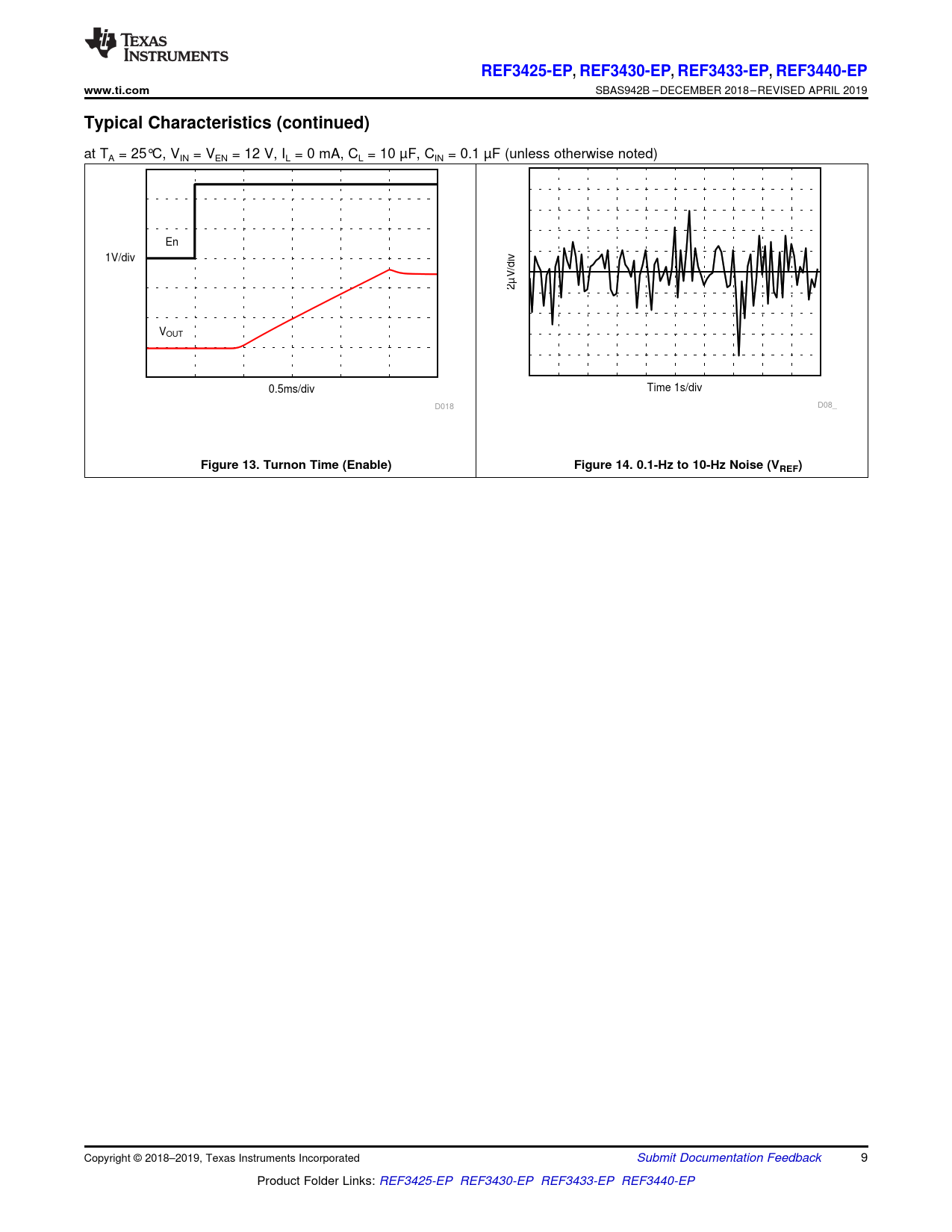

REF3425-EP. , REF3430-EP,. REF3433-EP,. REF3440-EP. www.ti.com. Typical Characteristics (continued)
REF3425-EP , REF3430-EP, REF3433-EP, REF3440-EP www.ti.com
SBAS942B – DECEMBER 2018 – REVISED APRIL 2019
at TA = 25°C, VIN = VEN = 12 V, IL = 0 mA, CL = 10 µF, CIN = 0.1 µF (unless otherwise noted) En 1V/div /div V 2µ VOUT 0.5ms/div Time 1s/div D018 D08_
Figure 13. Turnon Time (Enable) Figure 14. 0.1-Hz to 10-Hz Noise (VREF)
