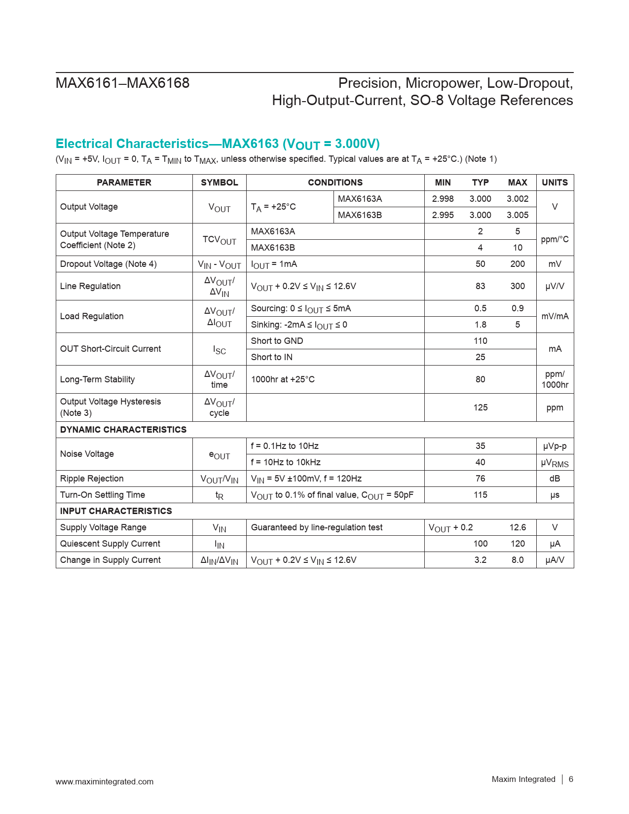

Electrical Characteristics—MAX6163 (VOUT = 3.000V). PARAMETER. SYMBOL. CONDITIONS. MIN. TYP. MAX. UNITS. DYNAMIC CHARACTERISTICS
Electrical Characteristics—MAX6163 (VOUT = 3.000V) PARAMETER SYMBOL CONDITIONS MIN TYP MAX UNITS DYNAMIC CHARACTERISTICS
MAX6161–MAX6168 Precision, Micropower, Low-Dropout, High-Output-Current, SO-8 Voltage References
(VIN = +5V, IOUT = 0, TA = TMIN to TMAX, unless otherwise specified. Typical values are at TA = +25°C.) (Note 1)
MAX6163A 2.998 3.000 3.002 Output Voltage VOUT TA = +25°C V MAX6163B 2.995 3.000 3.005 Output Voltage Temperature MAX6163A 2 5 Coefficient (Note 2) TCVOUT ppm/°C MAX6163B 4 10 Dropout Voltage (Note 4) VIN - VOUT IOUT = 1mA 50 200 mV Line Regulation ΔVOUT/ ΔV VOUT + 0.2V ≤ VIN ≤ 12.6V 83 300 µV/V IN Sourcing: 0 ≤ I Load Regulation ΔVOUT/ OUT ≤ 5mA 0.5 0.9 ΔI mV/mA OUT Sinking: -2mA ≤ IOUT ≤ 0 1.8 5 Short to GND 110 OUT Short-Circuit Current ISC mA Short to IN 25 Long-Term Stability ΔVOUT/ time 1000hr at +25°C 80 ppm/ 1000hr Output Voltage Hysteresis ΔVOUT/ (Note 3) cycle 125 ppm
f = 0.1Hz to 10Hz 35 µVp-p Noise Voltage eOUT f = 10Hz to 10kHz 40 µVRMS Ripple Rejection VOUT/VIN VIN = 5V ±100mV, f = 120Hz 76 dB Turn-On Settling Time tR VOUT to 0.1% of final value, COUT = 50pF 115 µs
INPUT CHARACTERISTICS
Supply Voltage Range VIN Guaranteed by line-regulation test VOUT + 0.2 12.6 V Quiescent Supply Current IIN 100 120 µA Change in Supply Current ΔIIN/ΔVIN VOUT + 0.2V ≤ VIN ≤ 12.6V 3.2 8.0 µA/V www.maximintegrated.com Maxim Integrated │ 6
