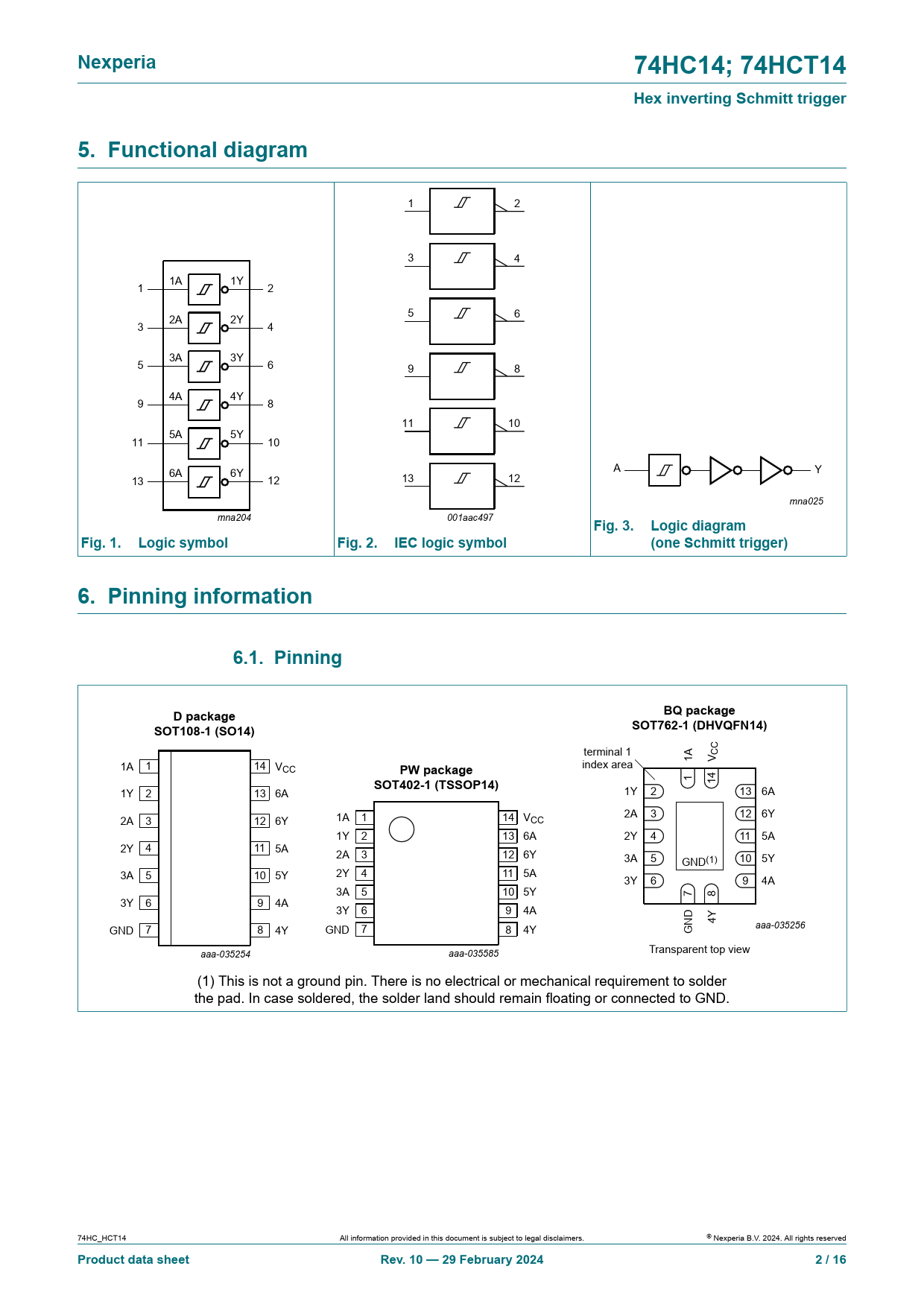

Nexperia. 74HC14; 74HCT14 Hex inverting Schmitt trigger. 5. Functional diagram. Fig. 3. Logic diagram. Fig. 1. Logic symbol
Nexperia 74HC14; 74HCT14 Hex inverting Schmitt trigger 5. Functional diagram
1 2 3 4 1A 1Y 1 2 2A 2Y 5 6 3 4 3A 3Y 5 6 9 8 4A 4Y 9 8 11 10 5A 5Y 11 10 6A 6Y A Y 13 12 13 12 mna025 mna204 001aac497
Fig. 3. Logic diagram Fig. 1. Logic symbol Fig. 2. IEC logic symbol (one Schmitt trigger) 6. Pinning information 6.1. Pinning D package BQ package SOT108-1 (SO14) SOT762-1 (DHVQFN14)
C terminal 1 1A V C 1A 1 14 VCC
PW package
index area
SOT402-1 (TSSOP14)
1 14 1Y 2 13 6A 1Y 2 13 6A 3 12 2A 3 12 6Y 1A 1 14 V 2A 6Y CC 1Y 2 13 6A 2Y 4 11 5A 2Y 4 11 5A 2A 3 12 6Y 3A 5 10 5Y GND(1) 3A 5 10 5Y 2Y 4 11 5A 3Y 6 9 4A 3A 5 10 5Y 7 8 3Y 6 9 4A 3Y 6 9 4A D N 4Y GND 7 8 4Y GND 7 8 4Y aaa-035256 G aaa-035254 aaa-035585 Transparent top view (1) This is not a ground pin. There is no electrical or mechanical requirement to solder the pad. In case soldered, the solder land should remain floating or connected to GND. 74HC_HCT14 All information provided in this document is subject to legal disclaimers. © Nexperia B.V. 2024. Al rights reserved
