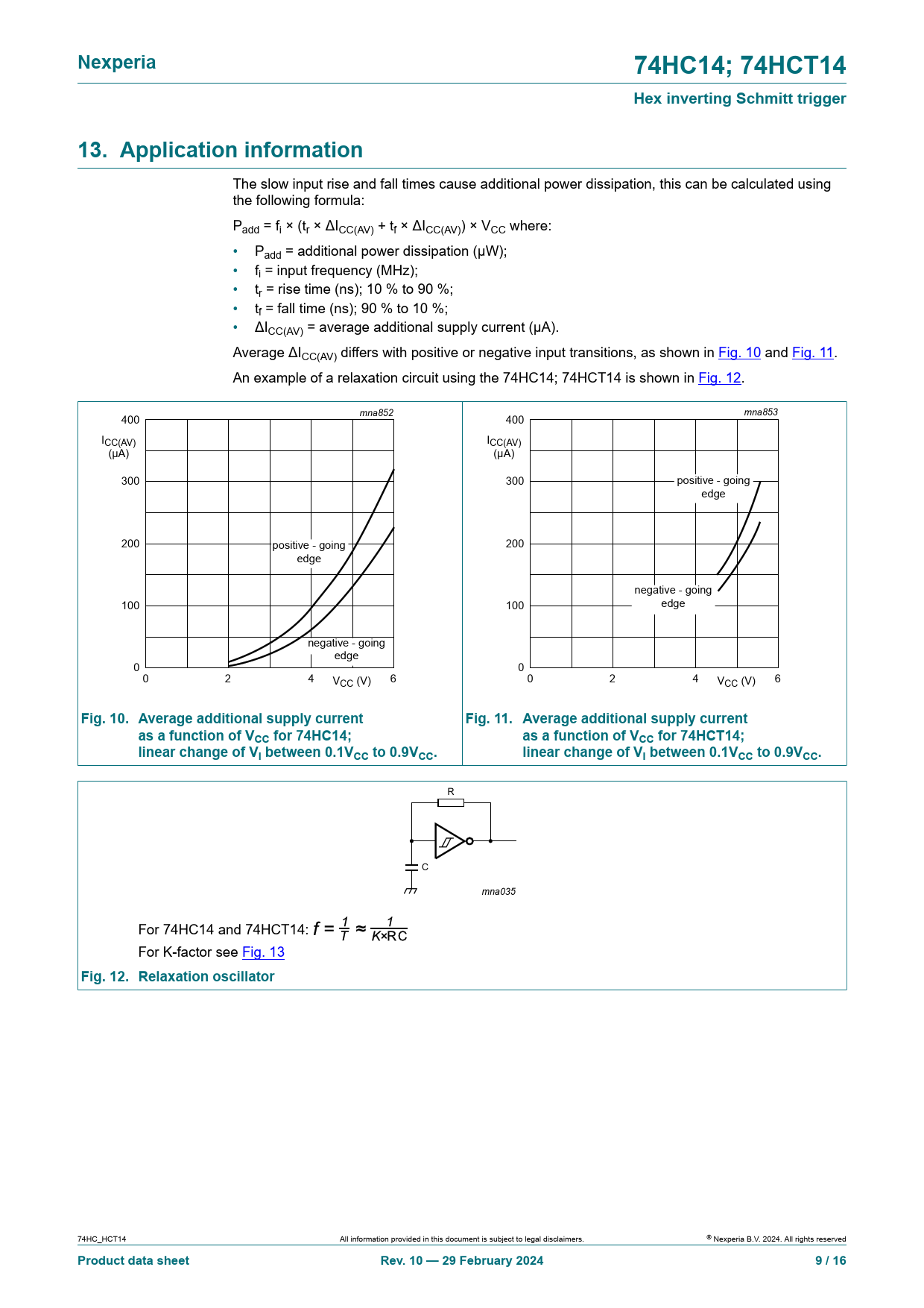

The slow input rise and fall times cause additional power dissipation, this can be calculated using the following formula: Padd = fi × (tr × ΔICC(AV) + tf × ΔICC(AV)) × VCC where: • Padd = additional power dissipation (μW); • fi = input frequency (MHz); • tr = rise time (ns); 10 % to 90 %; • tf = fall time (ns); 90 % to 10 %; • ΔICC(AV) = average additional supply current (μA). Average ΔICC(AV) dif ers with positive or negative input transitions, as shown in Fig. 10 and Fig. 11. An example of a relaxation circuit using the 74HC14; 74HCT14 is shown in Fig. 12. 400 mna852 400 mna853 ICC(AV) ICC(AV) (µA) (µA) 300 300 positive - going edge 200 positive - going 200 edge negative - going 100 100 edge negative - going edge 0 0 0 2 4 V 6 CC (V) 0 2 4 V 6 CC (V)
Fig. 10. Average additional supply current Fig. 11. Average additional supply current as a function of VCC for 74HC14; as a function of VCC for 74HCT14; linear change of VI between 0.1VCC to 0.9VCC. linear change of VI between 0.1VCC to 0.9VCC.
R C mna035 For 74HC14 and 74HCT14: For K-factor see Fig. 13
Fig. 12. Relaxation oscillator
