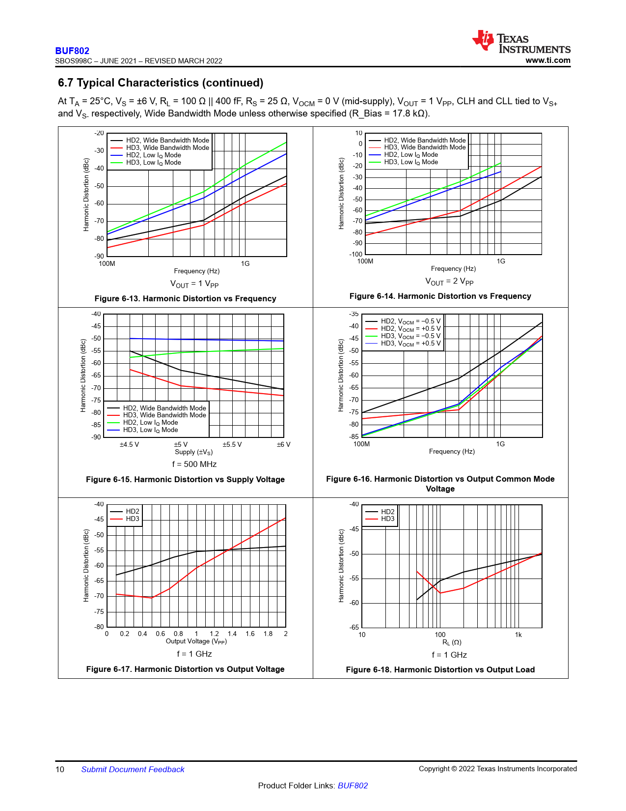

BUF802. www.ti.com. 6.7 Typical Characteristics (continued). Figure 6-13. Harmonic Distortion vs Frequency
BUF802
SBOS998C – JUNE 2021 – REVISED MARCH 2022
www.ti.com 6.7 Typical Characteristics (continued)
At TA = 25°C, VS = ±6 V, RL = 100 Ω || 400 fF, RS = 25 Ω, VOCM = 0 V (mid-supply), VOUT = 1 VPP, CLH and CLL tied to VS+ and VS- respectively, Wide Bandwidth Mode unless otherwise specified (R_Bias = 17.8 kΩ). -20 10 HD2, Wide Bandwidth Mode HD2, Wide Bandwidth Mode 0 -30 HD3, Wide Bandwidth Mode HD3, Wide Bandwidth Mode HD2, Low IQ Mode -10 HD2, Low IQ Mode c) HD3, Low I c) Q Mode HD3, Low IQ Mode dB -40 dB -20 n ( n ( -30 io io rt -50 rt -40 Disto Disto -50 c -60 c -60 -70 -70 Harmoni Harmoni -80 -80 -90 -90 -100 100M 1G 100M 1G Frequency (Hz) Frequency (Hz) V V OUT = 1 VPP OUT = 2 VPP
Figure 6-13. Harmonic Distortion vs Frequency Figure 6-14. Harmonic Distortion vs Frequency
-40 -35 HD2, V -45 -40 OCM = −0.5 V HD2, VOCM = +0.5 V HD3, VOCM = −0.5 V c) -50 ) -45 HD3, VOCM = +0.5 V dB -55 -50 n ( io rt -60 -55 ortion (dBc -65 -60 Disto c Dist -70 -65 -75 -70 Harmoni HD2, Wide Bandwidth Mode -80 Harmonic HD3, Wide Bandwidth Mode -75 -85 HD2, Low IQ Mode -80 HD3, Low IQ Mode -90 -85 4.5 V 5 V 5.5 V 6 V 100M 1G Supply (VS) Frequency (Hz) f = 500 MHz .
Figure 6-15. Harmonic Distortion vs Supply Voltage Figure 6-16. Harmonic Distortion vs Output Common Mode Voltage
-40 -40 HD2 HD2 -45 HD3 HD3 ) -45 -50 c) dB -55 n ( io -50 ortion (dBc rt -60 Dist Disto c -65 -55 Harmonic -70 Harmoni -60 -75 -80 -65 0 0.2 0.4 0.6 0.8 1 1.2 1.4 1.6 1.8 2 10 100 1k Output Voltage (VPP) RL () f = 1 GHz f = 1 GHz
Figure 6-17. Harmonic Distortion vs Output Voltage Figure 6-18. Harmonic Distortion vs Output Load
