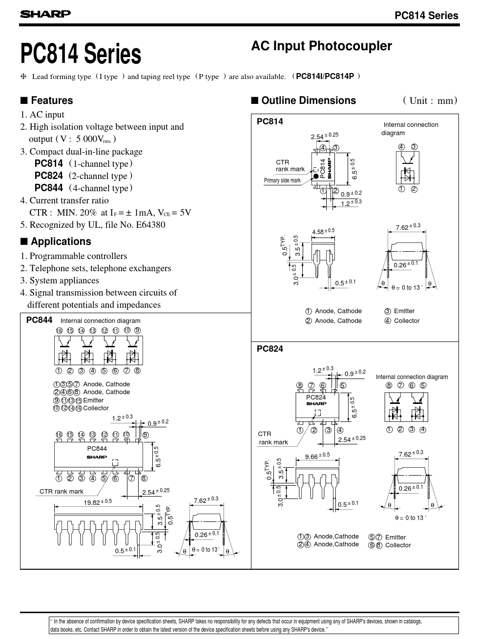

PC814 Series AC Input Photocoupler PC814 Series ❈ Lead forming type ( I type ) and taping reel type ( P type ) are also available. ( PC814I/PC814P ) ■ Features ■ Outline Dimensions 1. AC input
2. High isolation voltage between input and
output ( V : 5 000Vrms )
3. Compact dual-in-line package
PC814 ( 1-channel type )
PC824 (2-channel type )
PC844 ( 4-channel type )
4. Current transfer ratio
CTR : MIN. 20% at I F = ± 1mA, VCE = 5V
5. Recognized by UL, file No. E64380 PC814 Primary side mark 2 0.9 ± 0.2
1.2 ± 0.3 1 2 0.26 ± 0.1
0.5 ± 0.1 1 Anode, Cathode
2 Anode, Cathode Internal connection diagram
16 15 14 13 12 11 10 9 3 7.62 ± 0.3 4.58 ± 0.5 3.0 ± 0.5 3.5 ± 0.5 0.5TYP. 1 1. Programmable controllers
2. Telephone sets, telephone exchangers
3. System appliances
4. Signal transmission between circuits of
different potentials and impedances 4
6.5 ± 0.5 3 PC814 CTR
rank mark ■ Applications PC844 Internal connection
diagram 2.54 ± 0.25
4 ( Unit : mm ) θ θ = 0 to 13 ˚ θ 3 Emitter
4 Collector PC824
2 3 4 5 6 7 1.2 ± 0.3 8 1 3 5 7 Anode, Cathode
2 4 6 8 Anode, Cathode
9 11 13 15 Emitter
10 12 14 16 Collector 8 2 3 4 5 6 7 8
2.54 ± 0.25
7.62 ± 0.3
3.5 ± 0.5 19.82 ± 0.5 0.5 ± 0.1 0.5TYP. 1 CTR
rank mark
6.5 ± 0.5 PC844 CTR rank mark 0.9 ± 0.2
5 0.9 ± 0.2
9 11 10 3.5 ± 0.5 12 0.5TYP. 13 3.0 ± 0.5 14 3.0 ± 0.5 15 6 PC824 1.2 ± 0.3
16 7 1 2 Internal connection diagram
8 7 6 5 6.5 ± 0.5 1 3 4 1 2 3 4 2.54 ± 0.25
7.62 ± 0.3 9.66 ± 0.5 0.26 ± 0.1
0.5 ± 0.1 θ θ
θ = 0 to 13 ˚ 0.26 ± 0.1
θ θ = 0 to 13 ˚ θ 1 3 Anode,Cathode
2 4 Anode,Cathode 5 7 Emitter
