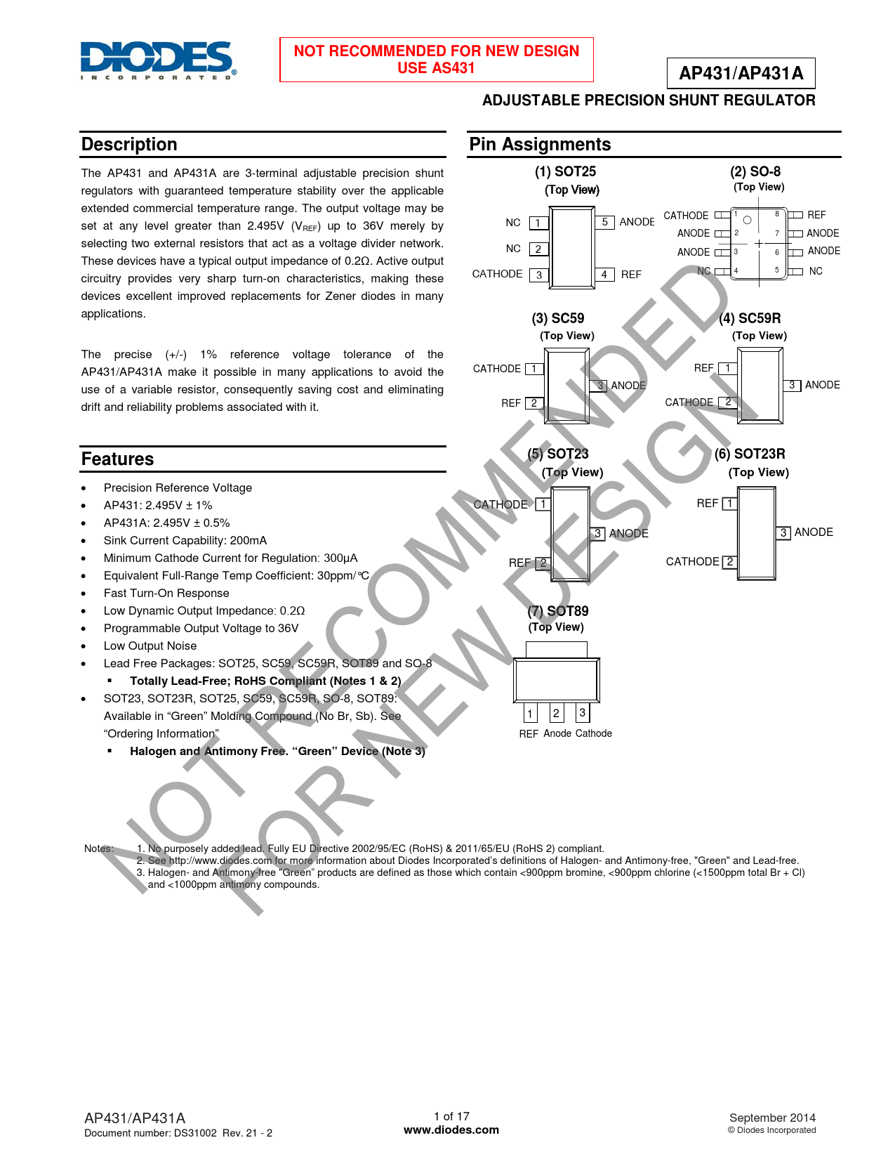

The AP431 and AP431A are 3-terminal adjustable precision shunt
(1) SOT25 (2) SO-8
regulators with guaranteed temperature stability over the applicable (Top View)
(Top View)
extended commercial temperature range. The output voltage may be 1 8 CATHODE REF set at any level greater than 2.495V (V NC 1 5 ANODE REF) up to 36V merely by ANODE 2 7 ANODE selecting two external resistors that act as a voltage divider network. NC 2 ANODE 3 6 ANODE These devices have a typical output impedance of 0.2Ω. Active output NC 4 5 NC circuitry provides very sharp turn-on characteristics, making these CATHODE 3 4 REF devices excellent improved replacements for Zener diodes in many applications.
(3) SC59 (4) SC59R (Top View) (Top View)
The precise (+/-) 1% reference voltage tolerance of the AP431/AP431A make it possible in many applications to avoid the CATHODE 1 REF 1 use of a variable resistor, consequently saving cost and eliminating 3 ANODE 3 ANODE drift and reliability problems associated with it. REF 2 CATHODE 2
Features (5) SOT23 (6) SOT23R (Top View) (Top View)
• Precision Reference Voltage • AP431: 2.495V ± 1% CATHODE 1 REF 1 • AP431A: 2.495V ± 0.5% • 3 ANODE 3 ANODE Sink Current Capability: 200mA • Minimum Cathode Current for Regulation: 300μA REF 2 CATHODE 2 • Equivalent Full-Range Temp Coefficient: 30ppm/°C • Fast Turn-On Response • Low Dynamic Output Impedance: 0.2Ω
(7) SOT89
• Programmable Output Voltage to 36V
(Top View)
• Low Output Noise • Lead Free Packages: SOT25, SC59, SC59R, SOT89 and SO-8 
Totally Lead-Free; RoHS Compliant (Notes 1 & 2)
• SOT23, SOT23R, SOT25, SC59, SC59R, SO-8, SOT89: Available in “Green” Molding Compound (No Br, Sb). See 1 2 3 “Ordering Information” REF Anode Cathode 
Halogen and Antimony Free. “Green” Device (Note 3)
Notes: 1. No purposely added lead. Fully EU Directive 2002/95/EC (RoHS) & 2011/65/EU (RoHS 2) compliant. 2. See http://www.diodes.com for more information about Diodes Incorporated’s definitions of Halogen- and Antimony-free, "Green" and Lead-free. 3. Halogen- and Antimony-free "Green” products are defined as those which contain <900ppm bromine, <900ppm chlorine (<1500ppm total Br + Cl) and <1000ppm antimony compounds. AP431/AP431A 1 of 17 September 2014 Document number: DS31002 Rev. 21 - 2
