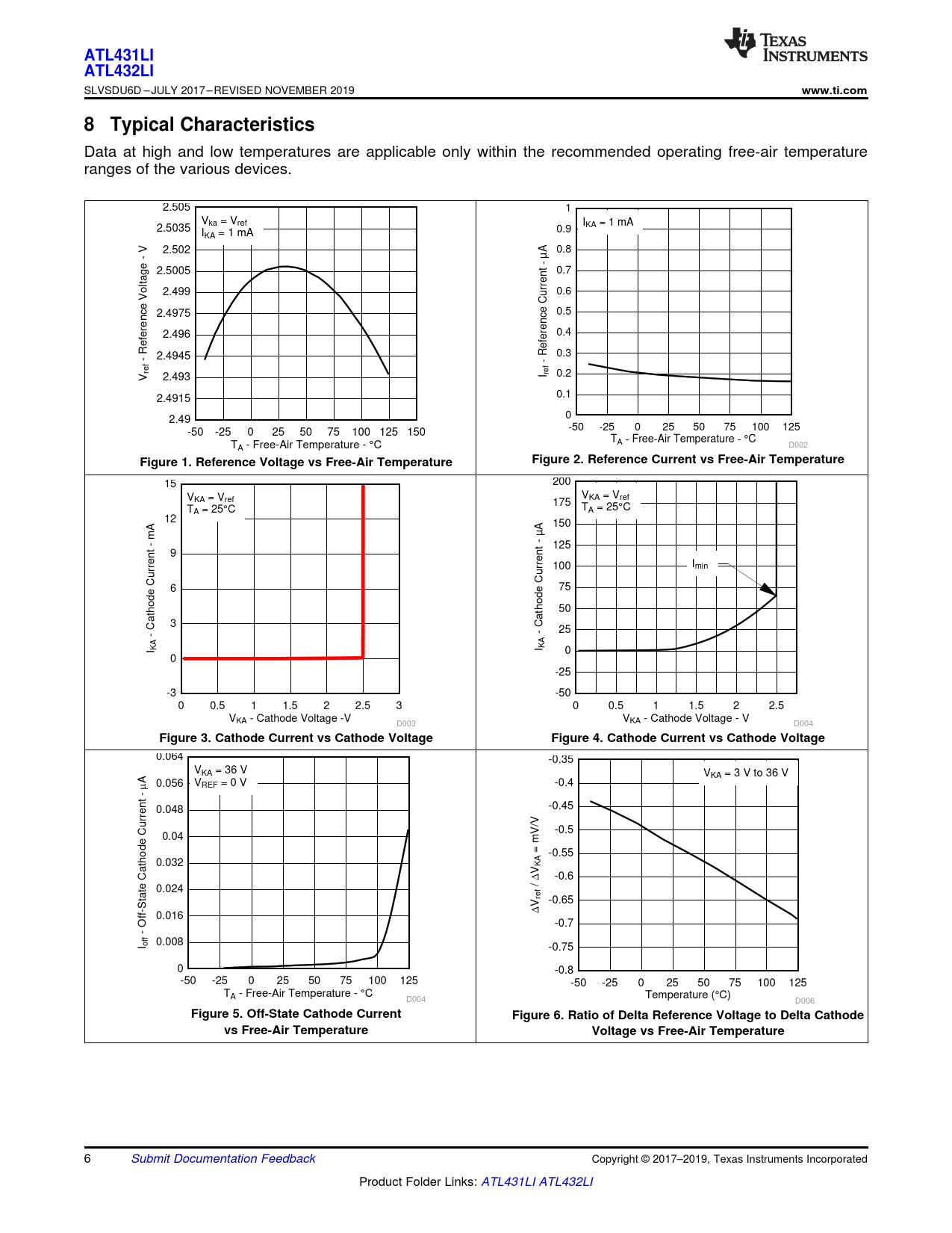

ATL431LI. ATL432LI. www.ti.com. 8 Typical Characteristics. Figure 1. Reference Voltage vs Free-Air Temperature
ATL431LI ATL432LI
SLVSDU6D – JULY 2017 – REVISED NOVEMBER 2019
www.ti.com 8 Typical Characteristics
Data at high and low temperatures are applicable only within the recommended operating free-air temperature ranges of the various devices. 2.505 1 V I 2.5035 ka = Vref KA = 1 mA I 0.9 KA = 1 mA V 2.502 A 0.8 - e 2.5005 0.7 ag nt - µ lt re 2.499 ur 0.6 Vo C ce 0.5 n 2.4975 nce re e 2.496 re 0.4 ef efe R 0.3 - 2.4945 f - R reV 2.493 I ref 0.2 2.4915 0.1 2.49 0 -50 -25 0 25 50 75 100 125 -50 -25 0 25 50 75 100 125 150 T T A - Free-Air Temperature - °C A - Free-Air Temperature - °C D002
Figure 1. Reference Voltage vs Free-Air Temperature Figure 2. Reference Current vs Free-Air Temperature
15 200 V V KA = Vref 175 KA = Vref T T A = 25°C A = 25°C 12 A 150 - µ t - mA 125 9 en ent I urr 100 min e Curr 6 75 de C od 50 ath atho 3 25 - C - C A A I K I K 0 0 -25 -3 -50 0 0.5 1 1.5 2 2.5 3 0 0.5 1 1.5 2 2.5 VKA - Cathode Voltage -V V D003 KA - Cathode Voltage - V D004
Figure 3. Cathode Current vs Cathode Voltage Figure 4. Cathode Current vs Cathode Voltage
0.064 -0.35 VKA = 36 V VKA = 3 V to 36 V A 0.056 VREF = 0 V -0.4 - P -0.45 ent 0.048 urr V/V -0.5 e C 0.04 m = -0.55 A hod 0.032 K at V -0.6 / ' te C 0.024 f re ta V -0.65 ' ff-S 0.016 -0.7 - O ff I o 0.008 -0.75 0 -0.8 -50 -25 0 25 50 75 100 125 -50 -25 0 25 50 75 100 125 TA - Free-Air Temperature - °C Temperature (°C) D004 D006
Figure 5. Off-State Cathode Current Figure 6. Ratio of Delta Reference Voltage to Delta Cathode vs Free-Air Temperature Voltage vs Free-Air Temperature
