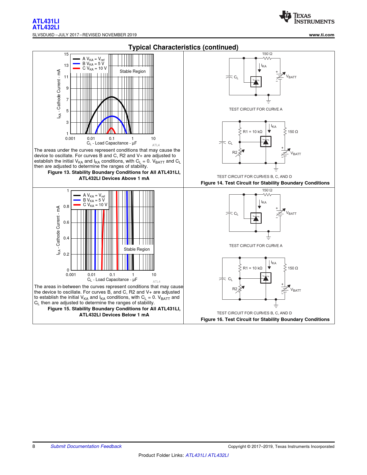

ATL431LI. ATL432LI. www.ti.com. Typical Characteristics (continued). Figure 13. Stability Boundary Conditions for All ATL431LI,
ATL431LI ATL432LI
SLVSDU6D – JULY 2017 – REVISED NOVEMBER 2019
www.ti.com Typical Characteristics (continued)
15 150 Ω A VKA = Vref 13 B VKA = 5 V IKA C VKA = 10 V Stable Region + 11 C V L BATT t - mA − en 9 e Curr od 7 ath TEST CIRCUIT FOR CURVE A - C 5 AIK 3 IKA R1 = 10 kΩ 150 Ω 1 0.001 0.01 0.1 1 10 C C L L - Load Capacitance - µF AT A L4 + The areas under the curves represent conditions that may cause the R2 VBATT device to oscillate. For curves B and C, R2 and V+ are adjusted to − establish the initial VKA and IKA conditions, with CL = 0. VBATT and CL then are adjusted to determine the ranges of stability.
TEST CIRCUIT FOR CURVES B, C, AND D
ATL432LI Devices Above 1 mA Figure 14. Test Circuit for Stability Boundary Conditions
1 150 Ω A VKA = Vref B VKA = 5 V IKA 0.8 C VKA = 10 V + C V L BATT t - mA − en 0.6 e Curr od 0.4 ath TEST CIRCUIT FOR CURVE A - C A Stable Region I K 0.2 IKA R1 = 10 kΩ 150 Ω 0 0.001 0.01 0.1 1 10 C C L L - Load Capacitance - µF ATL4 + The areas in-between the curves represent conditions that may cause R2 VBATT the device to oscillate. For curves B, and C, R2 and V+ are adjusted − to establish the initial VKA and IKA conditions, with CL = 0. VBATT and CL then are adjusted to determine the ranges of stability.
Figure 15. Stability Boundary Conditions for All ATL431LI,
ATL432LI Devices Below 1 mA Figure 16. Test Circuit for Stability Boundary Conditions
