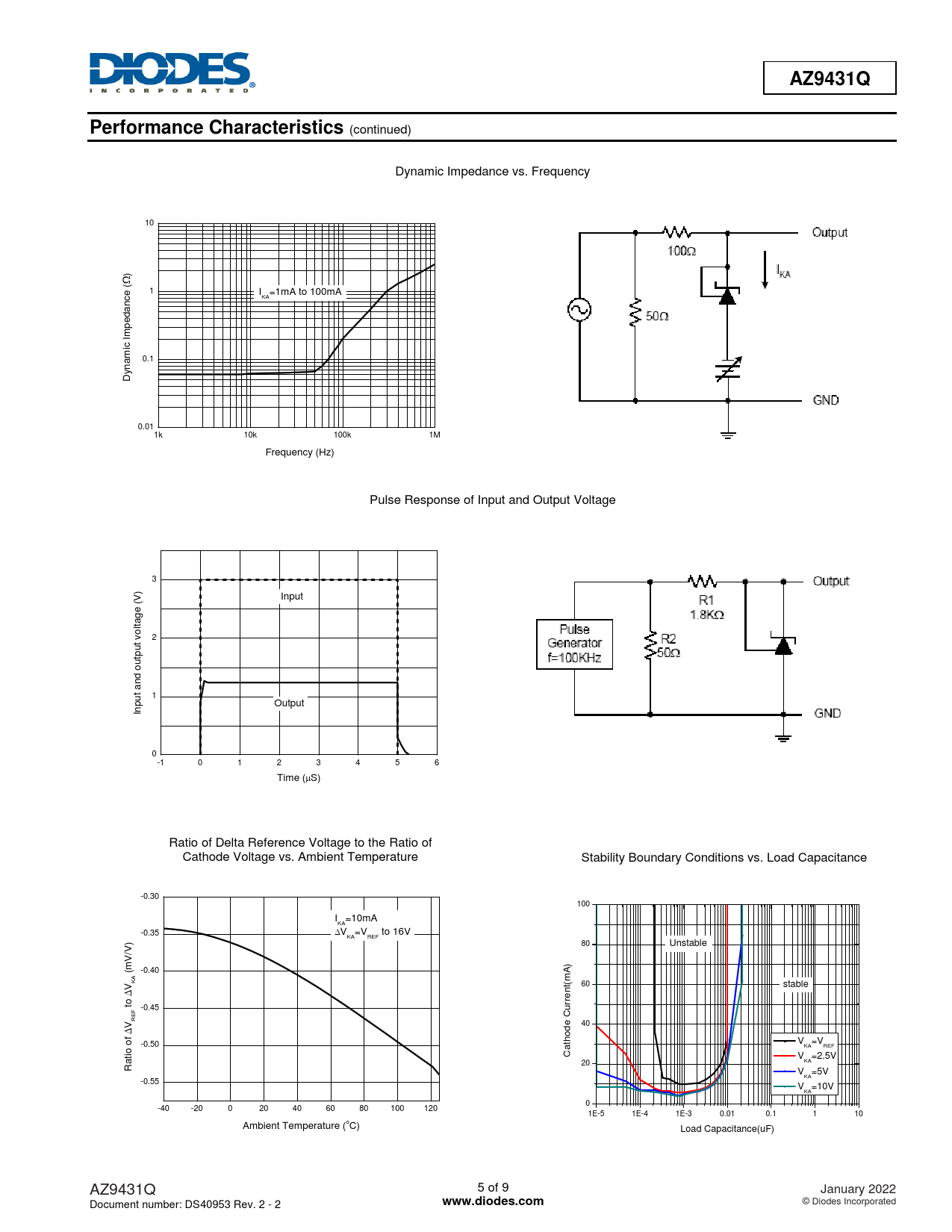

DescriptionAutomotive Compliant 1.24v Adjustable Precision Shunt Regulator
Pages / Page9 / 5 — AZ9431Q. Performance Characteristics. www.diodes.com
File Format / SizePDF / 897 Kb
AZ9431Q Performance Characteristics www.diodes.com
(continued) Dynamic Impedance vs. Frequency 10 ) ( 1 I =1mA to 100mA KA ce n a d e p Im ic m a 0.1 n y D 0.01 1k 10k 100k 1M Frequency (Hz) Pulse Response of Input and Output Voltage 3 Input (V) e g lta o 2 t v u tp u o d n t a 1 u p Output In 0 -1 0 1 2 3 4 5 6 Time (S) Ratio of Delta Reference Voltage to the Ratio of Ratio of Delta Reference Voltage to the Ratio of Ca C t ah t o h d o e d eV o V lt ola t g a e g ev s v . s .A mbien Amb t ien tTe m Te p m e p r e a r t au t r u e r e Stability Boundary Conditions vs. Load Capacitance -0.30 100 I =10mA KA -0.35 V =V to 16V KA REF 80 Unstable V) V/ -0.40 (m KA t(mA) 60 stable n V rre to -0.45 u F E R C e 40 d V o f th V =V o -0.50 a KA REF tio C V =2.5V a 20 KA R V =5V KA -0.55 V =10V KA 0 -40 -20 0 20 40 60 80 100 120 1E-5 1E-4 1E-3 0.01 0.1 1 10 Ambient Temperature (oC) Load Capacitance(uF) AZ9431Q 5 of 9 January 2022 Document number: DS40953 Rev. 2 - 2
