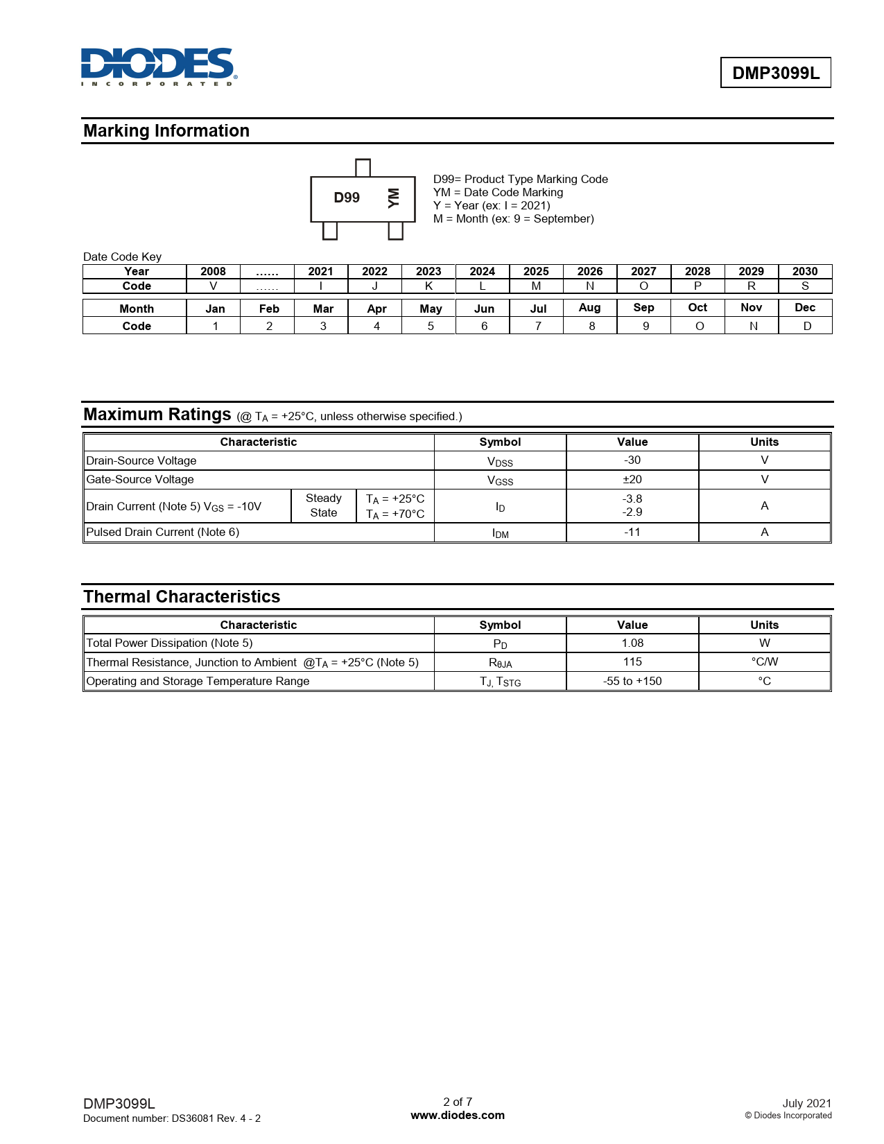

DMP3099L. Marking Information. D99. Year. 2008. 2021. 2022. 2023. 2024. 2025. 2026. 2027. 2028. 2029. 2030. Code. Month. Jan. Feb. Mar. Apr. May. Jun. Jul. Aug. Sep. Oct
DMP3099L Marking Information
D99= Product Type Marking Code YM = Date Code Marking
D99 YM
Y = Year (ex: I = 2021) M = Month (ex: 9 = September) Date Code Key
Year 2008 …… 2021 2022 2023 2024 2025 2026 2027 2028 2029 2030 Code
V …… I J K L M N O P R S
Month Jan Feb Mar Apr May Jun Jul Aug Sep Oct Nov Dec Code
1 2 3 4 5 6 7 8 9 O N D
Maximum Ratings
(@ TA = +25°C, unless otherwise specified.)
Characteristic Symbol Value Units
Drain-Source Voltage VDSS -30 V Gate-Source Voltage VGSS ±20 V Steady Drain Current (Note 5) V TA = +25°C GS = -10V State TA = +70°C ID -3.8 -2.9 A Pulsed Drain Current (Note 6) IDM -11 A
Thermal Characteristics Characteristic Symbol Value Units
Total Power Dissipation (Note 5) PD 1.08 W Thermal Resistance, Junction to Ambient @TA = +25°C (Note 5) RθJA 115 °C/W Operating and Storage Temperature Range TJ, TSTG -55 to +150 °C DMP3099L 2 of 7 July 2021 Document number: DS36081 Rev. 4 - 2
