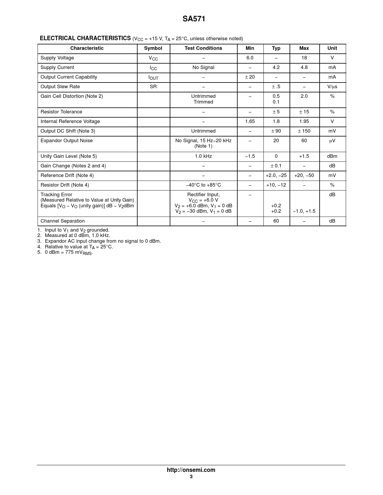

SA571 ELECTRICAL CHARACTERISTICS
(VCC = +15 V, TA = 25°C, unless otherwise noted)
Characteristic Symbol Test Conditions Min Typ Max Unit
Supply Voltage VCC − 6.0 − 18 V Supply Current ICC No Signal − 4.2 4.8 mA Output Current Capability IOUT − ± 20 − − mA Output Slew Rate SR − − ± .5 − V/ms Gain Cell Distortion (Note 2) Untrimmed − 0.5 2.0 % Trimmed 0.1 Resistor Tolerance − − ± 5 ± 15 % Internal Reference Voltage − 1.65 1.8 1.95 V Output DC Shift (Note 3) Untrimmed − ± 90 ± 150 mV Expandor Output Noise No Signal, 15 Hz−20 kHz − 20 60 mV (Note 1) Unity Gain Level (Note 5) 1.0 kHz −1.5 0 +1.5 dBm Gain Change (Notes 2 and 4) − − ± 0.1 − dB Reference Drift (Note 4) − − +2.0, −25 +20, −50 mV Resistor Drift (Note 4) −40°C to +85°C − +10, −12 − % Tracking Error Rectifier Input, − dB (Measured Relative to Value at Unity Gain) VCC = +6.0 V Equals [VO − VO (unity gain)] dB − V2dBm V2 = +6.0 dBm, V1 = 0 dB +0.2 V2 = −30 dBm, V1 = 0 dB +0.2 −1.0, +1.5 Channel Separation − − 60 − dB 1. Input to V1 and V2 grounded. 2. Measured at 0 dBm, 1.0 kHz. 3. Expandor AC input change from no signal to 0 dBm. 4. Relative to value at TA = 25°C. 5. 0 dBm = 775 mVRMS.
