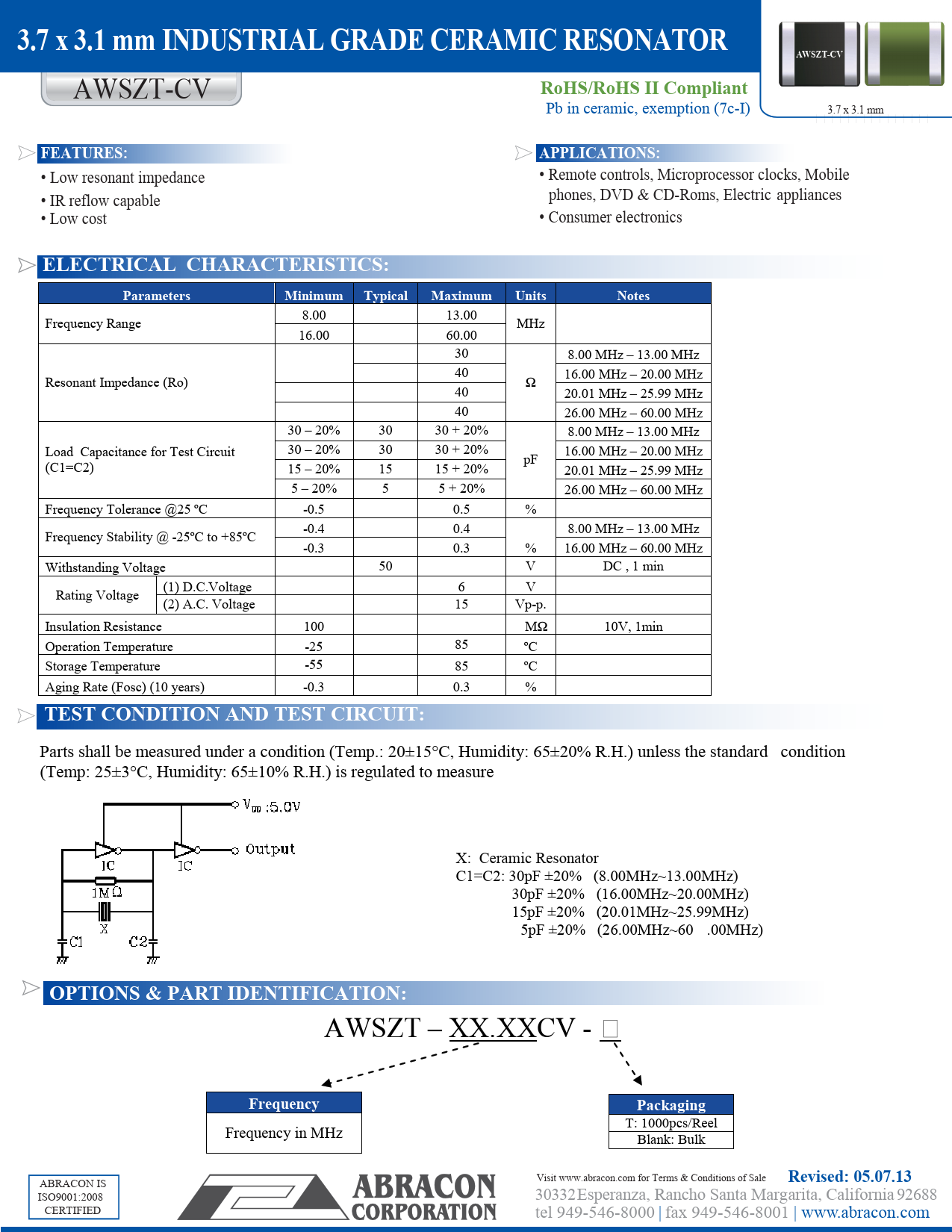

3.7 x 3.1 mm INDUSTRIAL GRADE CERAMIC RESONATOR. AWSZT-CV. RoHS/RoHS II Compliant. FEATURES:. APPLICATIONS:
3.7 x 3.1 mm INDUSTRIAL GRADE CERAMIC RESONATOR AWSZT-CV
AWSZT-CV
Pb in ceramic, exemption (7c-I) 3.7 x 3.1 mm | | | | | | | | | | | | | | |
FEATURES: APPLICATIONS:
• Low resonant impedance • Remote controls, Microprocessor clocks, Mobile phones, DVD & CD-Roms, Electric appliances • IR reflow capable • Low cost • Consumer electronics
ELECTRICAL CHARACTERISTICS: Parameters Minimum Typical Maximum Units Notes
Frequency Range 8.00 13.00 MHz 16.00 60.00 30 8.00 MHz – 13.00 MHz 40 Resonant Impedance (Ro) Ω 16.00 MHz – 20.00 MHz 40 20.01 MHz – 25.99 MHz 40 26.00 MHz – 60.00 MHz 30 – 20% 30 30 + 20% 8.00 MHz – 13.00 MHz Load Capacitance for Test Circuit 30 – 20% 30 30 + 20% 16.00 MHz – 20.00 MHz (C1=C2) pF 15 – 20% 15 15 + 20% 20.01 MHz – 25.99 MHz 5 – 20% 5 5 + 20% 26.00 MHz – 60.00 MHz Frequency Tolerance @25 ºC -0.5 0.5 % Frequency Stability @ -25ºC to +85ºC -0.4 0.4 8.00 MHz – 13.00 MHz -0.3 0.3 % 16.00 MHz – 60.00 MHz Withstanding Voltage 50 V DC , 1 min Rating Voltage (1) D.C.Voltage 6 V (2) A.C. Voltage 15 Vp-p. Insulation Resistance 100 MΩ 10V, 1min Operation Temperature -25 85 ºC Storage Temperature -55 85 ºC Aging Rate (Fosc) (10 years) -0.3 0.3 %
TEST CONDITION AND TEST CIRCUIT:
Parts shall be measured under a condition (Temp.: 20±15°C, Humidity: 65±20% R.H.) unless the standard condition (Temp: 25±3°C, Humidity: 65±10% R.H.) is regulated to measure X: Ceramic Resonator C1=C2: 30pF ±20% (8.00MHz~13.00MHz) 30pF ±20% (16.00MHz~20.00MHz) 15pF ±20% (20.01MHz~25.99MHz) 5pF ±20% (26.00MHz~60 .00MHz)
OPTIONS & PART IDENTIFICATION:
AWSZT – XX.XXCV -
Frequency Packaging
Frequency in MHz T: 1000pcs/Reel Blank: Bulk Visit www.abracon.com for Terms & Conditions of Sale
Revised: 05.07.13
ABRACON IS ISO9001:2008 30332 Esperanza, Rancho Santa Margarita, California 92688 CER CE TIFIED R tel 949-546-8000 | fax 949-546-8001 | www.abracon.com
