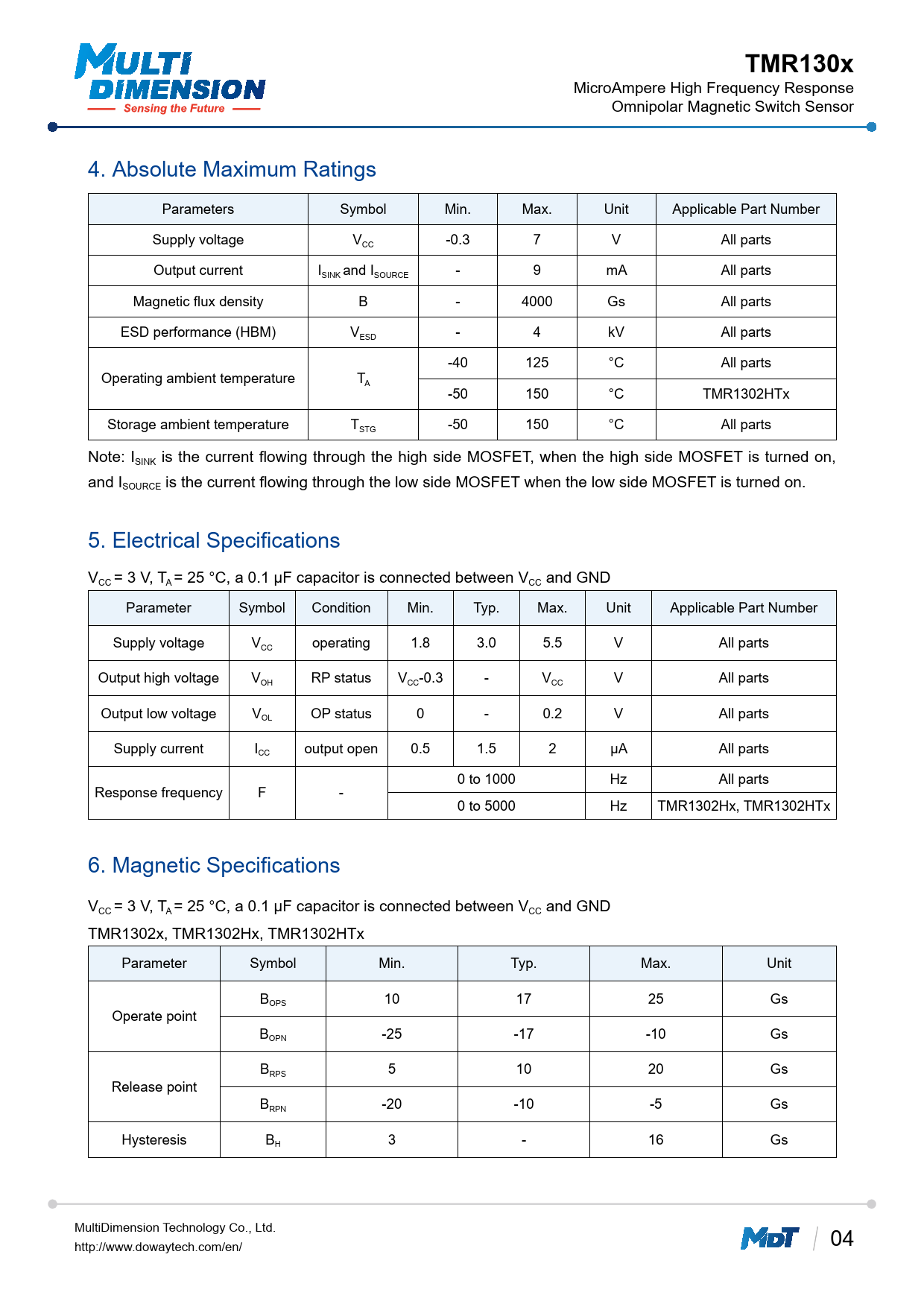

Pages / Page12 / 4 — TMR130x
TMR130x
TMR130x
TMR130x
MicroAmpere High Frequency Response Omnipolar Magnetic Switch Sensor 4. Absolute Maximum Ratings Parameters Symbol Min. Max. Unit Applicable Part Number Supply voltage VCC -0.3 7 V All parts Output current ISINK and ISOURCE - 9 mA All parts Magnetic flux density B - 4000 Gs All parts ESD performance (HBM) VESD - 4 kV All parts -40 125 °C All parts Operating ambient temperature TA -50 150 °C TMR1302HTx Storage ambient temperature TSTG -50 150 °C All parts Note: ISINK is the current flowing through the high side MOSFET, when the high side MOSFET is turned on, and ISOURCE is the current flowing through the low side MOSFET when the low side MOSFET is turned on. 5. Electrical Specifications VCC = 3 V, TA = 25 °C, a 0.1 μF capacitor is connected between VCC and GND Parameter Symbol Condition Min. Typ. Max. Unit Applicable Part Number Supply voltage VCC operating 1.8 3.0 5.5 V All parts Output high voltage VOH RP status VCC-0.3 - VCC V All parts Output low voltage VOL OP status 0 - 0.2 V All parts Supply current ICC output open 0.5 1.5 2 μA All parts 0 to 1000 Hz All parts Response frequency F - 0 to 5000 Hz TMR1302Hx, TMR1302HTx 6. Magnetic Specifications VCC = 3 V, TA = 25 °C, a 0.1 μF capacitor is connected between VCC and GND TMR1302x, TMR1302Hx, TMR1302HTx Parameter Symbol Min. Typ. Max. Unit BOPS 10 17 25 Gs Operate point BOPN -25 -17 -10 Gs BRPS 5 10 20 Gs Release point BRPN -20 -10 -5 Gs Hysteresis BH 3 - 16 Gs MultiDimension Technology Co., Ltd. 04 http://www.dowaytech.com/en/ Document Outline 1. Functional Block Diagram 2. Switching Characteristics 3. Pin Configuration 4. Absolute Maximum Ratings 5. Electrical Specifications 6. Magnetic Specifications 7. Typical Supply Voltage Characteristics 8. Typical Temperature Characteristics 9. Application Information 10. Dimensions
