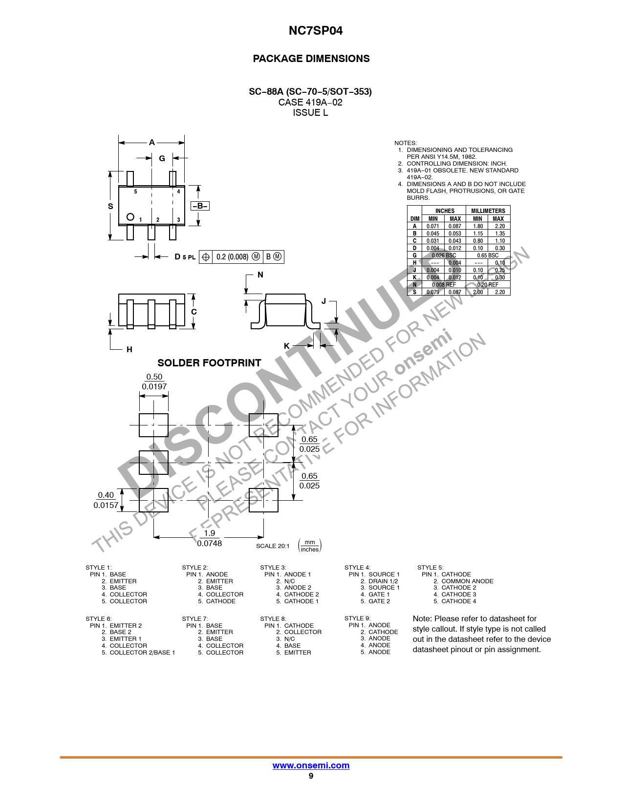

Pages / Page10 / 9 — NC7SP04. PACKAGE DIMENSIONS. SC−88A (SC−70−5/SOT−353). −B−. INCHES. …
File Format / SizePDF / 345 Kb
NC7SP04. PACKAGE DIMENSIONS. SC−88A (SC−70−5/SOT−353). −B−. INCHES. MILLIMETERS. DIM. MIN. MAX. D 5 PL. SOLDER FOOTPRINT. www.onsemi.com
NC7SP04 PACKAGE DIMENSIONS SC−88A (SC−70−5/SOT−353) −B− INCHES MILLIMETERS DIM MIN MAX D 5 PL SOLDER FOOTPRINT www.onsemi.com
CASE 419A−02 ISSUE L
A
NOTES: 1. DIMENSIONING AND TOLERANCING PER ANSI Y14.5M, 1982.
G
2. CONTROLLING DIMENSION: INCH. 3. 419A−01 OBSOLETE. NEW STANDARD 419A−02. 4. DIMENSIONS A AND B DO NOT INCLUDE
5 4
MOLD FLASH, PROTRUSIONS, OR GATE BURRS.
S −B− INCHES MILLIMETERS DIM MIN MAX MIN MAX 1 2 3 A
0.071 0.087 1.80 2.20
B
0.045 0.053 1.15 1.35
C
0.031 0.043 0.80 1.10
D
0.004 0.012 0.10 0.30
D 5 PL
M
G
0.026 BSC 0.65 BSC 0.2 (0.008) M B
H
--- 0.004 --- 0.10
J
0.004 0.010 0.10 0.25
N K
N
0.008 REF 0.20 REF
S
0.079 0.087 2.00 2.20
J C H K SOLDER FOOTPRINT
0.50 0.0197 0.65 0.025 0.65 0.025 0.40 0.0157 1.9 0.0748 SCALE 20:1 ǒ mm Ǔ inches STYLE 1: STYLE 2: STYLE 3: STYLE 4: STYLE 5: PIN 1. BASE PIN 1. ANODE PIN 1. ANODE 1 PIN 1. SOURCE 1 PIN 1. CATHODE 2. EMITTER 2. EMITTER 2. N/C 2. DRAIN 1/2 2. COMMON ANODE 3. BASE 3. BASE 3. ANODE 2 3. SOURCE 1 3. CATHODE 2 4. COLLECTOR 4. COLLECTOR 4. CATHODE 2 4. GATE 1 4. CATHODE 3 5. COLLECTOR 5. CATHODE 5. CATHODE 1 5. GATE 2 5. CATHODE 4 STYLE 6: STYLE 7: STYLE 8: STYLE 9: Note: Please refer to datasheet for PIN 1. EMITTER 2 PIN 1. BASE PIN 1. CATHODE PIN 1. ANODE 2. BASE 2 2. EMITTER 2. COLLECTOR 2. CATHODE style callout. If style type is not called 3. EMITTER 1 3. BASE 3. N/C 3. ANODE out in the datasheet refer to the device 4. COLLECTOR 4. COLLECTOR 4. BASE 4. ANODE 5. COLLECTOR 2/BASE 1 5. COLLECTOR 5. EMITTER 5. ANODE datasheet pinout or pin assignment.
