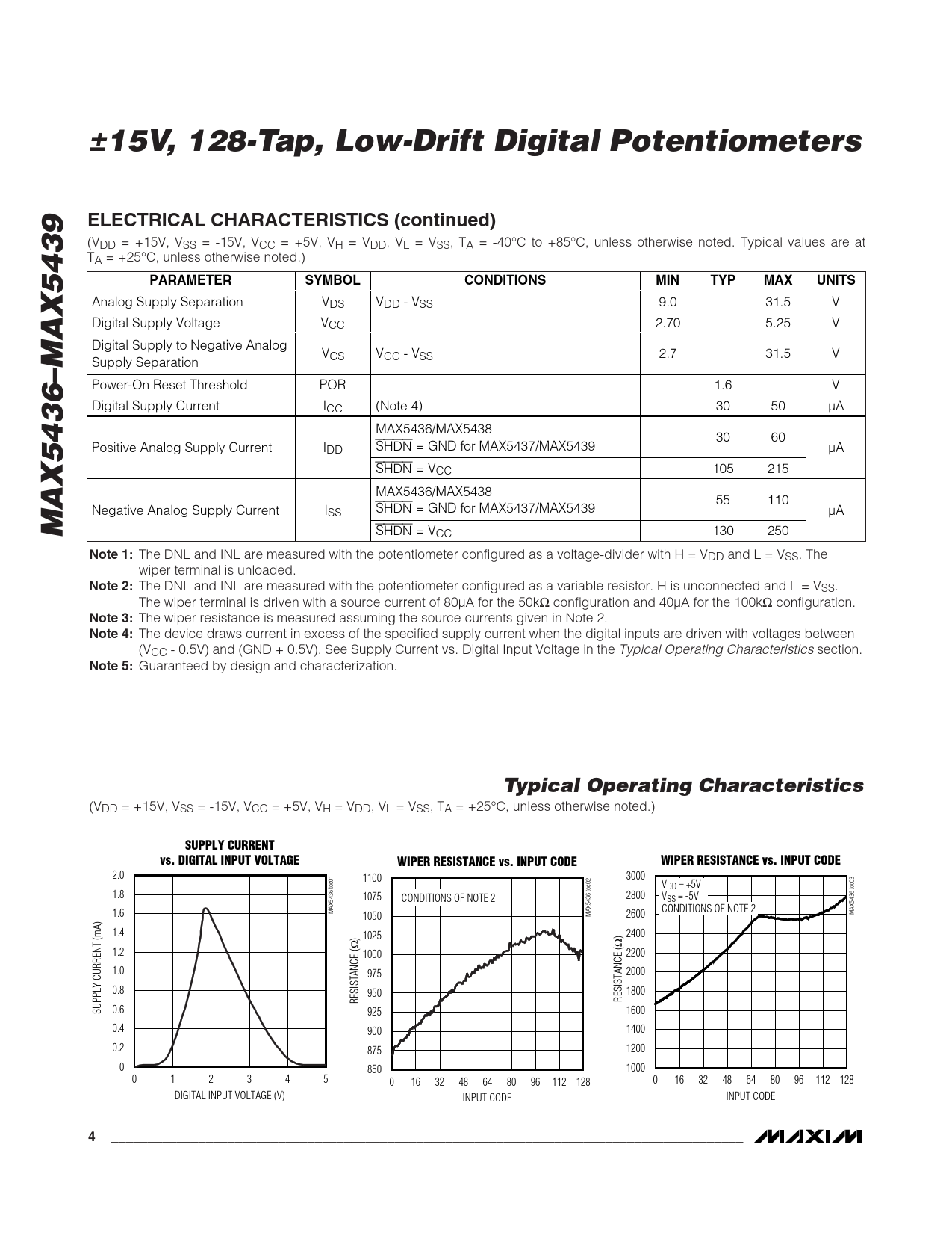

±15V, 128-Tap, Low-Drift Digital Potentiometers. ELECTRICAL CHARACTERISTICS (continued). PARAMETER. SYMBOL. CONDITIONS. MIN. TYP. MAX
±15V, 128-Tap, Low-Drift Digital Potentiometers ELECTRICAL CHARACTERISTICS (continued) PARAMETER SYMBOL CONDITIONS MIN TYP MAX
(VDD = +15V, VSS = -15V, VCC = +5V, VH = VDD, VL = VSS, TA = -40°C to +85°C, unless otherwise noted. Typical values are at TA = +25°C, unless otherwise noted.)
PARAMETER SYMBOL CONDITIONS MIN TYP MAX UNITS
Analog Supply Separation VDS VDD - VSS 9.0 31.5 V Digital Supply Voltage VCC 2.70 5.25 V Digital Supply to Negative Analog VCS VCC - VSS 2.7 31.5 V Supply Separation Power-On Reset Threshold POR 1.6 V Digital Supply Current ICC (Note 4) 30 50 µA MAX5436/MAX5438 30 60 Positive Analog Supply Current I SHDN = GND for MAX5437/MAX5439 DD µA SHDN = VCC 105 215 MAX5436/MAX5438 55 110 Negative Analog Supply Current I SHDN = GND for MAX5437/MAX5439 SS µA
MAX5436–MAX5439
SHDN = VCC 130 250
Note 1:
The DNL and INL are measured with the potentiometer configured as a voltage-divider with H = VDD and L = VSS. The wiper terminal is unloaded.
Note 2:
The DNL and INL are measured with the potentiometer configured as a variable resistor. H is unconnected and L = VSS. The wiper terminal is driven with a source current of 80µA for the 50kΩ configuration and 40µA for the 100kΩ configuration.
Note 3:
The wiper resistance is measured assuming the source currents given in Note 2.
Note 4:
The device draws current in excess of the specified supply current when the digital inputs are driven with voltages between (VCC - 0.5V) and (GND + 0.5V). See Supply Current vs. Digital Input Voltage in the Typical Operating Characteristics section.
Note 5:
Guaranteed by design and characterization.
(VDD = +15V, VSS = -15V, VCC = +5V, VH = VDD, VL = VSS, TA = +25°C, unless otherwise noted.)
SUPPLY CURRENT vs. DIGITAL INPUT VOLTAGE WIPER RESISTANCE vs. INPUT CODE WIPER RESISTANCE vs. INPUT CODE
2.0 1100 3000 VDD = +5V 1.8 1075 CONDITIONS OF NOTE 2 2800 VSS = -5V MAX5436 toc01 1.6 CONDITIONS OF NOTE 2 MAX5436 toc02 1050 MAX5436 toc03 2600 1.4 ) 1025 ) 2400 Ω Ω 1.2 1000 2200 1.0 975 2000 0.8 950 1800 RESISTANCE ( RESISTANCE ( SUPPLY CURRENT (mA) 0.6 925 1600 0.4 900 1400 0.2 875 1200 0 850 1000 0 1 2 3 4 5 0 16 32 48 64 80 96 112 128 0 16 32 48 64 80 96 112 128 DIGITAL INPUT VOLTAGE (V) INPUT CODE INPUT CODE
