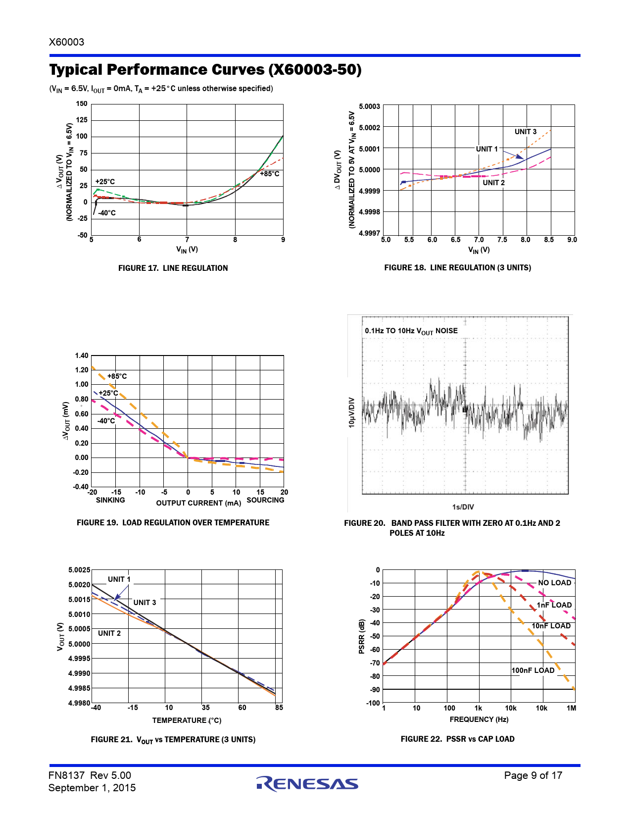

X60003 Typical Performance Curves (X60003-50) (VIN = 6.5V, IOUT = 0mA, TA = +25°C unless otherwise specified)
150 5.0003 V ) 125 = 6.5 5.0002 UNIT 3 6.5V 100 IN = V T IN ) 5.0001 75 UNIT 1 A (V (V) O V T T 50 OU O 5V +85°C 5.0000 OU V +25°C
V 25 UNIT 2
D 4.9999 ILIZED T 0 A M -40°C R 4.9998 (NORMAILIZED T -25 O (N -50 4.9997 5 6 7 8 9 5.0 5.5 6.0 6.5 7.0 7.5 8.0 8.5 9.0 VIN (V) VIN (V)
FIGURE 17. LINE REGULATION FIGURE 18. LINE REGULATION (3 UNITS)
0.1Hz TO 10Hz VOUT NOISE 1.40 1.20 +85°C 1.00 +25°C 0.80 IV mV) /D 0.60 ( V -40°C µ 10 OUT 0.40
V 0.20 0.00 -0.20 -0.40-20 -15 -10 -5 0 5 10 15 20 SINKING OUTPUT CURRENT (mA) S O URC ING 1s/DIV
FIGURE 19. LOAD REGULATION OVER TEMPERATURE FIGURE 20. BAND PASS FILTER WITH ZERO AT 0.1Hz AND 2 POLES AT 10Hz
5.0025 0 UNIT 1 5.0020 -10 NO LOAD 5.0015 -20 UNIT 3 1nF LOAD -30 5.0010 ) V -40 5.0005 10nF LOAD ( dB) ( T UNIT 2 -50 OU 5.0000 RR V PS -60 4.9995 -70 4.9990 100nF LOAD -80 4.9985 -90 4.9980 -100 -40 -15 10 35 60 85 1 10 100 1k 10k 10k 1M TEMPERATURE (°C) FREQUENCY (Hz)
FIGURE 21. VOUT vs TEMPERATURE (3 UNITS) FIGURE 22. PSSR vs CAP LOAD FN8137 Rev 5.00 Page 9 of 17 September 1, 2015
