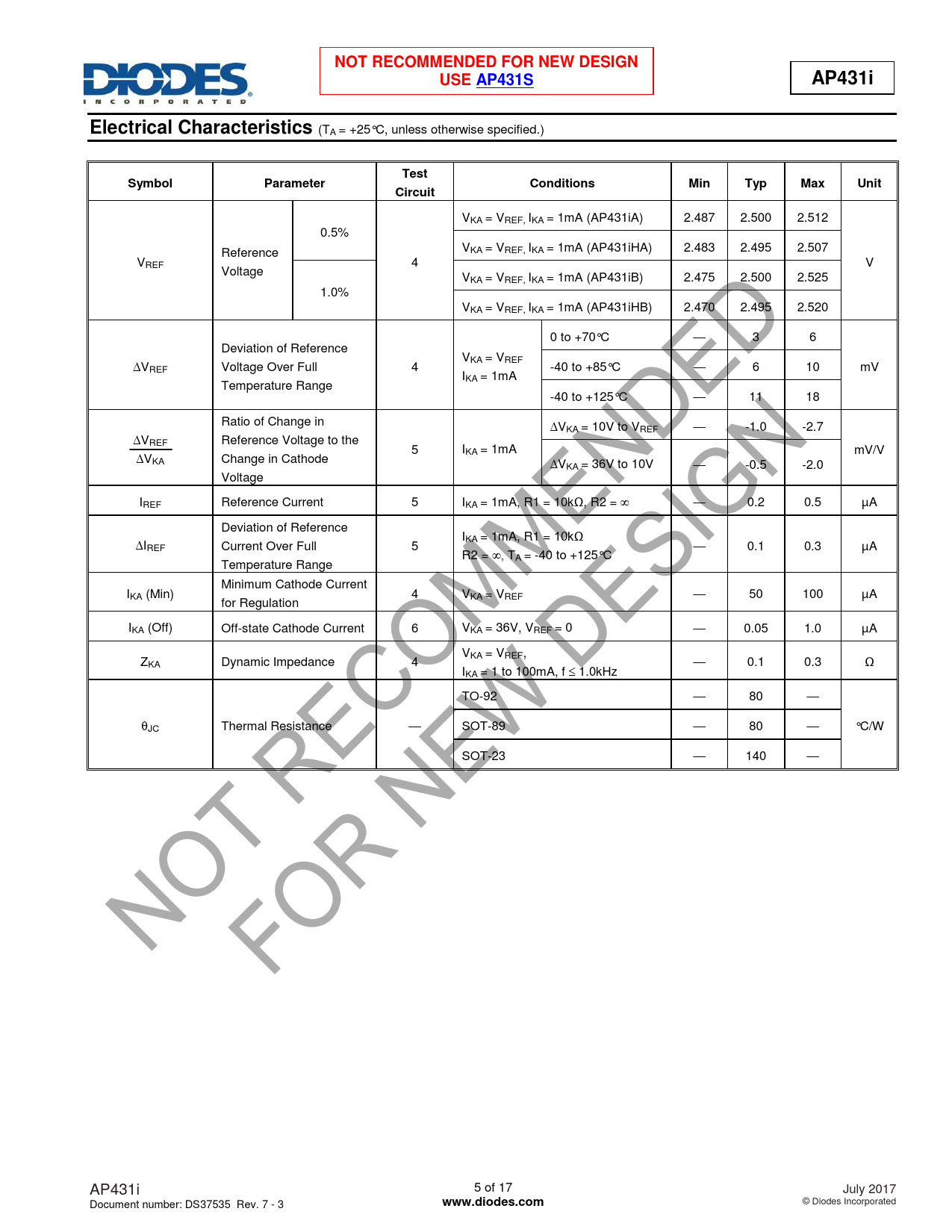

NOT RECOMMENDED FOR NEW DESIGN. USE AP431S. AP431i. Electrical Characteristics. Test. Symbol. Parameter. Conditions. Min. Typ. Max. Unit
NOT RECOMMENDED FOR NEW DESIGN USE AP431S AP431i Electrical Characteristics Test Symbol Parameter Conditions Min Typ Max Unit
(TA = +25°C, unless otherwise specified.)
Test Symbol Parameter Conditions Min Typ Max Unit Circuit
VKA = VREF, IKA = 1mA (AP431iA) 2.487 2.500 2.512 0.5% V Reference KA = VREF, IKA = 1mA (AP431iHA) 2.483 2.495 2.507 VREF 4 V Voltage VKA = VREF, IKA = 1mA (AP431iB) 2.475 2.500 2.525 1.0% VKA = VREF, IKA = 1mA (AP431iHB) 2.470 2.495 2.520 0 to +70°C — 3 6 Deviation of Reference  VKA = VREF VREF Voltage Over Full 4 -40 to +85°C — 6 10 mV IKA = 1mA Temperature Range -40 to +125°C — 11 18 Ratio of Change in VKA = 10V to VREF — -1.0 -2.7 VREF Reference Voltage to the  5 IKA = 1mA mV/V VKA Change in Cathode VKA = 36V to 10V — -0.5 -2.0 Voltage IREF Reference Current 5 IKA = 1mA, R1 = 10kΩ, R2 =  — 0.2 0.5 µA Deviation of Reference  IKA = 1mA, R1 = 10kΩ IREF Current Over Full 5 — 0.1 0.3 µA R2 =  TA = -40 to +125°C Temperature Range Minimum Cathode Current IKA (Min) 4 VKA = VREF — 50 100 µA for Regulation IKA (Off) Off-state Cathode Current 6 VKA = 36V, VREF = 0 — 0.05 1.0 µA VKA = VREF, ZKA Dynamic Impedance 4 — 0.1 0.3 Ω IKA = 1 to 100mA, f 1.0kHz TO-92 — 80 — JC Thermal Resistance — SOT-89 — 80 — °C/W SOT-23 — 140 — AP431i 5 of 17 July 2017 Document number: DS37535 Rev. 7 - 3
