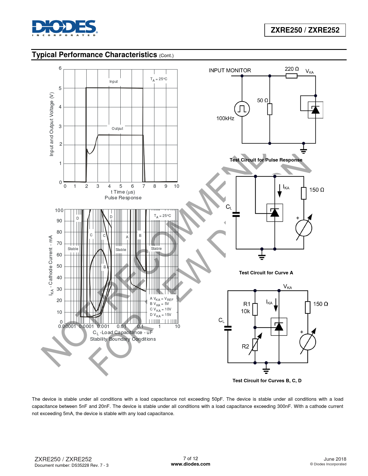

ZXRE250 / ZXRE252. Typical Performance Characteristics. Test Circuit for Pulse Response. Test Circuit for Curve A
ZXRE250 / ZXRE252 Typical Performance Characteristics Test Circuit for Pulse Response Test Circuit for Curve A
(Cont.) 6 T = 25 C ° Input A 5 ) (V 4 tage ol t V pu 3 ut O ut put d O an 2 ut Inp
1 0 0 1 2 3 4 5 6 7 8 9 10 t Time ( s µ ) Pulse Response 100 D T = 25 C ° D A 90 80 A C C B A m 70 - Stable Stable Stable rent 60 ur e C 50 B
hod 40 at - C 30 I KA 20 A V = V KA REF B V = 5V KA C V = 10V 10 KA D V = 15V KA 0 0.00001 0.0001 0.001 0.01 0.1 1 10 C -Load Capacitance - uF L Stability Boundary Conditions
Test Circuit for Curves B, C, D
The device is stable under all conditions with a load capacitance not exceeding 50pF. The device is stable under all conditions with a load capacitance between 5nF and 20nF. The device is stable under all conditions with a load capacitance exceeding 300nF. With a cathode current not exceeding 5mA, the device is stable with any load capacitance. ZXRE250 / ZXRE252 7 of 12 June 2018 Document number: DS35228 Rev. 7 - 3
