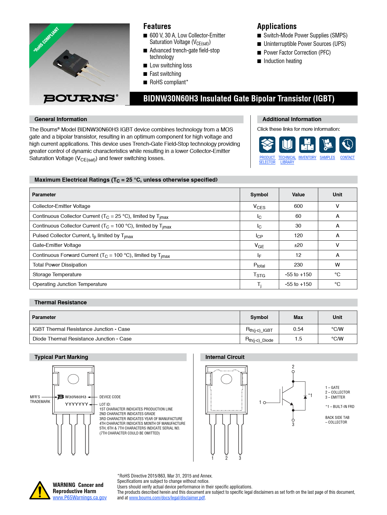

Features. Applications. BIDNW30N60H3 Insulated Gate Bipolar Transistor (IGBT). General Information. Additional Information
Datasheet BIDNW30N60H3 Bourns
Features Applications
n 600 V, 30 A, Low Collector-Emitter n Switch-Mode Power Supplies (SMPS) Saturation Voltage (VCE(sat)) n Uninterruptible Power Sources (UPS) n Advanced trench-gate field-stop n Power Factor Correction (PFC) technology n Induction heating n Low switching loss n Fast switching n RoHS compliant*
BIDNW30N60H3 Insulated Gate Bipolar Transistor (IGBT) General Information Additional Information
The Bourns® Model BIDNW30N60H3 IGBT device combines technology from a MOS Click these links for more information: gate and a bipolar transistor, resulting in an optimum component for high voltage and high current applications. This device uses Trench-Gate Field-Stop technology providing greater control of dynamic characteristics while resulting in a lower Collector-Emitter PRODUCT TECHNICAL INVENTORY SAMPLES CONTACT Saturation Voltage (VCE(sat)) and fewer switching losses. SELECTOR LIBRARY
Maximum Electrical Ratings (TC = 25 °C, unless otherwise specified) Parameter Symbol Value Unit
Collector-Emitter Voltage VCES 600 V Continuous Collector Current (TC = 25 °C), limited by Tjmax IC 60 A Continuous Collector Current (TC = 100 °C), limited by Tjmax IC 30 A Pulsed Collector Current, tp limited by Tjmax ICP 120 A Gate-Emitter Voltage VGE ±20 V Continuous Forward Current (TC = 100 °C), limited by Tjmax IF 12 A Total Power Dissipation Ptotal 230 W Storage Temperature TSTG -55 to +150 °C Operating Junction Temperature Tj -55 to +150 °C
Thermal Resistance Parameter Symbol Max Unit
IGBT Thermal Resistance Junction - Case Rth(j-c)_IGBT 0.54 °C/W Diode Thermal Resistance Junction - Case Rth(j-c)_Diode 1.5 °C/W
Typical Part Marking Internal Circuit
2 1 – GATE 2 – COLLECTOR MFR’S W30N60H3 DEVICE CODE *1 3 – EMITTER TRADEMARK YYYYYYY LOT ID: 1 *1 – BUILT-IN FRD 1ST CHARACTER INDICATES PRODUCTION LINE 2ND CHARACTER INDICATES GRADE 3RD CHARACTER INDICATES YEAR OF MANUFACTURE BACK SIDE TAB 4TH CHARACTER INDICATES MONTH OF MANUFACTURE – COLLECTOR 3 5TH, 6TH & 7TH CHARACTERS INDICATE SERIAL NO. (7TH CHARACTER COULD BE OMITTED) 1 2 3 *RoHS Directive 2015/863, Mar 31, 2015 and Annex. Specifications are subject to change without notice.
