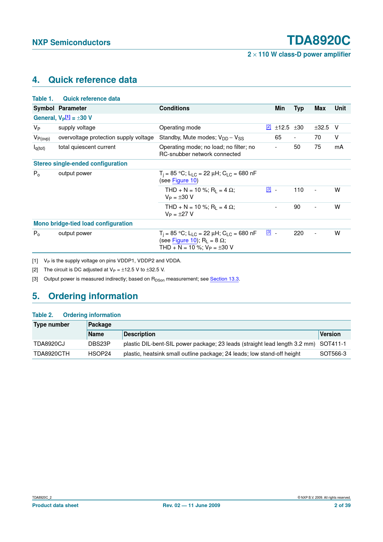

NXP Semiconductors. TDA8920C. 110 W class-D power amplifier. Quick reference data. Table 1. Symbol Parameter. Conditions. Min. Typ. Max
NXP Semiconductors TDA8920C 110 W class-D power amplifier Quick reference data Table 1 Symbol Parameter Conditions Min Typ Max
link to page 2 link to page 2 link to page 22 link to page 2 link to page 22 link to page 2 link to page 17
NXP Semiconductors TDA8920C 2
110 W class-D power amplifier 4. Quick reference data Table 1. Quick reference data Symbol Parameter Conditions Min Typ Max Unit General, V [1] P =
30 V
VP supply voltage Operating mode [2] ±12.5 ±30 ±32.5 V V − P(ovp) overvoltage protection supply voltage Standby, Mute modes; VDD VSS 65 - 70 V Iq(tot) total quiescent current Operating mode; no load; no filter; no - 50 75 mA RC-snubber network connected
Stereo single-ended configuration
Po output power Tj = 85 °C; LLC = 22 µH; CLC = 680 nF (see Figure 10) THD + N = 10 %; R [3] L = 4 Ω; - 110 - W VP = ±30 V THD + N = 10 %; RL = 4 Ω; - 90 - W VP = ±27 V
Mono bridge-tied load configuration
P [3] o output power Tj = 85 °C; LLC = 22 µH; CLC = 680 nF - 220 - W (see Figure 10); RL = 8 Ω; THD + N = 10 %; VP = ±30 V [1] VP is the supply voltage on pins VDDP1, VDDP2 and VDDA. [2] The circuit is DC adjusted at VP = ±12.5 V to ±32.5 V. [3] Output power is measured indirectly; based on RDSon measurement; see Section 13.3.
5. Ordering information Table 2. Ordering information Type number Package Name Description Version
TDA8920CJ DBS23P plastic DIL-bent-SIL power package; 23 leads (straight lead length 3.2 mm) SOT411-1 TDA8920CTH HSOP24 plastic, heatsink small outline package; 24 leads; low stand-off height SOT566-3 TDA8920C_2 © NXP B.V. 2009. All rights reserved.
Product data sheet Rev. 02 — 11 June 2009 2 of 39
