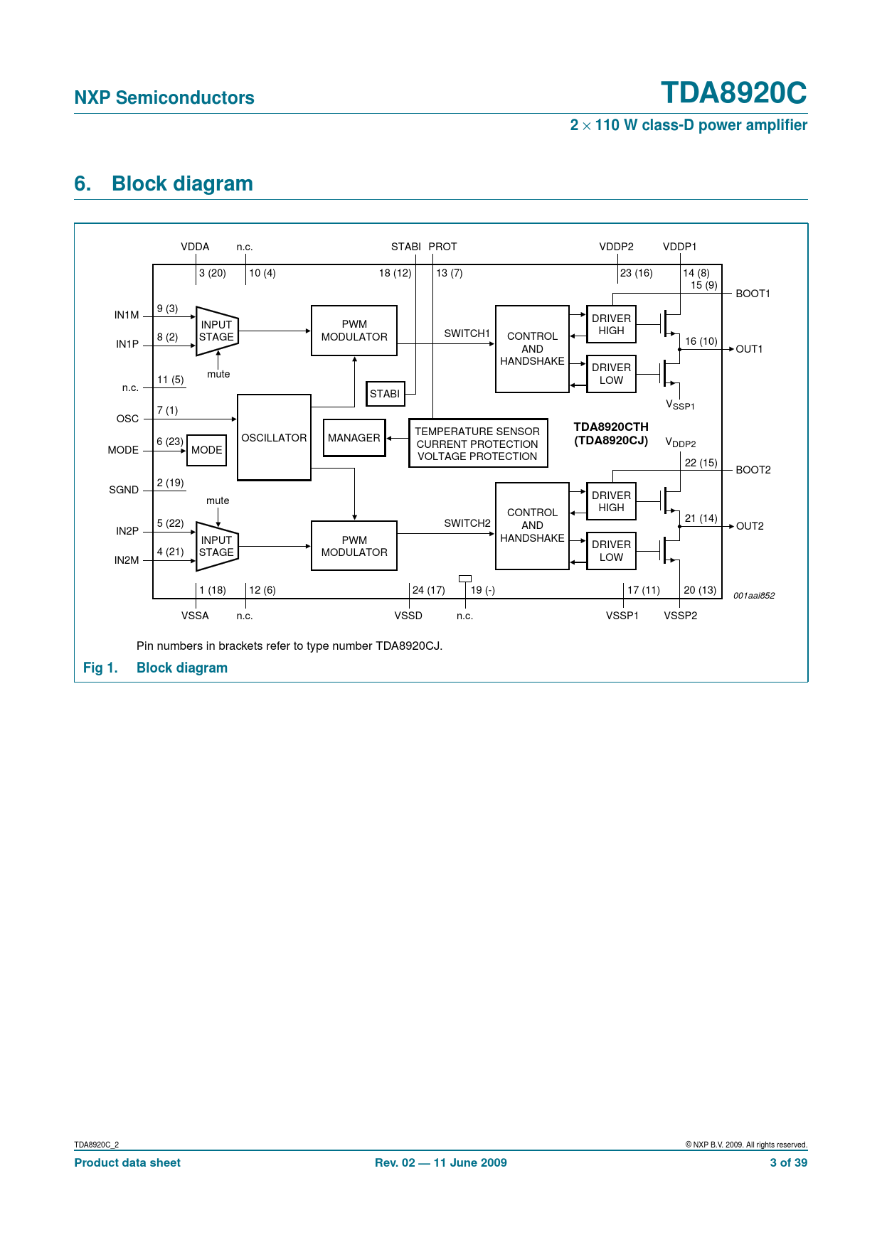

NXP Semiconductors. TDA8920C. 110 W class-D power amplifier. Block diagram. TDA8920CTH. (TDA8920CJ). Fig 1. Product data sheet
NXP Semiconductors TDA8920C 110 W class-D power amplifier Block diagram TDA8920CTH (TDA8920CJ) Fig 1 Product data sheet
NXP Semiconductors TDA8920C 2
110 W class-D power amplifier 6. Block diagram
VDDA n.c. STABI PROT VDDP2 VDDP1 3 (20) 10 (4) 18 (12) 13 (7) 23 (16) 14 (8) 15 (9) BOOT1 9 (3) IN1M DRIVER INPUT PWM HIGH SWITCH1 8 (2) STAGE MODULATOR CONTROL IN1P 16 (10) AND OUT1 HANDSHAKE DRIVER mute 11 (5) LOW n.c. STABI VSSP1 7 (1) OSC
TDA8920CTH
TEMPERATURE SENSOR OSCILLATOR MANAGER 6 (23)
(TDA8920CJ)
V CURRENT PROTECTION DDP2 MODE MODE VOLTAGE PROTECTION 22 (15) BOOT2 2 (19) SGND DRIVER mute HIGH CONTROL 21 (14) 5 (22) SWITCH2 AND OUT2 IN2P HANDSHAKE INPUT PWM DRIVER 4 (21) STAGE MODULATOR LOW IN2M 1 (18) 12 (6) 24 (17) 19 (-) 17 (11) 20 (13) 001aai852 VSSA n.c. VSSD n.c. VSSP1 VSSP2 Pin numbers in brackets refer to type number TDA8920CJ.
Fig 1. Block diagram
