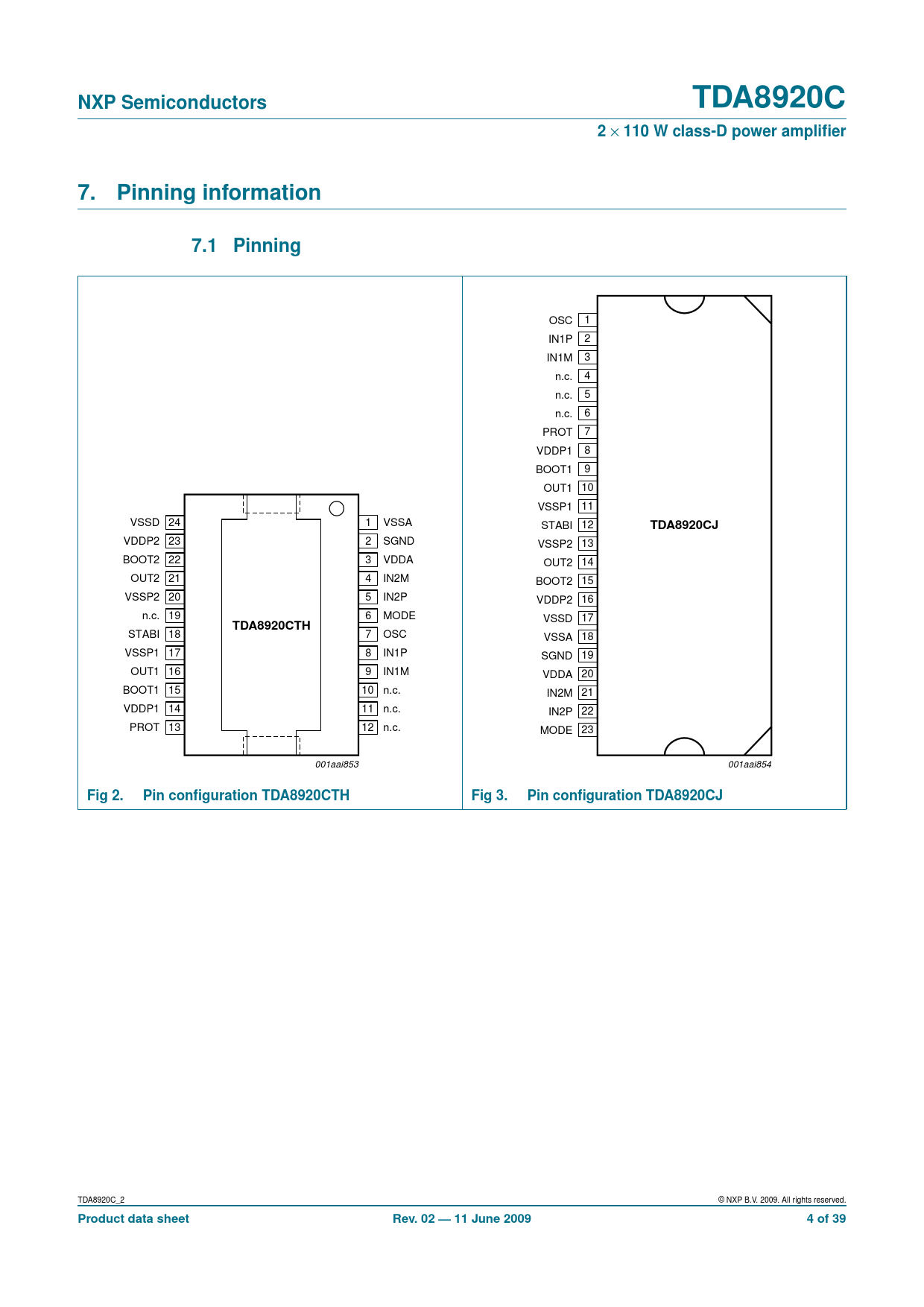

NXP Semiconductors. TDA8920C. 110 W class-D power amplifier. Pinning information. 7.1 Pinning. TDA8920CJ. TDA8920CTH. Fig 2
NXP Semiconductors TDA8920C 110 W class-D power amplifier Pinning information 7.1 Pinning TDA8920CJ TDA8920CTH Fig 2
NXP Semiconductors TDA8920C 2
110 W class-D power amplifier 7. Pinning information 7.1 Pinning
OSC 1 IN1P 2 IN1M 3 n.c. 4 n.c. 5 n.c. 6 PROT 7 VDDP1 8 BOOT1 9 OUT1 10 VSSP1 11 VSSD 24 1 VSSA STABI 12
TDA8920CJ
VDDP2 23 2 SGND VSSP2 13 BOOT2 22 3 VDDA OUT2 14 OUT2 21 4 IN2M BOOT2 15 VSSP2 20 5 IN2P VDDP2 16 n.c. 19 6 MODE VSSD 17
TDA8920CTH
STABI 18 7 OSC VSSA 18 VSSP1 17 8 IN1P SGND 19 OUT1 16 9 IN1M VDDA 20 BOOT1 15 10 n.c. IN2M 21 VDDP1 14 11 n.c. IN2P 22 PROT 13 12 n.c. MODE 23 001aai853 001aai854
Fig 2. Pin configuration TDA8920CTH Fig 3. Pin configuration TDA8920CJ
