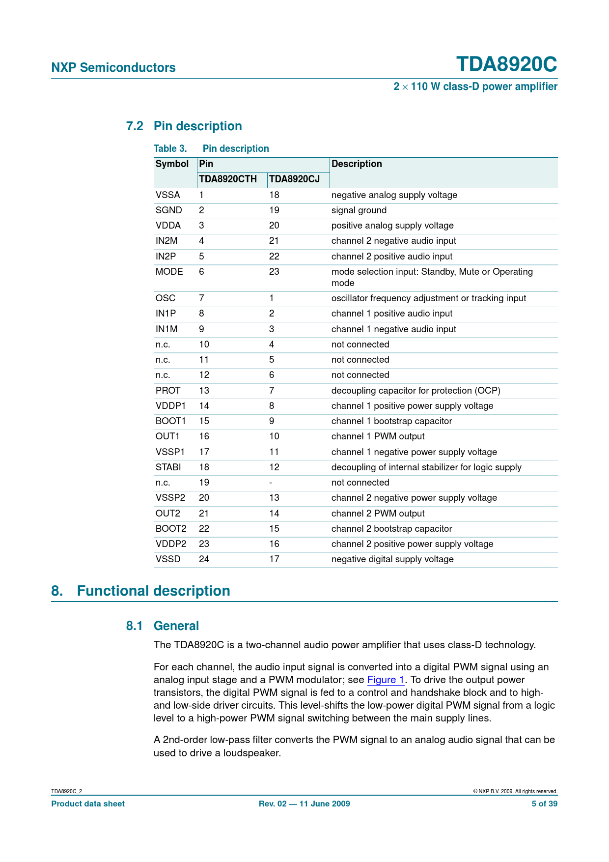

NXP Semiconductors. TDA8920C. 110 W class-D power amplifier. 7.2 Pin description. Table 3. Pin description. Symbol. Pin. Description
NXP Semiconductors TDA8920C 110 W class-D power amplifier 7.2 Pin description Table 3 Pin description Symbol Pin Description
link to page 3
NXP Semiconductors TDA8920C 2
110 W class-D power amplifier 7.2 Pin description Table 3. Pin description Symbol Pin Description TDA8920CTH TDA8920CJ
VSSA 1 18 negative analog supply voltage SGND 2 19 signal ground VDDA 3 20 positive analog supply voltage IN2M 4 21 channel 2 negative audio input IN2P 5 22 channel 2 positive audio input MODE 6 23 mode selection input: Standby, Mute or Operating mode OSC 7 1 oscillator frequency adjustment or tracking input IN1P 8 2 channel 1 positive audio input IN1M 9 3 channel 1 negative audio input n.c. 10 4 not connected n.c. 11 5 not connected n.c. 12 6 not connected PROT 13 7 decoupling capacitor for protection (OCP) VDDP1 14 8 channel 1 positive power supply voltage BOOT1 15 9 channel 1 bootstrap capacitor OUT1 16 10 channel 1 PWM output VSSP1 17 11 channel 1 negative power supply voltage STABI 18 12 decoupling of internal stabilizer for logic supply n.c. 19 - not connected VSSP2 20 13 channel 2 negative power supply voltage OUT2 21 14 channel 2 PWM output BOOT2 22 15 channel 2 bootstrap capacitor VDDP2 23 16 channel 2 positive power supply voltage VSSD 24 17 negative digital supply voltage
8. Functional description 8.1 General
The TDA8920C is a two-channel audio power amplifier that uses class-D technology. For each channel, the audio input signal is converted into a digital PWM signal using an analog input stage and a PWM modulator; see Figure 1. To drive the output power transistors, the digital PWM signal is fed to a control and handshake block and to high- and low-side driver circuits. This level-shifts the low-power digital PWM signal from a logic level to a high-power PWM signal switching between the main supply lines. A 2nd-order low-pass filter converts the PWM signal to an analog audio signal that can be used to drive a loudspeaker. TDA8920C_2 © NXP B.V. 2009. All rights reserved.
