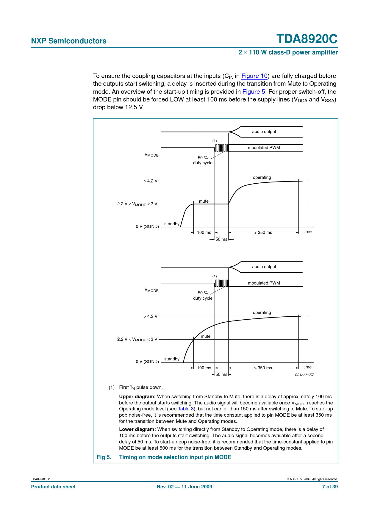

To ensure the coupling capacitors at the inputs (CIN in Figure 10) are fully charged before the outputs start switching, a delay is inserted during the transition from Mute to Operating mode. An overview of the start-up timing is provided in Figure 5. For proper switch-off, the MODE pin should be forced LOW at least 100 ms before the supply lines (VDDA and VSSA) drop below 12.5 V. audio output (1) modulated PWM VMODE 50 % duty cycle operating > 4.2 V mute 2.2 V < VMODE < 3 V standby 0 V (SGND) time 100 ms > 350 ms 50 ms audio output (1) modulated PWM VMODE 50 % duty cycle operating > 4.2 V mute 2.2 V < VMODE < 3 V standby 0 V (SGND) time 100 ms > 350 ms 50 ms 001aah657 (1) First 1⁄4 pulse down.
Upper diagram:
When switching from Standby to Mute, there is a delay of approximately 100 ms before the output starts switching. The audio signal will become available once VMODE reaches the Operating mode level (see Table 8), but not earlier than 150 ms after switching to Mute. To start-up pop noise-free, it is recommended that the time constant applied to pin MODE be at least 350 ms for the transition between Mute and Operating modes.
Lower diagram:
When switching directly from Standby to Operating mode, there is a delay of 100 ms before the outputs start switching. The audio signal becomes available after a second delay of 50 ms. To start-up pop noise-free, it is recommended that the time-constant applied to pin MODE be at least 500 ms for the transition between Standby and Operating modes.
Fig 5. Timing on mode selection input pin MODE
