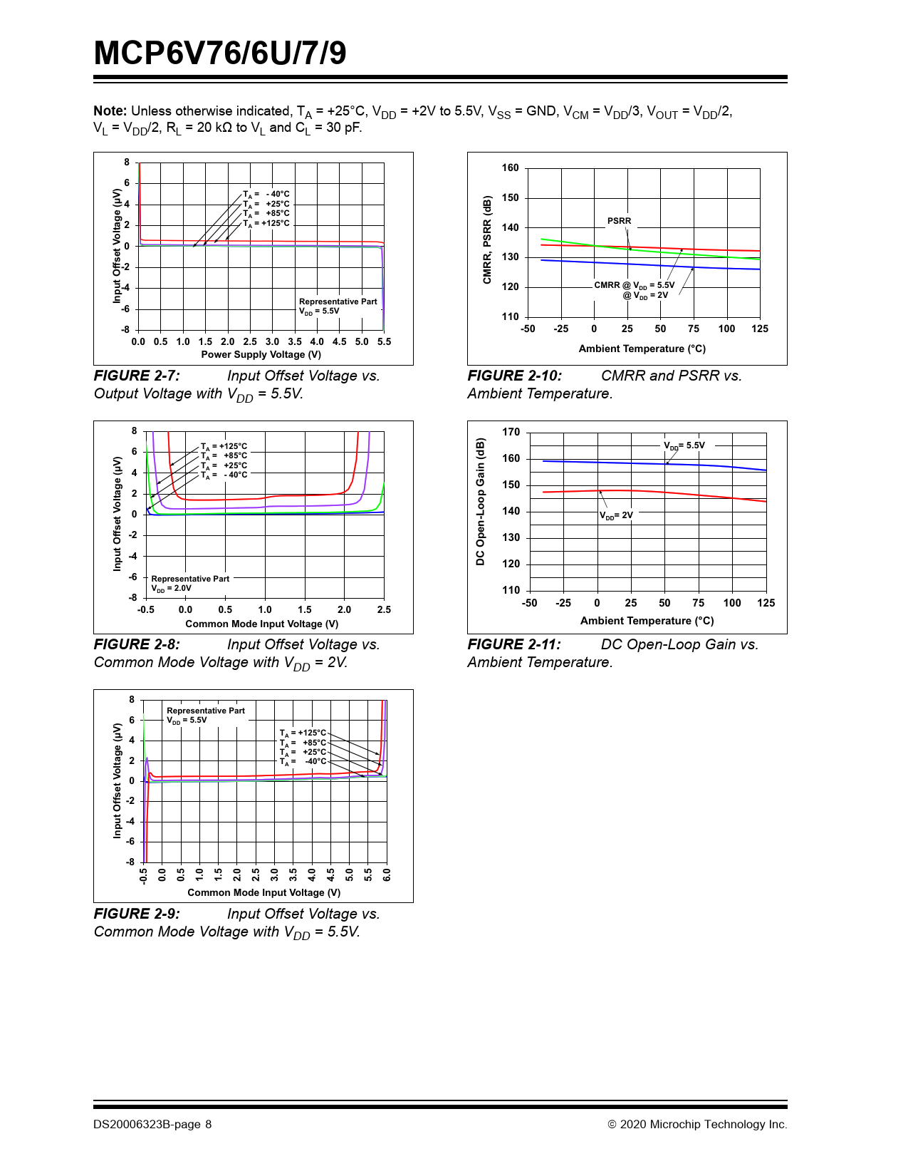

Pages / Page48 / 8 — MCP6V76/6U/7/9. Note:. 160. T = - 40°C. 150. (µV) 4. T = +25°C. T = …
MCP6V76/6U/7/9. Note:. 160. T = - 40°C. 150. (µV) 4. T = +25°C. T = +85°C. T = +125°C. PSRR. ltage. 140. 130. CMRR, PSRR (dB). 120. CMRR @ V. = 5.5V. @ V
MCP6V76/6U/7/9 Note: 160 T = - 40°C 150 (µV) 4 T = +25°C T = +85°C T = +125°C PSRR ltage 140 130 CMRR, PSRR (dB) 120 CMRR @ V = 5.5V @ V
Unless otherwise indicated, TA = +25°C, VDD = +2V to 5.5V, VSS = GND, VCM = VDD/3, VOUT = VDD/2, VL = VDD/2, RL = 20 kΩ to VL and CL = 30 pF.
8 160 6 T = - 40°C A 150 (µV) 4 T = +25°C A T = +85°C A 2 T = +125°C PSRR ltage A 140 o 0 130 -2 CMRR, PSRR (dB) -4 120 CMRR @ V = 5.5V DD @ V = 2V Input Offset V Representative Part DD -6 V = 5.5V DD 110 -8 -50 -25 0 25 50 75 100 125 0.0 0.5 1.0 1.5 2.0 2.5 3.0 3.5 4.0 4.5 5.0 5.5 Ambient Temperature (°C) Power Supply Voltage (V) FIGURE 2-7:
Input Offset Voltage vs.
FIGURE 2-10:
CMRR and PSRR vs. Output Voltage with VDD = 5.5V. Ambient Temperature.
8 170 T = +125°C V = 5.5V 6 A DD T = +85°C A 160 T = +25°C (µV) 4 A T = - 40°C A 150 2 ltage o 0 140 V = 2V DD -2 130 -4 DC Open-Loop Gain (dB) 120 Input Offset V -6 Representative Part V = 2.0V DD 110 -8 -50 -25 0 25 50 75 100 125 -0.5 0.0 0.5 1.0 1.5 2.0 2.5 Common Mode Input Voltage (V) Ambient Temperature (°C) FIGURE 2-8:
FIGURE 2-11:
DC Open-Loop Gain vs. Common Mode Voltage with VDD = 2V. Ambient Temperature.
8 Representative Part 6 V = 5.5V DD T = +125°C (µV) 4 A T = +85°C A T = +25°C A 2 ltage T = -40°C A o 0 -2 -4 Input Offset V -6 -8 -0.5 0.0 0.5 1.0 1.5 2.0 2.5 3.0 3.5 4.0 4.5 5.0 5.5 6.0 Common Mode Input Voltage (V) FIGURE 2-9:
