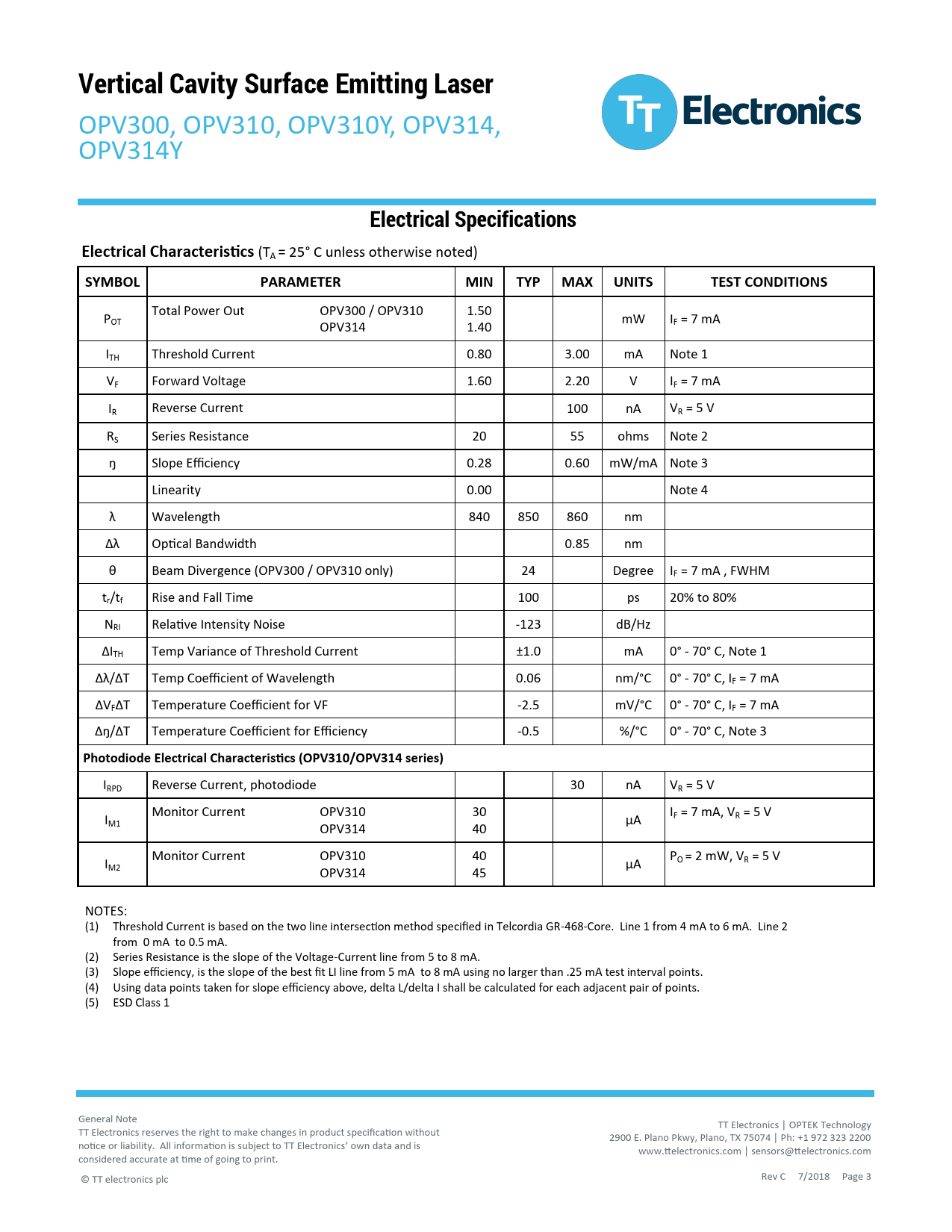

Vertical Cavity Surface Emitting Laser. Electrical Specifications. Electrical Characteristics. SYMBOL. PARAMETER. MIN. TYP. MAX. UNITS
Vertical Cavity Surface Emitting Laser Electrical Specifications Electrical Characteristics SYMBOL PARAMETER MIN TYP MAX UNITS
OPV300, OPV310, OPV310Y, OPV314, OPV314Y
(TA = 25° C unless otherwise noted)
SYMBOL PARAMETER MIN TYP MAX UNITS TEST CONDITIONS
Total Power Out OPV300 / OPV310 1.50 POT mW I OPV314 1.40 F = 7 mA ITH Threshold Current 0.80 3.00 mA Note 1 VF Forward Voltage 1.60 2.20 V IF = 7 mA IR Reverse Current 100 nA VR = 5 V RS Series Resistance 20 55 ohms Note 2 ŋ Slope Efficiency 0.28 0.60 mW/mA Note 3 Linearity 0.00 Note 4 λ Wavelength 840 850 860 nm ∆λ Optical Bandwidth 0.85 nm θ Beam Divergence (OPV300 / OPV310 only) 24 Degree IF = 7 mA , FWHM tr/tf Rise and Fall Time 100 ps 20% to 80% NRI Relative Intensity Noise -123 dB/Hz ∆ITH Temp Variance of Threshold Current ±1.0 mA 0° - 70° C, Note 1 ∆λ/∆T Temp Coefficient of Wavelength 0.06 nm/°C 0° - 70° C, IF = 7 mA ∆VF∆T Temperature Coefficient for VF -2.5 mV/°C 0° - 70° C, IF = 7 mA ∆ŋ/∆T Temperature Coefficient for Efficiency -0.5 %/°C 0° - 70° C, Note 3
Photodiode Electrical Characteristics (OPV310/OPV314 series)
IRPD Reverse Current, photodiode 30 nA VR = 5 V Monitor Current OPV310 30 I I F = 7 mA, VR = 5 V M1 µA OPV314 40 Monitor Current OPV310 40 P I O = 2 mW, VR = 5 V M2 µA OPV314 45 NOTES: (1) Threshold Current is based on the two line intersection method specified in Telcordia GR-468-Core. Line 1 from 4 mA to 6 mA. Line 2 from 0 mA to 0.5 mA. (2) Series Resistance is the slope of the Voltage-Current line from 5 to 8 mA. (3) Slope efficiency, is the slope of the best fit LI line from 5 mA to 8 mA using no larger than .25 mA test interval points. (4) Using data points taken for slope efficiency above, delta L/delta I shall be calculated for each adjacent pair of points. (5) ESD Class 1 General Note TT Electronics | OPTEK Technology TT Electronics reserves the right to make changes in product specification without 2900 E. Plano Pkwy, Plano, TX 75074 | Ph: +1 972 323 2200 notice or liability. All information is subject to TT Electronics’ own data and is www.ttelectronics.com | sensors@ttelectronics.com considered accurate at time of going to print. © TT electronics plc Rev C 7/2018 Page 3
