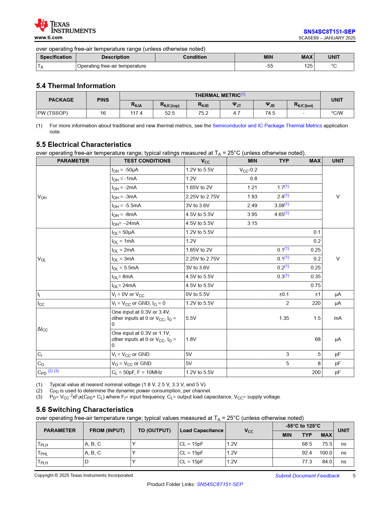

SN54SC8T151-SEP. www.ti.com. Specification. Description. Condition. MIN. MAX. UNIT. 5.4 Thermal Information. THERMAL METRIC. PACKAGE. PINS
SN54SC8T151-SEP www.ti.com Specification Description Condition MIN MAX UNIT 5.4 Thermal Information THERMAL METRIC PACKAGE PINS
link to page 5 link to page 5 link to page 5 link to page 5 link to page 5 link to page 5 link to page 5 link to page 5 link to page 5 link to page 5 link to page 5
SCASE69 – JANUARY 2025 over operating free-air temperature range (unless otherwise noted)
TA Operating free-air temperature -55 125 °C
(1)
PACKAGE PINS UNIT RθJA RθJC(top) RθJB ΨJT ΨJB RθJC(bot)
PW (TSSOP) 16 117.4 52.5 75.2 4.7 74.5 - °C/W (1) For more information about traditional and new thermal metrics, see the Semiconductor and IC Package Thermal Metrics application note.
5.5 Electrical Characteristics
over operating free-air temperature range; typical ratings measured at TA = 25°C (unless otherwise noted).
PARAMETER TEST CONDITIONS VCC MIN TYP MAX UNIT
IOH = -50μA 1.2V to 5.5V VCC-0.2 IOH = -1mA 1.2V 0.8 IOH = -2mA 1.65V to 2V 1.21 1.7(1) VOH IOH = -3mA 2.25V to 2.75V 1.93 2.4(1) V IOH = -5.5mA 3V to 3.6V 2.49 3.08(1) IOH = -8mA 4.5V to 5.5V 3.95 4.65(1) IOH= –24mA 4.5V to 5.5V 3.15 IOL= 50μA 1.2V to 5.5V 0.1 IOL = 1mA 1.2V 0.2 IOL = 2mA 1.65V to 2V 0.1(1) 0.25 VOL IOL = 3mA 2.25V to 2.75V 0.1(1) 0.2 V IOL = 5.5mA 3V to 3.6V 0.2(1) 0.25 IOL= 8mA 4.5V to 5.5V 0.3(1) 0.35 IOL= 24mA 4.5V to 5.5V 0.75 II VI = 0V or VCC 0V to 5.5V ±0.1 ±1 µA ICC VI = VCC or GND, IO = 0 1.2V to 5.5V 2 220 µA One input at 0.3V or 3.4V, other inputs at 0 or VCC, IO = 5.5V 1.35 1.5 mA 0 ΔICC One input at 0.3V or 1.1V, other inputs at 0 or VCC, IO = 1.8V 68 µA 0 CI VI = VCC or GND 5V 3 5 pF CO VO = VCC or GND 5V 5 8 pF CPD (2) (3) CL = 50pF, F = 10MHz 1.2V to 5.5V 200 pF (1) Typical value at nearest nominal voltage (1.8 V, 2.5 V, 3.3 V, and 5 V) (2) CPD is used to determine the dynamic power consumption, per channel. (3) PD= VCC 2xFIx(CPD+ CL) where FI= input frequency, CL= output load capacitance, VCC= supply voltage.
5.6 Switching Characteristics
over operating free-air temperature range; typical values measured at TA = 25°C (unless otherwise noted)
-55°C to 125°C PARAMETER FROM (INPUT) TO (OUTPUT) Load Capacitance VCC UNIT MIN TYP MAX
TPLH A, B, C Y CL = 15pF 1.2V 68.5 75.5 ns TPHL A, B, C Y CL = 15pF 1.2V 92.4 100.0 ns TPLH D Y CL = 15pF 1.2V 77.3 84.0 ns Copyright © 2025 Texas Instruments Incorporated Submit Document Feedback 5 Product Folder Links: SN54SC8T151-SEP Document Outline 1 Features 2 Applications 3 Description Table of Contents 4 Pin Configuration and Functions 5 Specifications 5.1 Absolute Maximum Ratings 5.2 ESD Ratings 5.3 Recommended Operating Conditions 5.4 Thermal Information 5.5 Electrical Characteristics 5.6 Switching Characteristics 5.7 Typical Characteristics 6 Parameter Measurement Information 7 Detailed Description 7.1 Overview 7.2 Functional Block Diagram 7.3 Feature Description 7.3.1 Balanced CMOS Push-Pull Outputs 7.3.2 SCxT Enhanced Input Voltage 7.3.2.1 Up Translation 7.3.2.2 Down Translation 7.3.3 Clamp Diode Structure 7.4 Device Functional Modes 8 Application and Implementation 8.1 Application Information 8.2 Typical Application 8.2.1 Design Requirements 8.2.1.1 Power Considerations 8.2.1.2 Input Considerations 8.2.1.3 Output Considerations 8.2.2 Detailed Design Procedure 8.2.3 Application Curve 8.3 Power Supply Recommendations 8.4 Layout 8.4.1 Layout Guidelines 8.4.2 Layout Example 9 Device and Documentation Support 9.1 Documentation Support 9.1.1 Related Documentation 9.2 Receiving Notification of Documentation Updates 9.3 Support Resources 9.4 Trademarks 9.5 Electrostatic Discharge Caution 9.6 Glossary 10 Revision History 11 Mechanical, Packaging, and Orderable Information
