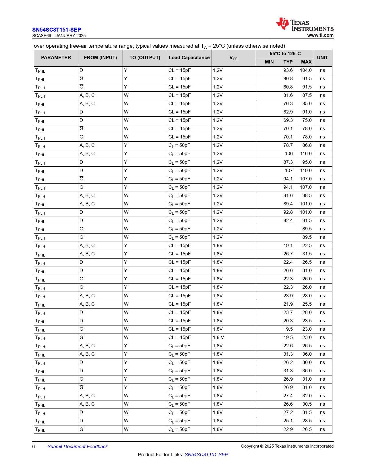

DescriptionRadiation-tolerant eight-line to one-line data selectors/multiplexers with logic-level shifter
Pages / Page30 / 6 — SN54SC8T151-SEP. www.ti.com. -55°C to 125°C. PARAMETER. FROM (INPUT). TO …
SN54SC8T151-SEP. www.ti.com. -55°C to 125°C. PARAMETER. FROM (INPUT). TO (OUTPUT). Load Capacitance. VCC. UNIT. MIN. TYP. MAX
SN54SC8T151-SEP www.ti.com -55°C to 125°C PARAMETER FROM (INPUT) TO (OUTPUT) Load Capacitance VCC UNIT MIN TYP MAX
SN54SC8T151-SEP
SCASE69 – JANUARY 2025
www.ti.com
over operating free-air temperature range; typical values measured at TA = 25°C (unless otherwise noted)
TPHL D Y CL = 15pF 1.2V 93.6 104.0 ns TPHL G Y CL = 15pF 1.2V 80.8 91.5 ns TPLH G Y CL = 15pF 1.2V 80.8 91.5 ns TPLH A, B, C W CL = 15pF 1.2V 81.6 87.5 ns TPHL A, B, C W CL = 15pF 1.2V 76.3 85.0 ns TPLH D W CL = 15pF 1.2V 82.9 91.0 ns TPHL D W CL = 15pF 1.2V 69.3 75.0 ns TPHL G W CL = 15pF 1.2V 70.1 78.0 ns TPLH G W CL = 15pF 1.2V 70.1 78.0 ns TPLH A, B, C Y CL = 50pF 1.2V 78.7 86.8 ns TPHL A, B, C Y CL = 50pF 1.2V 106 116.0 ns TPLH D Y CL = 50pF 1.2V 87.3 95.0 ns TPHL D Y CL = 50pF 1.2V 107 119.0 ns TPHL G Y CL = 50pF 1.2V 94.1 107.0 ns TPLH G Y CL = 50pF 1.2V 94.1 107.0 ns TPLH A, B, C W CL = 50pF 1.2V 91.6 98.5 ns TPHL A, B, C W CL = 50pF 1.2V 89.4 101.0 ns TPLH D W CL = 50pF 1.2V 92.8 101.0 ns TPHL D W CL = 50pF 1.2V 82.4 91.5 ns TPHL G W CL = 50pF 1.2V 89.5 ns TPLH G W CL = 50pF 1.2V 89.5 ns TPLH A, B, C Y CL = 15pF 1.8V 19.1 22.5 ns TPHL A, B, C Y CL = 15pF 1.8V 26.7 31.5 ns TPLH D Y CL = 15pF 1.8V 22.4 26.5 ns TPHL D Y CL = 15pF 1.8V 26.6 31.0 ns TPHL G Y CL = 15pF 1.8V 22.3 26.0 ns TPLH G Y CL = 15pF 1.8V 22.3 26.0 ns TPLH A, B, C W CL = 15pF 1.8V 23.9 28.0 ns TPHL A, B, C W CL = 15pF 1.8V 21.9 25.5 ns TPLH D W CL = 15pF 1.8V 23.7 28.0 ns TPHL D W CL = 15pF 1.8V 20.3 23.5 ns TPHL G W CL = 15pF 1.8V 19.5 23.0 ns TPLH G W CL = 15pF 1.8 V 19.5 23.0 ns TPLH A, B, C Y CL = 50pF 1.8V 22.6 26.5 ns TPHL A, B, C Y CL = 50pF 1.8V 31.3 36.0 ns TPLH D Y CL = 50pF 1.8V 26.2 30.0 ns TPHL D Y CL = 50pF 1.8V 31.3 36.0 ns TPHL G Y CL = 50pF 1.8V 26.9 31.0 ns TPLH G Y CL = 50pF 1.8V 26.9 31.0 ns TPLH A, B, C W CL = 50pF 1.8V 27.4 32.0 ns TPHL A, B, C W CL = 50pF 1.8V 26.6 30.5 ns TPLH D W CL = 50pF 1.8V 27.2 31.5 ns TPHL D W CL = 50pF 1.8V 25.1 28.5 ns TPHL G W CL = 50pF 1.8V 22.9 26.5 ns 6 Submit Document Feedback Copyright © 2025 Texas Instruments Incorporated Product Folder Links: SN54SC8T151-SEP Document Outline 1 Features 2 Applications 3 Description Table of Contents 4 Pin Configuration and Functions 5 Specifications 5.1 Absolute Maximum Ratings 5.2 ESD Ratings 5.3 Recommended Operating Conditions 5.4 Thermal Information 5.5 Electrical Characteristics 5.6 Switching Characteristics 5.7 Typical Characteristics 6 Parameter Measurement Information 7 Detailed Description 7.1 Overview 7.2 Functional Block Diagram 7.3 Feature Description 7.3.1 Balanced CMOS Push-Pull Outputs 7.3.2 SCxT Enhanced Input Voltage 7.3.2.1 Up Translation 7.3.2.2 Down Translation 7.3.3 Clamp Diode Structure 7.4 Device Functional Modes 8 Application and Implementation 8.1 Application Information 8.2 Typical Application 8.2.1 Design Requirements 8.2.1.1 Power Considerations 8.2.1.2 Input Considerations 8.2.1.3 Output Considerations 8.2.2 Detailed Design Procedure 8.2.3 Application Curve 8.3 Power Supply Recommendations 8.4 Layout 8.4.1 Layout Guidelines 8.4.2 Layout Example 9 Device and Documentation Support 9.1 Documentation Support 9.1.1 Related Documentation 9.2 Receiving Notification of Documentation Updates 9.3 Support Resources 9.4 Trademarks 9.5 Electrostatic Discharge Caution 9.6 Glossary 10 Revision History 11 Mechanical, Packaging, and Orderable Information
