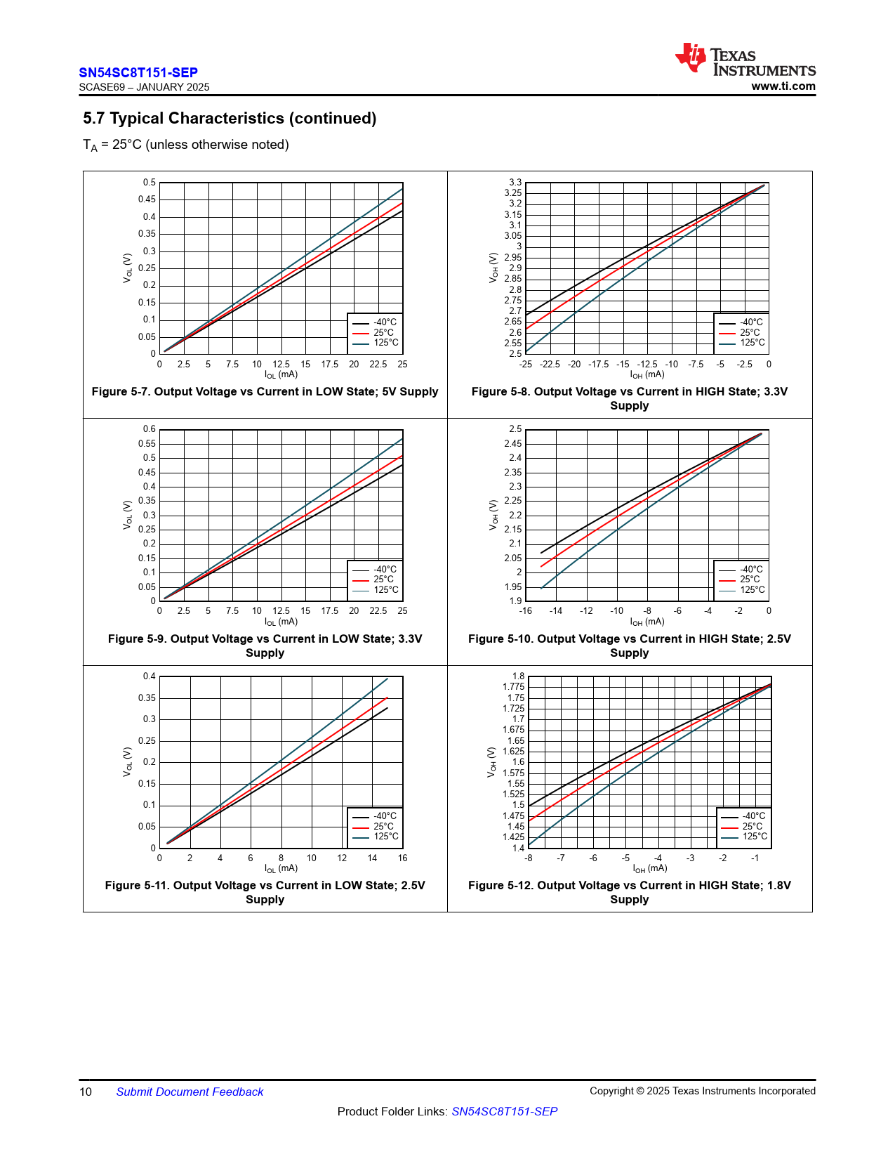

TA = 25°C (unless otherwise noted) 0.5 3.3 3.25 0.45 3.2 0.4 3.15 3.1 0.35 3.05 3 0.3 2.95 (V) 0.25 (V) 2.9 OL OH V V 2.85 0.2 2.8 0.15 2.75 2.7 0.1 -40°C 2.65 -40°C 25°C 2.6 25°C 0.05 125°C 2.55 125°C 0 2.5 0 2.5 5 7.5 10 12.5 15 17.5 20 22.5 25 -25 -22.5 -20 -17.5 -15 -12.5 -10 -7.5 -5 -2.5 0 IOL (mA) IOH (mA)
Figure 5-7. Output Voltage vs Current in LOW State; 5V Supply Figure 5-8. Output Voltage vs Current in HIGH State; 3.3V Supply
0.6 2.5 0.55 2.45 0.5 2.4 0.45 2.35 0.4 2.3 0.35 2.25 (V) 0.3 (V) 2.2 OL OH V 0.25 V 2.15 0.2 2.1 0.15 2.05 0.1 -40°C 2 -40°C 25°C 25°C 0.05 125°C 1.95 125°C 0 1.9 0 2.5 5 7.5 10 12.5 15 17.5 20 22.5 25 -16 -14 -12 -10 -8 -6 -4 -2 0 IOL (mA) IOH (mA)
Figure 5-9. Output Voltage vs Current in LOW State; 3.3V Figure 5-10. Output Voltage vs Current in HIGH State; 2.5V Supply Supply
0.4 1.8 1.775 0.35 1.75 1.725 0.3 1.7 1.675 0.25 1.65 1.625 (V) 0.2 (V) 1.6 OL OH V V 1.575 0.15 1.55 1.525 0.1 1.5 -40°C 1.475 -40°C 0.05 25°C 1.45 25°C 125°C 1.425 125°C 0 1.4 0 2 4 6 8 10 12 14 16 -8 -7 -6 -5 -4 -3 -2 -1 IOL (mA) IOH (mA)
Figure 5-11. Output Voltage vs Current in LOW State; 2.5V Figure 5-12. Output Voltage vs Current in HIGH State; 1.8V Supply Supply
