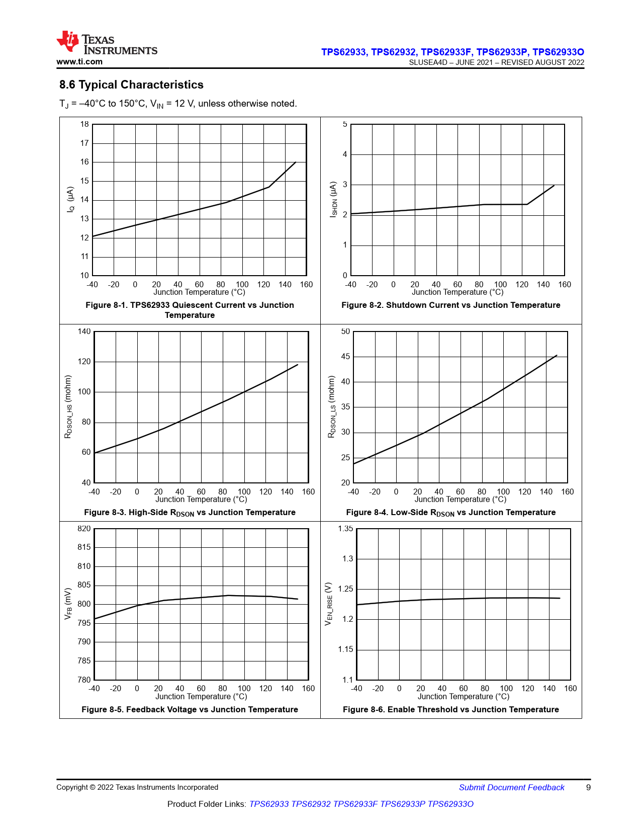

8.6 Typical Characteristics
TJ = –40°C to 150°C, VIN = 12 V, unless otherwise noted. 18 5 17 4 16 15 3 (µA) 14 (µA) I Q 2 13 I SHDN 12 1 11 10 0 -40 -20 0 20 40 60 80 100 120 140 160 -40 -20 0 20 40 60 80 100 120 140 160 Junction Temperature (°C) Junction Temperature (°C)
Figure 8-1. TPS62933 Quiescent Current vs Junction Figure 8-2. Shutdown Current vs Junction Temperature Temperature
140 50 45 120 ) 40 100 (mohm (mohm 35 80 DSON_HS DSON_LS 30 R R 60 25 40 20 -40 -20 0 20 40 60 80 100 120 140 160 -40 -20 0 20 40 60 80 100 120 140 160 Junction Temperature (°C) Junction Temperature (°C)
Figure 8-3. High-Side RDSON vs Junction Temperature Figure 8-4. Low-Side RDSON vs Junction Temperature
820 1.35 815 1.3 810 805 (V) 1.25 E (mV) 800 FBV EN_RIS 1.2 795 V 790 1.15 785 780 1.1 -40 -20 0 20 40 60 80 100 120 140 160 -40 -20 0 20 40 60 80 100 120 140 160 Junction Temperature (°C) Junction Temperature (°C)
Figure 8-5. Feedback Voltage vs Junction Temperature Figure 8-6. Enable Threshold vs Junction Temperature
