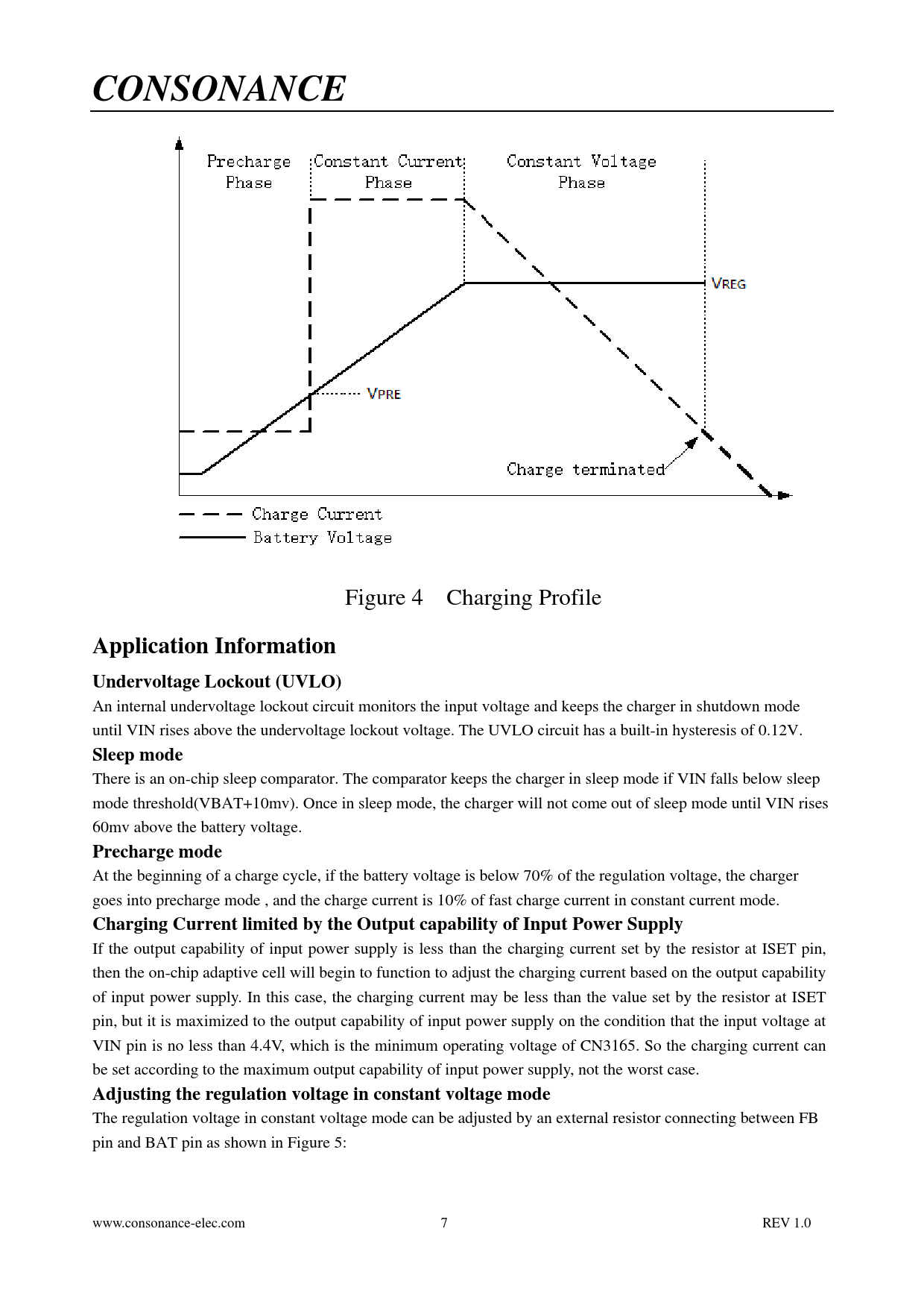

Figure 4 Charging Profile

Precharge mode
At the beginning of a charge cycle, if the battery voltage is below 70% of the regulation voltage, the charger goes into precharge mode , and the charge current is 10% of fast charge current in constant current mode.
