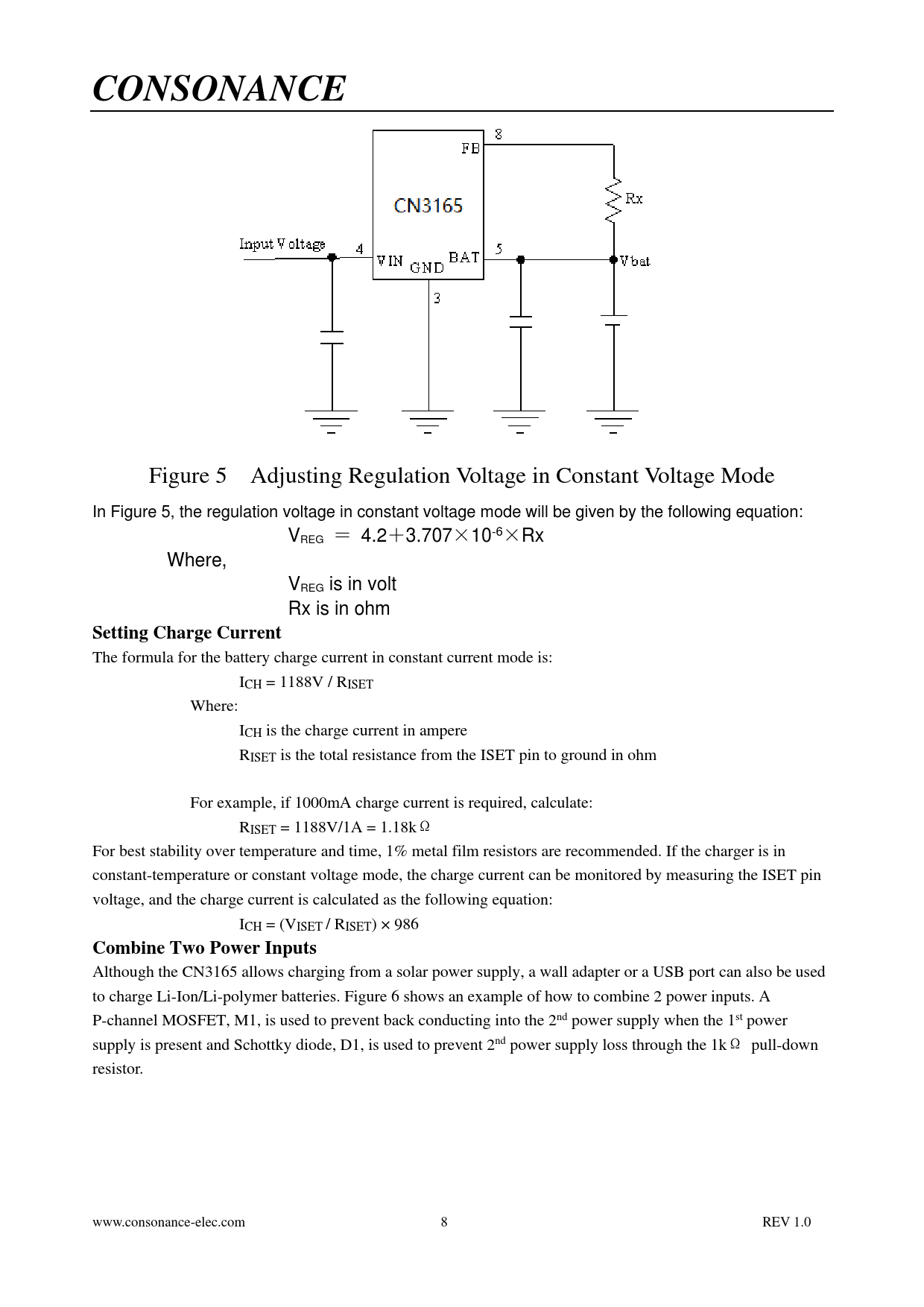

Figure 5 Adjusting Regulation Voltage in Constant Voltage Mode In Figure 5, the regulation voltage in constant voltage mode will be given by the following equation: VREG = 4.2+3.707×10-6×Rx Where, VREG is in volt Rx is in ohm
